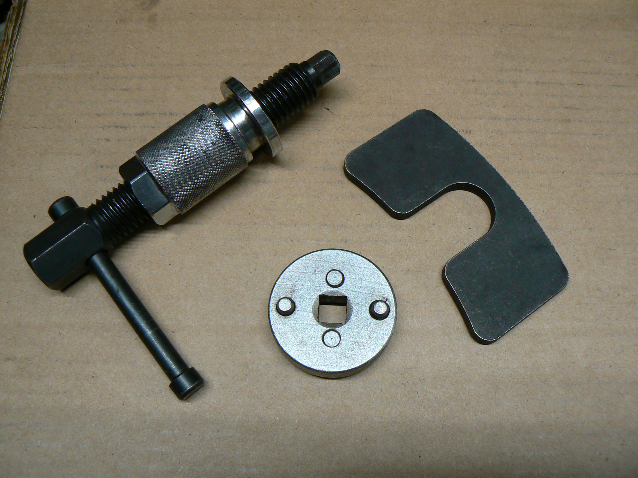

The 6mm pins will be too fat, and will be the wrong spacing.
The adjustable adaptor is available separately, Laser 5956.
With a quick search, best price seems to be here. https://www.thetoolacademy.com/laser-5956-brake-rewind-adaptor-38d---adjustable-2763-p.asp
There's a little allen screw in the centre, well hidden. You rotate teh two parts to adjust the pins, then lock it with the screw. Very clever, hence its cost.

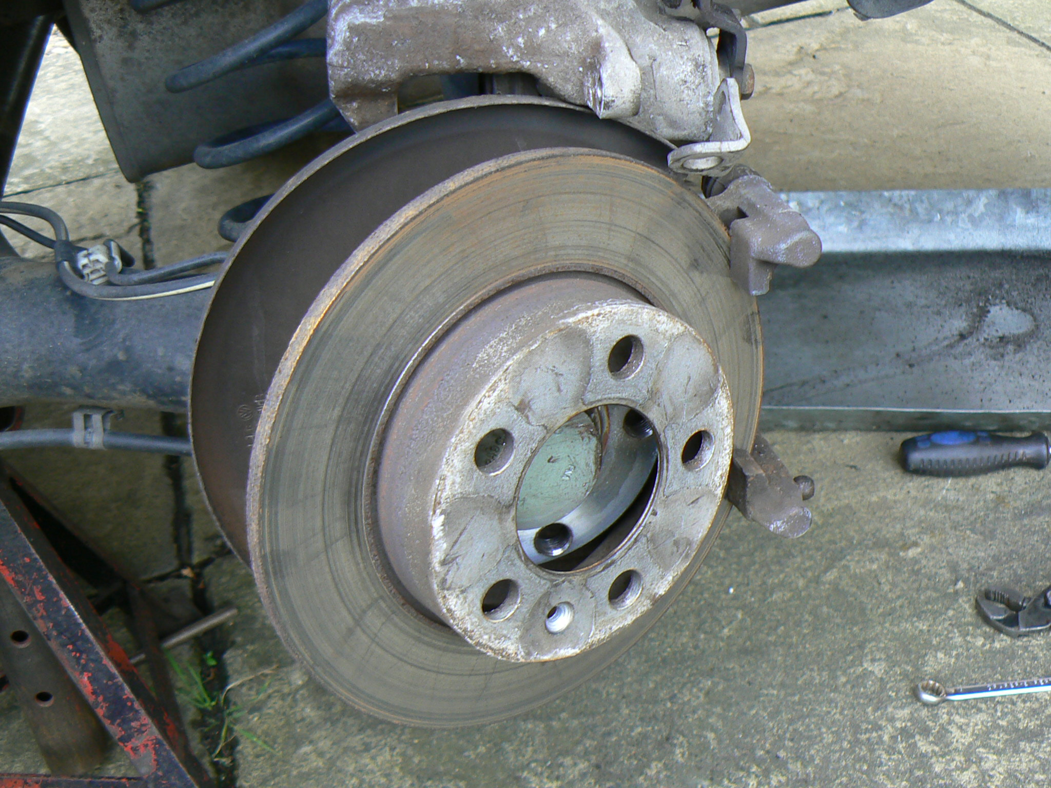

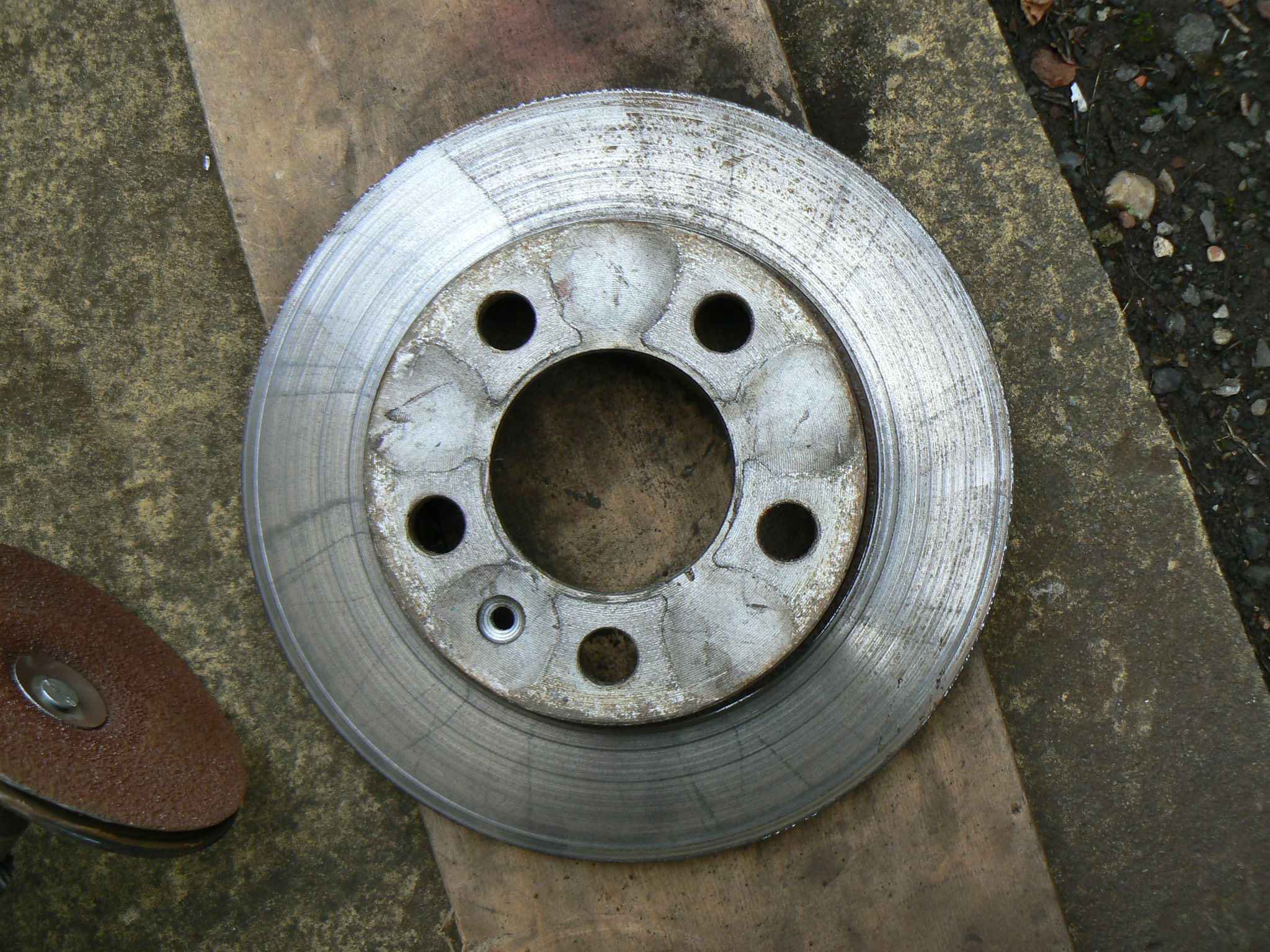

The disc was far better than I was expecting, better than the fronts in fact. The front face was excellent:
and only needed the lightest of skims to take the outer lip off. The rear was a little rougher but still very usable:
Once the outer lip was ground off it was ready for service again. The discs are 9mm thick when new and recommended to be replaced at 7mm. These measured 8mm. so all good. For the less experienced amongst us, those radial lines on the disc are made by the pad when left overnight with the hand brake on. A good run down the road and they'll largely disappear. They have no effect on the braking performance. Of course if one or more are actual cracks that's a different matter all together and will need the disc to be renewed.

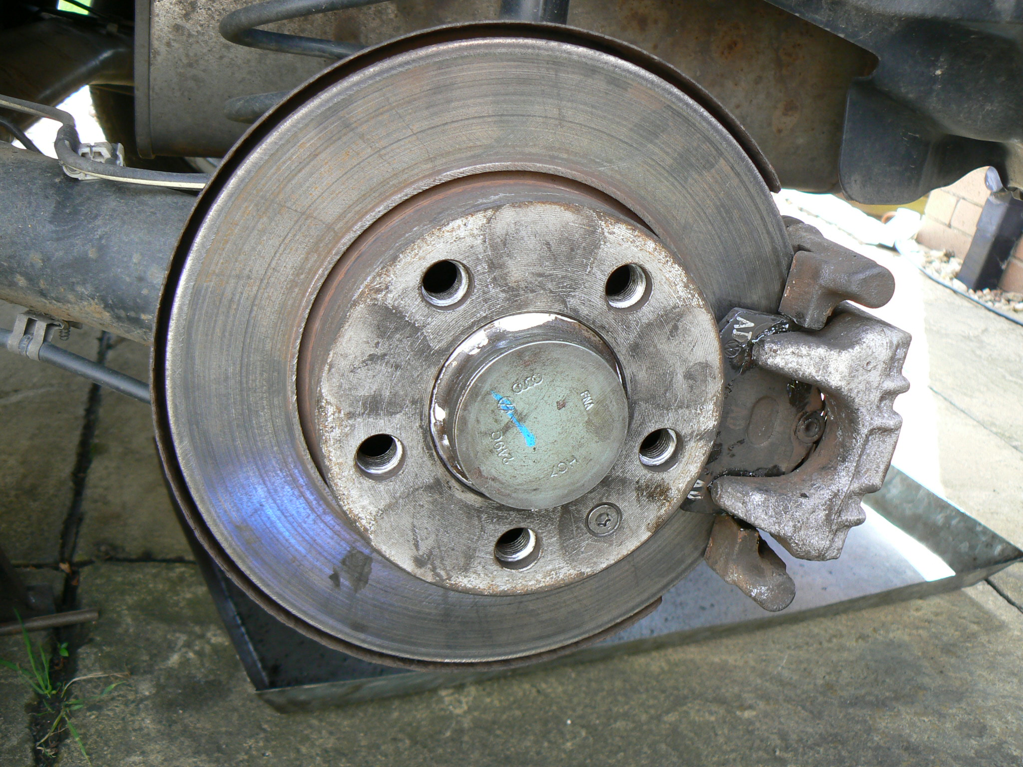

So, it's back to the Ibiza and where was I? Ah yes, disc reinstalled and carrier bolted up with a wee dash of Loctite on the bolts. Pads? more than reusable at 7mm thick, so just a quick wire brush and rub on the deglazing plate I mentioned last week. A small amount of ceramic grease on the carrier and pads and the caliper goes back on and, with another wee splash of Loctite on the bolts, the caliper itself is back on and the handbrake cable reconnected.
Now for the other side. Let's get that wee chamfered screw out first. A wee tap with a flat ended punch to break it's hold and it pops out as nice as you like. Turning round to put the screw in my parts tub (used ice cream tub) I hear a clonk behind me and turning back to the car I see the disc has almost fallen off!
I wonder? If I just lift it up and wiggle it about a bit? And YES! The disc comes off without having to remove the carrier! So I took the carrier off on the other side for no good reason! Ah well, you live and learn. But that's rather good isn't it? means you can change discs on both front and rear hubs on this car without doing any more than removing the calipers themselves. Wonder what the "book" time is for a pad and rotor change?
All went just as well on this side and, because I didn't have to mess about with the carrier, it was quicker too. All back together and looking good!

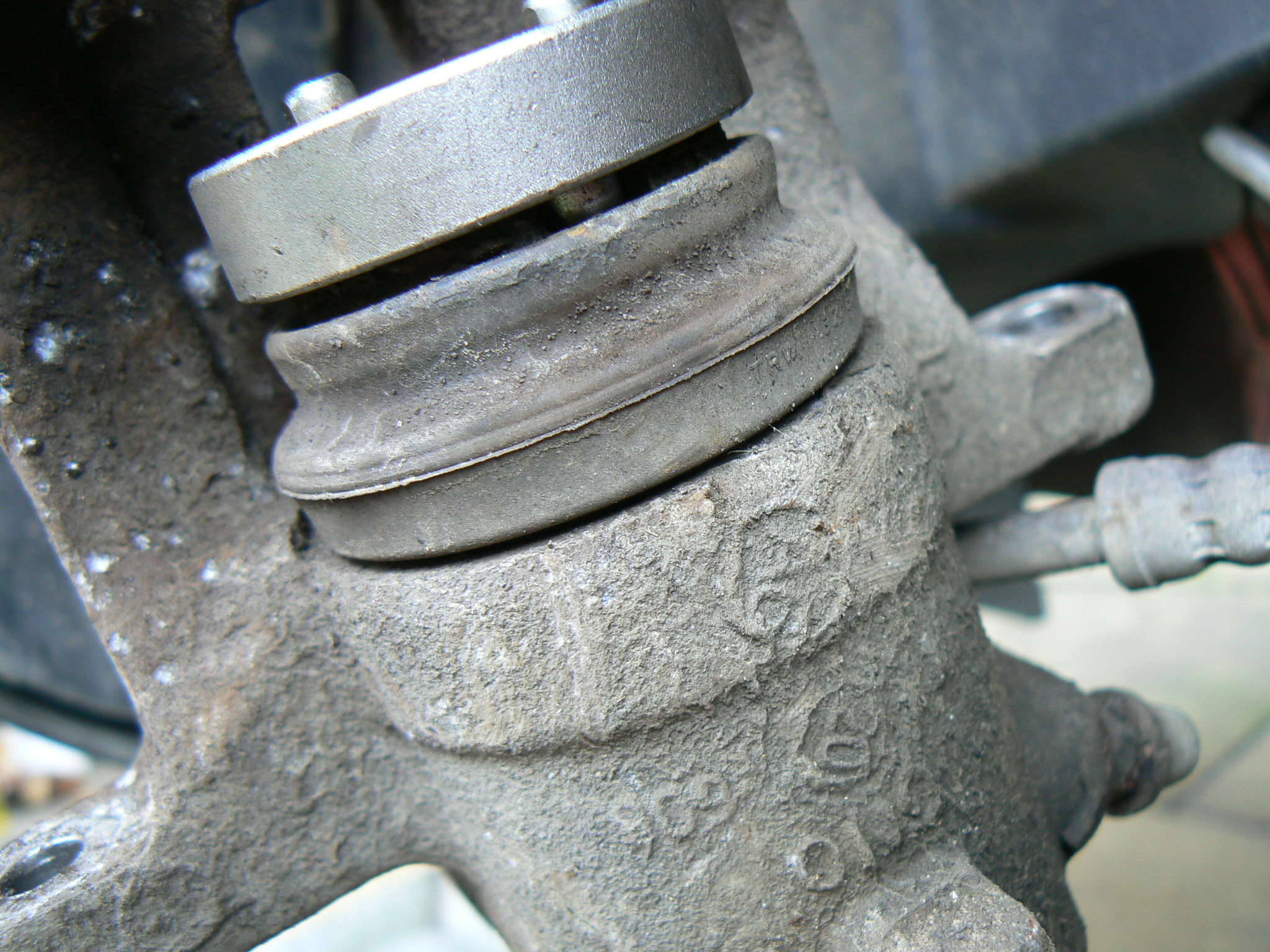

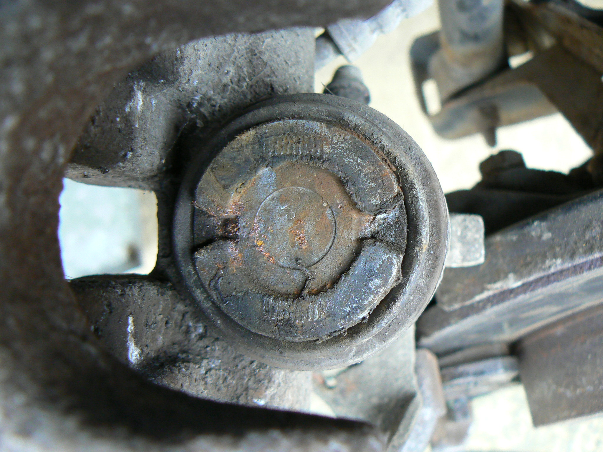

So, while I had one of the calipers off I had a look at the piston face:

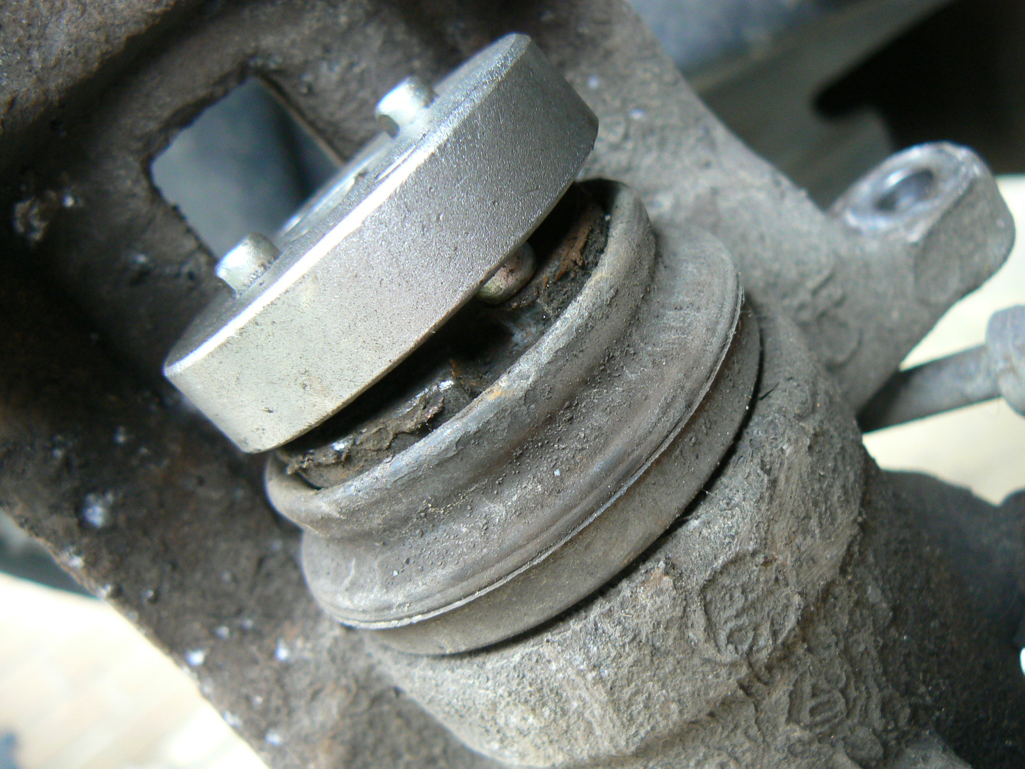

Well, that looks like it might work using the side of the adaptor with the two further apart pins? Let's try lining it up:
I recon this is going to work, so settle ti fully home on the piston:
And YES! Luvly Jubbly, it fits a treat! Hurrah, now I won't need to buy a new tool next year when I will do disc and pads - most likely, if I still have the car.

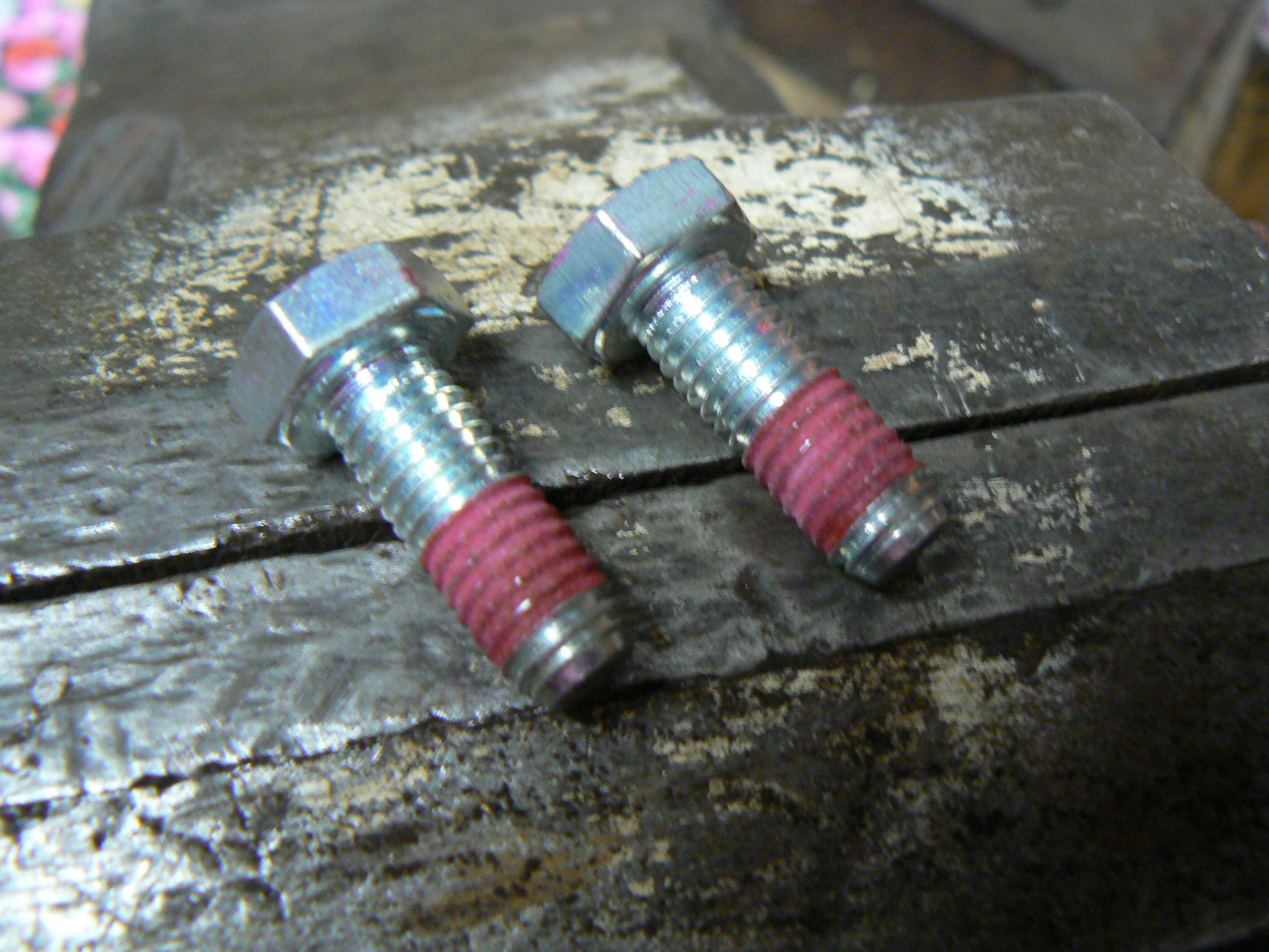

Ooops! just noticed there's a wee asterisk along side the torque figures in the Haynes manual for Twink, opposite the settings for both the caliper carrier retaining bolts and guide pin bolts. Look down to the bottom of the page and you see - * Use new bolts.
The tightening procedure for the carrier bolts is - stage 1 tighten to 90 Nm. Stage 2 Angle tighten a further 90 degrees. I have to say that they looked in excellent condition with no signs of tread stretching, wasting or other signs of damage. I'll risk your condemnation and disdain - shock horror - by admitting I didn't torque them, simply gave them a dash of blue Loctite and snugged them up "nice n' tite". Mind you I must have done thousands of these in my lifetime so have a good feel for it. However, had I been checking the book for the torque setting I'd have seen the advice! So almost certainly these are stretch bolts and I'll be ordering new ones today. In my defence I'd say though that they tightened as you'd expect with no thread binding or feeling of stretch and I'm confident they'll be Ok for the two or three days the new bolts will take to arrive. In fact our next journey out in Twink will be next week to take the grandchildren swimming so she may not move a wheel until then as we use Becky around the town.
The tightening procedure for the guide pin bolts is just stated as 35Nm (no angle given). - stretch bolts usually have an angle tightening component - I've never routinely replaced guide pin bolts and I'm not going to with these ones. I'm wondering if it's just a "scaredy cat" knee jerk on the behalf of the manufacturer? Maybe it's just that the new ones include thread locker? Here's a couple of new ones for another vehicle which I didn't use on that job:

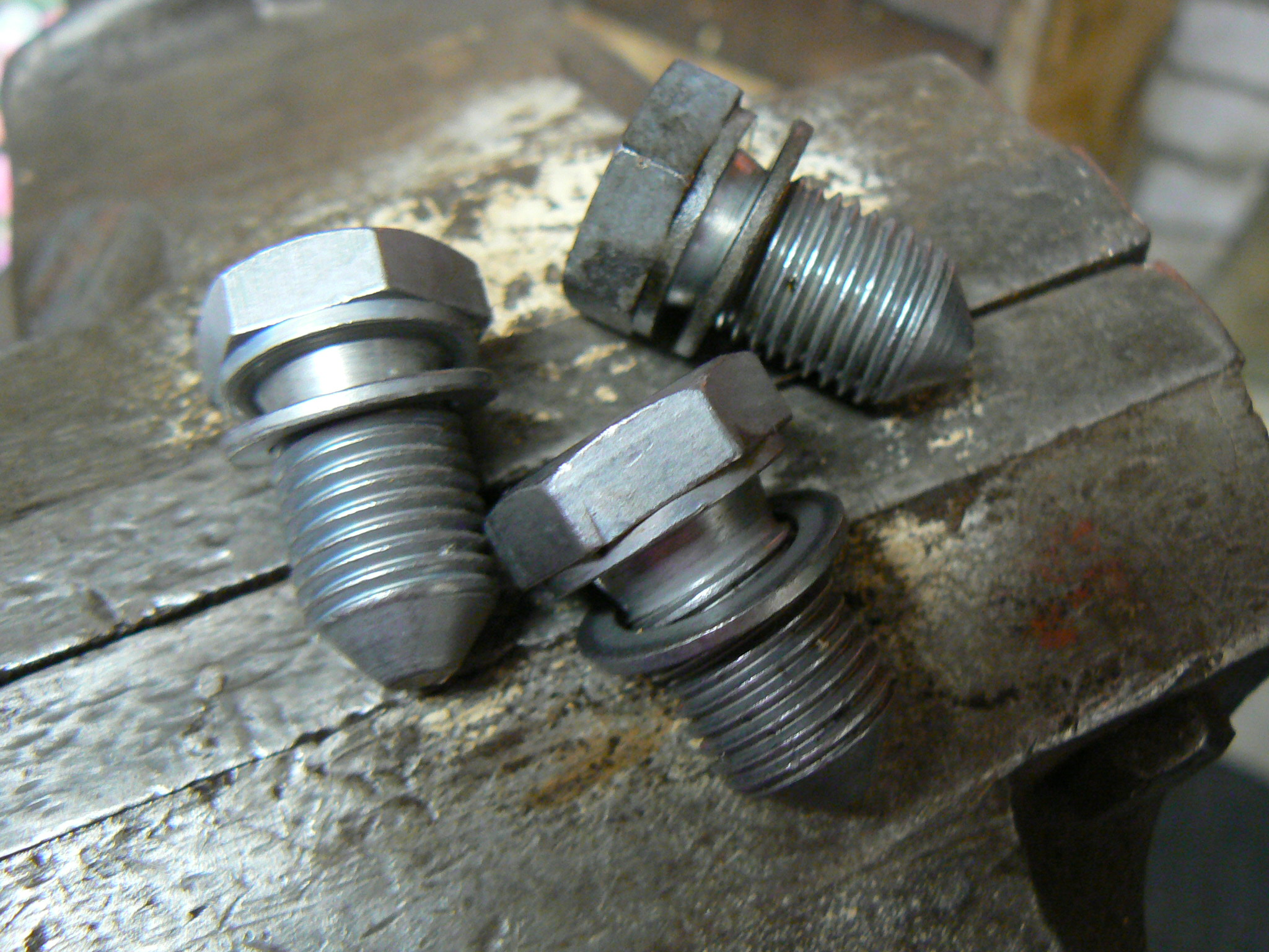

I find VAG are good at telling you to replace stuff that's not strictly needed, for instance Twink's sump plug, which they replaced at every service during her warranty period:
I bought a new one first time I changed her oil but when I removed the old one I couldn't see why they were replacing them. Typically I'd reuse a sump plug but renew it's crush washer. Close examination reveals the washer on this one is solid steel and non crush, can't be removed over the threads either so maybe they replace them in case there's damage to this washer? Anyway, I stuck the old one back in and have been using it ever since without any problem and no signs of even a small leak. That's the new one on the left in the picture. The other two are, if I remember correctly, from the 1.9PD Fabia my older boy used to run - same plug and both look in good usable condition. One thing I did find out was there are two versions of this plug, identical in all respects except one is only half the length of the other. I bought that new one from the main agent but they gave me the shorter one and then tried to say the short one would do. I stuck to my guns and insisted on the longer one whereupon I was told it was on back order and I'd have to wait for it - so that's why they tried to flog me the short one I guess? - got a long one from ebay within a day and a half. Has to be a danger of stripping the thread in the alloy sump using the short plug torqued to the recommended 30 Nm I'd have thought? Wonder how many are wrecked by using the wrong plug?
