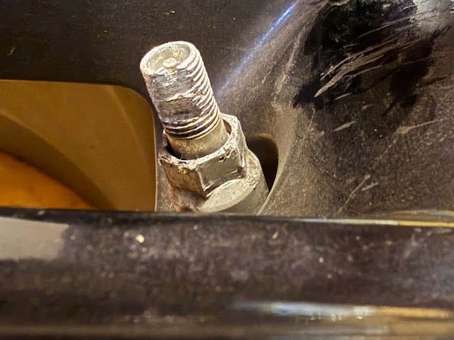

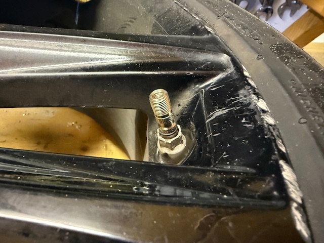

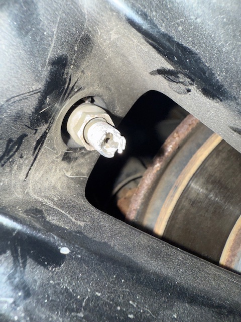

I ignored mine because of previous damage I did removing alloy dust caps. So I presumed it was the worst one which after a month and a half drops down and is near impossible to fill.

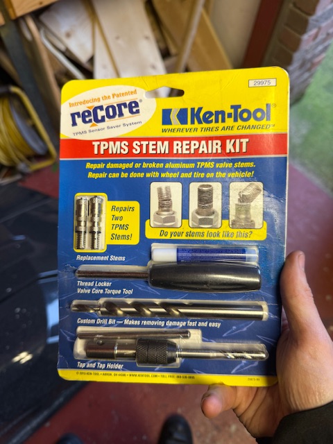

Because of that I bought this very niche repair kit that suspiciously seems designed for Toyota’s on all the promotional videos… actually did the rear two wheels on Saturday. Had to double check and use way more loctite and let it sit a bit longer in the cold… but a few days in, job’s a good’un. Saved me £170 per tpms sensor since Toyota doesn’t build it to separate from each stem… £55 all in. Wasn’t as scary drilling into them as I thought it might be. Did the second one on the car and all.
