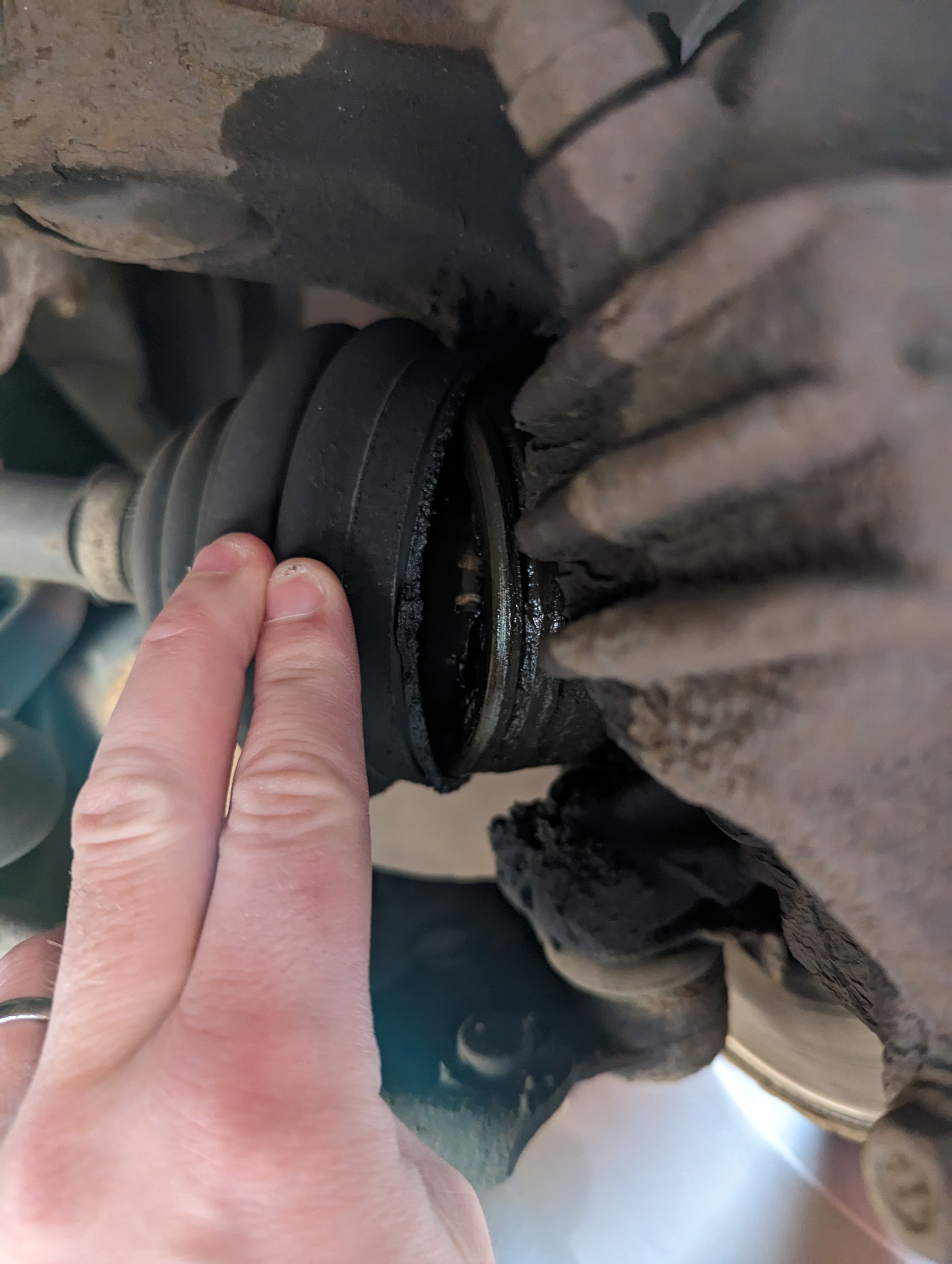

Changing the brake pads on my brother's 407 last night, wheel bolts on one side were seriously tight. Second side was worse, and resulted in a sheared bolt. Didn't have time to sort it last night, but 4 bolts will be safe enough until I look at it again.
One of the guide pins had seized resulting in one pad down to the metal. And pad on the other side of the disc crumbled away, heat damaged.
Gator had started to split on the CV joint, so some nice black grease on everthing behind and rear of caliper. It's an awkward double wishbone suspension, so hoping there's enough movement to get the driveshaft out with only the bottom link undone. That'll be added the the joy of trying the drill the broken wheel bolt out,
Looks like you've got some fun times ahead there. I take it this isn't a car you see regularly? with so much stuff seized up I wouldn't be surprised to hear it was dealer maintained? Has the wheel bolt sheared off flush or under the surface of the flange? if so might be possible to wind it on all the way through?
With my brother, unless sometihng is falling off the car then it's driven into the ground.
It had work done for it's mot at the beginning of the year, he let the mot garage do the work and they were cursing that car. I had phoned up as he thought he was getting the runaround, but it was all to do with the peugeot stock system crashing out for a few weeks and no one could get parts.

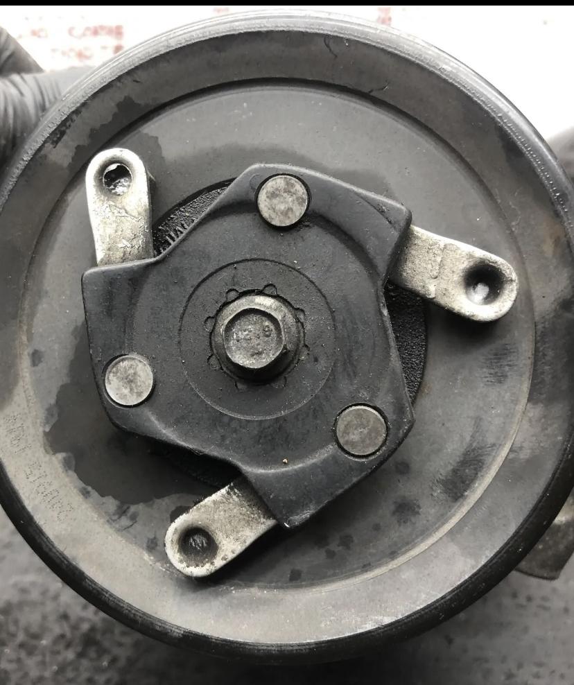

I went on eBay (usually the best place for pictures of disassembled parts, to find a picture of the clutch and found this
The outer and inner part of the clutch are connected by those three silver bars/arms, and on mine one of them was broken in half. I turned the clutch over again and found the other two had completely disconnected.
Looking at the picture above it looks like they are pretty badly made and only pushed into some sort of hole on the pulley there is no bolt or rivet. My theory is that over the last 7 years of the aircon being run permanently when. The car is running, the cycling of the clutch on and off finally caused those push fittings to detach on a couple of the metal bars and the resulting pressure on the one remaining bat caused it to break in two.
Now the forensic investigation is over it needs to be fixed. My local vw people are only 100 yards from my house so I’ll drop in and see them tomorrow and see if there is a official VW clutch replacement they can drop in for me, I’m fairly confident the rest of the system is ok.
Even then I am not looking forward to the bill.
In the past one of my customers aircon was rattling from the clutch (she used to drive through flooded lanes regularly to see to her horses) pump not servicable, new complete unit only. I think hers was a Toyota Yaris? , hopefully VW better.
