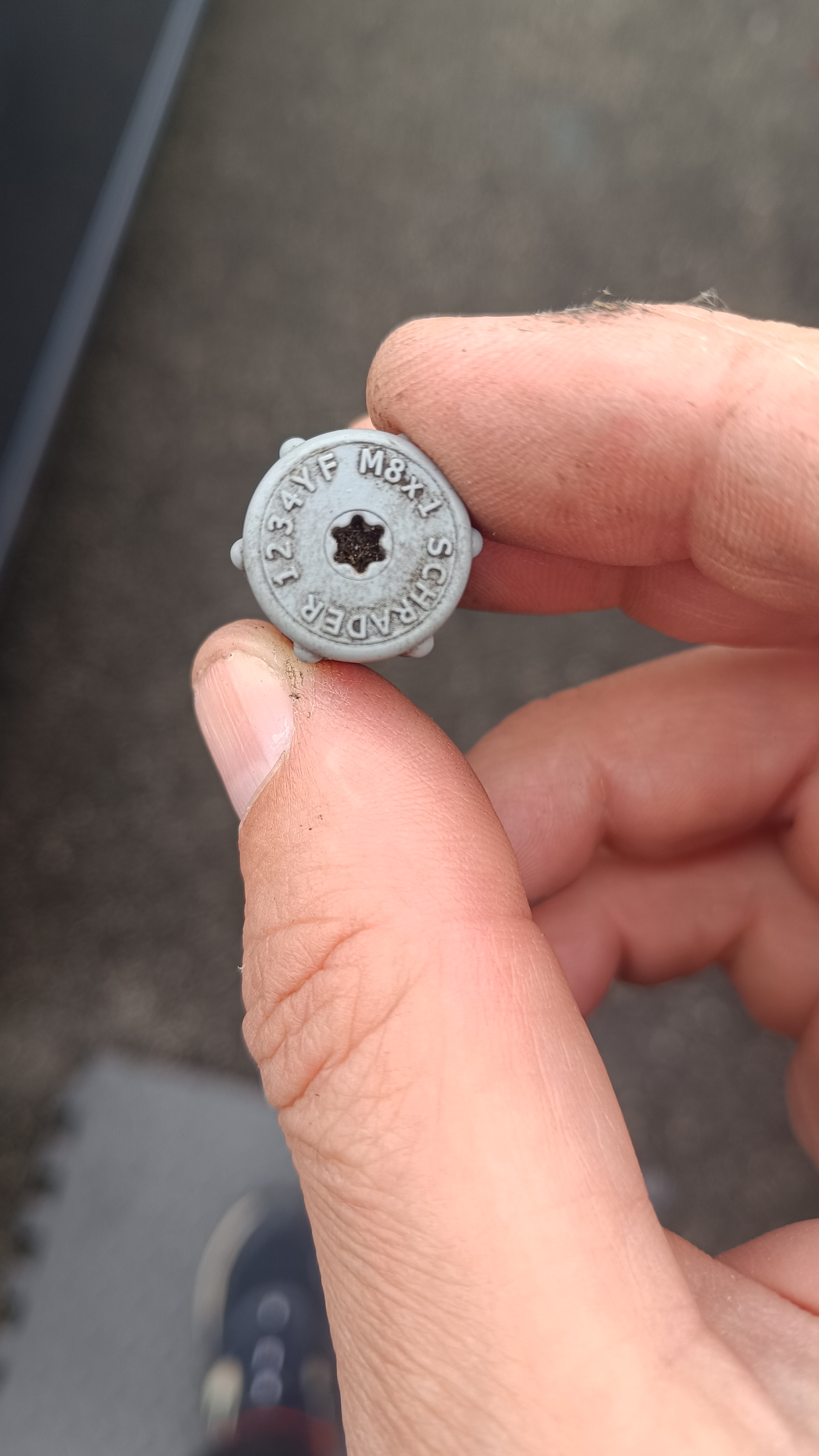

I had a look under the bonnet and there were no stickers/info of relevance, however on the silvery metal pipe there is what i believe to be the Aircon "Low" valve. There was no sign of how much gas to put in there, but i'll have another look.

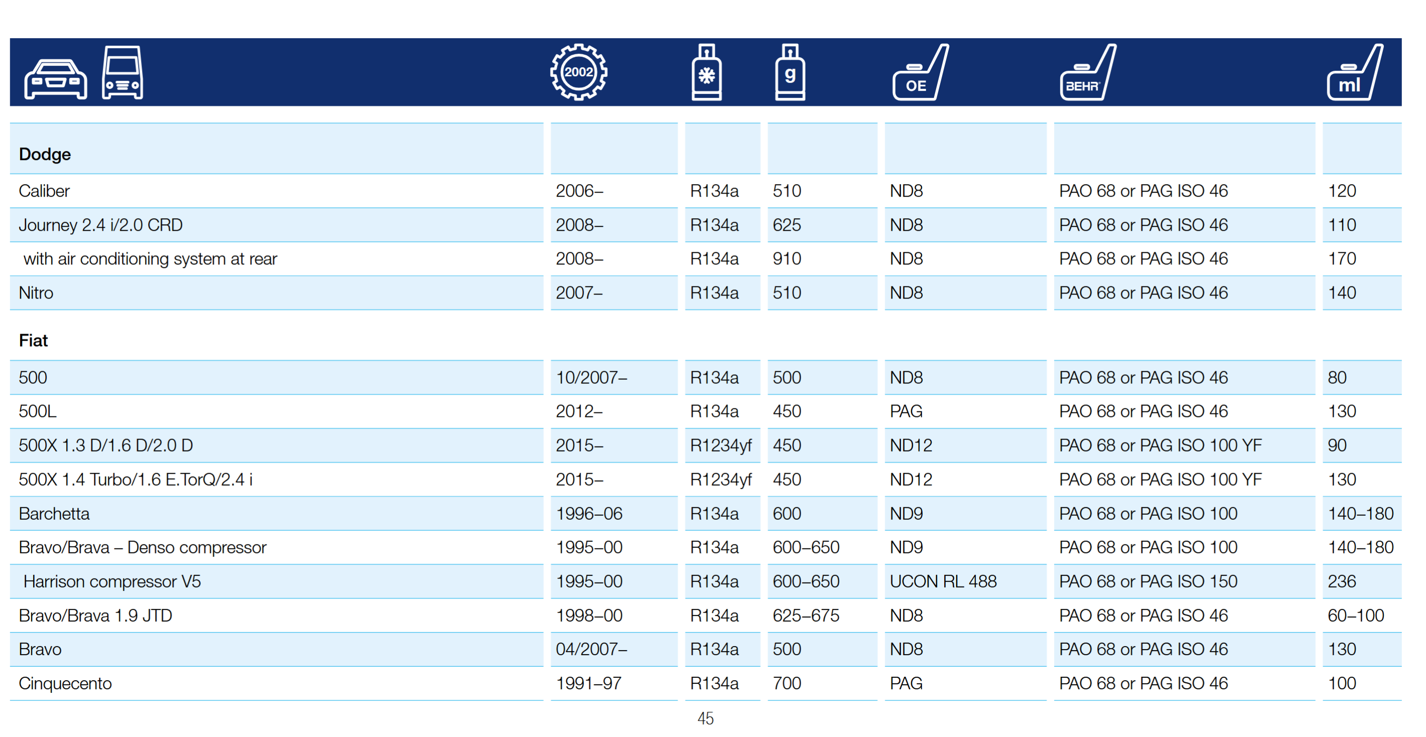

Look your car up in: https://www.mahle-aftermarket.com/m...ch-fuellmengen-pkw-&-nkw-210112-en-screen.pdf
Fiat's are on page 45 , 3rd column is refrigerant type, 4th is how much, 5th/6th is lube type, 7th is how much lube.

Look your car up in: https://www.mahle-aftermarket.com/media/homepage/facelift/media-center/klima/thermokampagne/2021/2-2-handbuch-fuellmengen-pkw-&-nkw-210112-en-screen.pdf
Its a Fiat 500X, 1.6D. I took a look at the link and posted its picture below, its very handy, thanks.

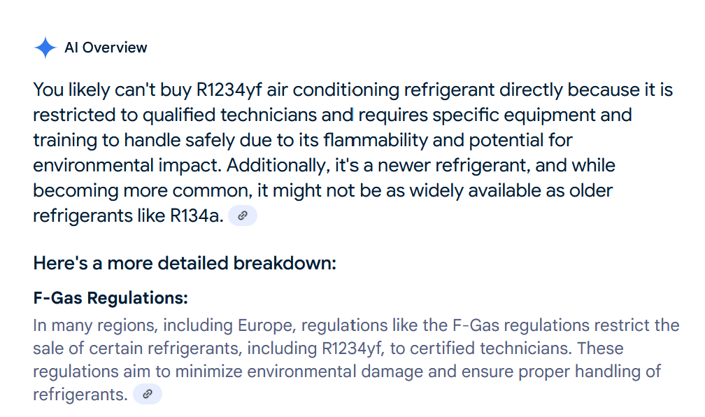

It appears the sale of R1234YF to retail customers is banned in the UK. Only certified technicians and garages can legally buy it. This explains why all I can find on Amazon and eBay are "compatible" gases.
Mmmm. Thoughts?
