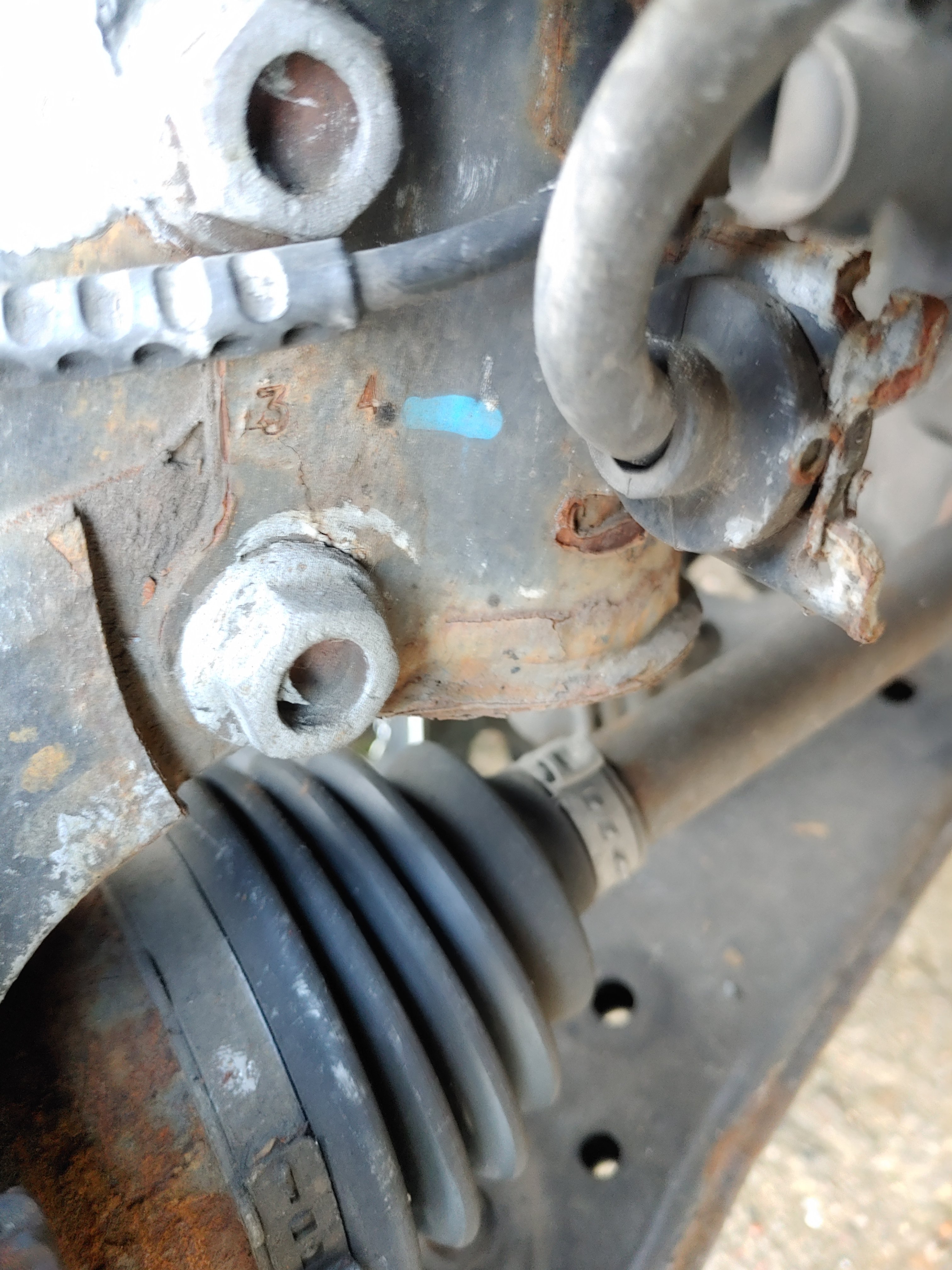

Well just for a little update I coated the pinch bolts around 18 month ago approx they are still very well coated even now the stuff has dried into a hard paint like coating
