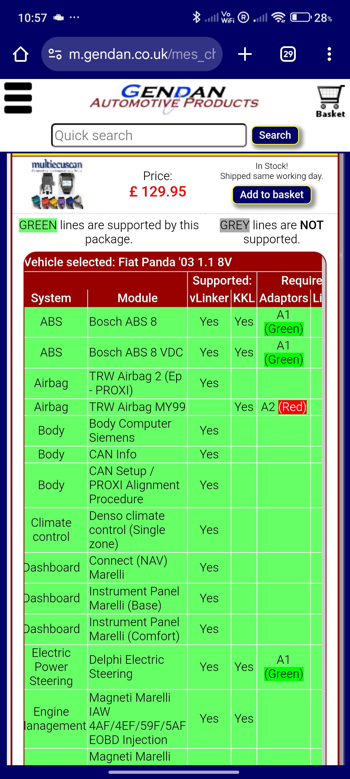

I couldn't see specifics on the cables. Was this the page you meant or is there another?
Thanks
That just specified elm... But there appear to be different chips on elm cables...?
It's their ELM they're talking about , the one with the chipset they know to work with their kit they sell.
They're (quite rightly)probably not gonna tell tell you which specific ELM chipset works because they want to sell their kit , you might get lucky getting a 3rd party one but theirs is known to work.

Supposing 1.1 8v 2003 you need ELM327 v1.5 or v2.2+ and adapter A1 green to do 99% things.
