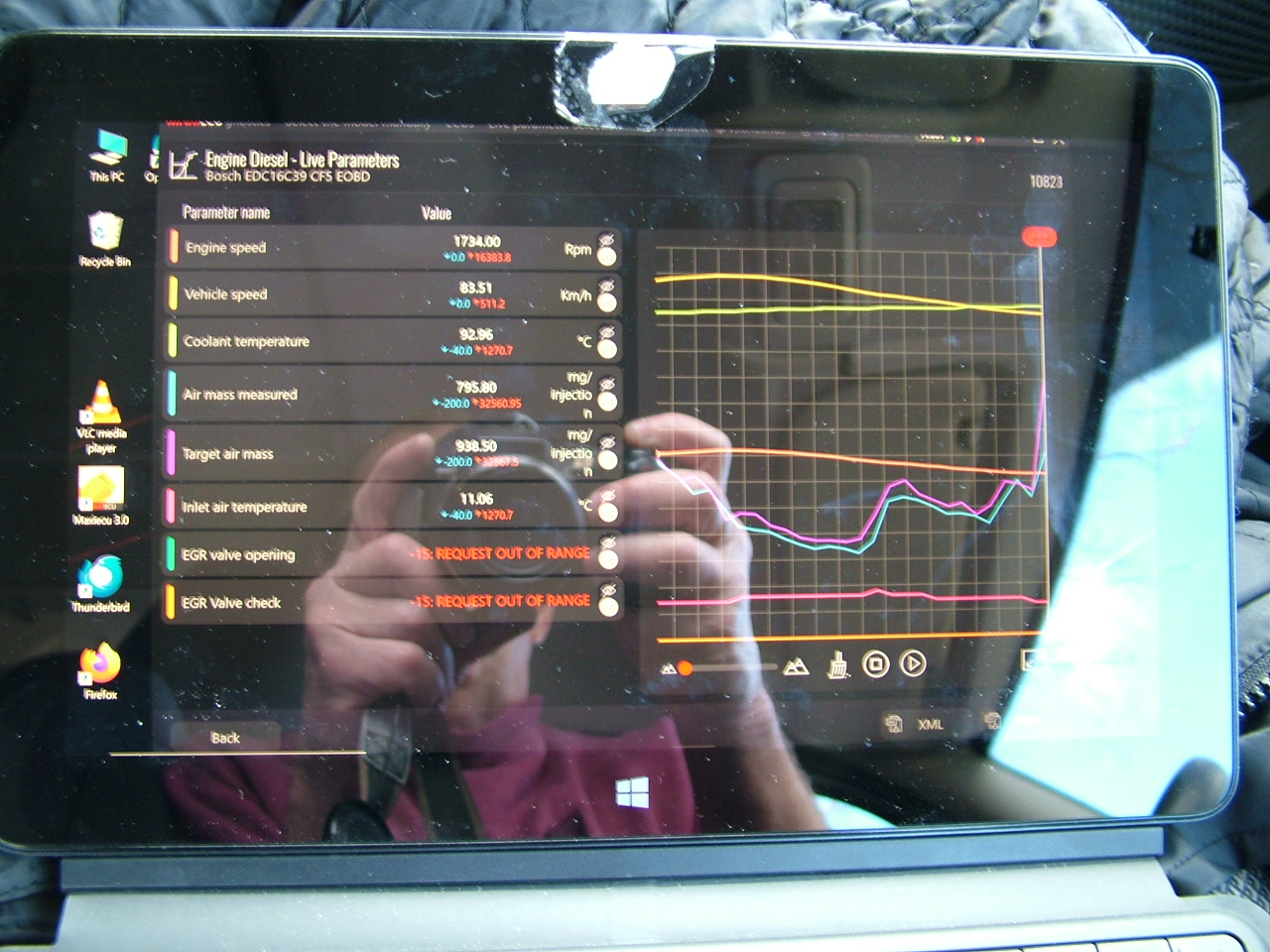

These are some parameters at a stable cruise:
I was going to compare my readings as I have MaxiEcu Scan tool also and a Fiat Doblo van 1.6 , unfortunately it is a 2010 so doesn't have the same emission standards I believe.
If interested I could maybe try and do it. What gear 6th and engine revs?
Yes 6th and ca 2krpm
This is the best I can do , I am sorry the pics are blurry, old age and old camera.
There is a slight delay in target and actual, but generally fairly even I found.

Hello
Changed the air filter, no change - as expected.
Performed a test on a flat road with warm engine and steady 102km/h (GPS) with disconnected MAF. It was interesting to see that:
With MAF:
MAF reading: 630 mg/stroke
MAF target: 1500 mg/stroke
Indicated fuel consumption: ca 7,9l/100km
Without MAF:
MAF reading: 711 mg/stroke
MAF target: 482 mg/stroke
Indicated fuel consumption: ca 6,7l/100km
Can anyone help me interpret the results? Why is even MAF showing any value, I assume it calculates it from some other parameters when disconnected?

OK, now I have changed fuel and oil filter, oil, air filter.
I bought a used MAF, just to compare the results. Prior to installing it I wanted to remeasure current MAF - and now it shows spot ON! Very strange. As it showed same error just after air filter change.
Fuel consumption is still ca 7,5-8,0 l/100km at 110km/h on speedo and 102km/h GPS - way too much in my opinion.
Looking for some other pointers/clues.

It would be interesting to know why the original ECU was changed, I read somewhere that on certain Ducato models there were several upgrades to the ECU.
If your Fiat Dealer is good they should be able to use their equipment to put the latest "firmware" into your ECU assuming yours tells them it is not the latest version.:)
If now MAF actual and desired reads are similar then ok, if not beware of intake valve position.
Check at idle:
- MAF temp
- MAP temp
- barometric pressure
- boost pressure
- injectors corrections cold/warm
If all ok recode injectors (note actual codes) and test.
Usually it's injectors, DPF or ecu map bug.
