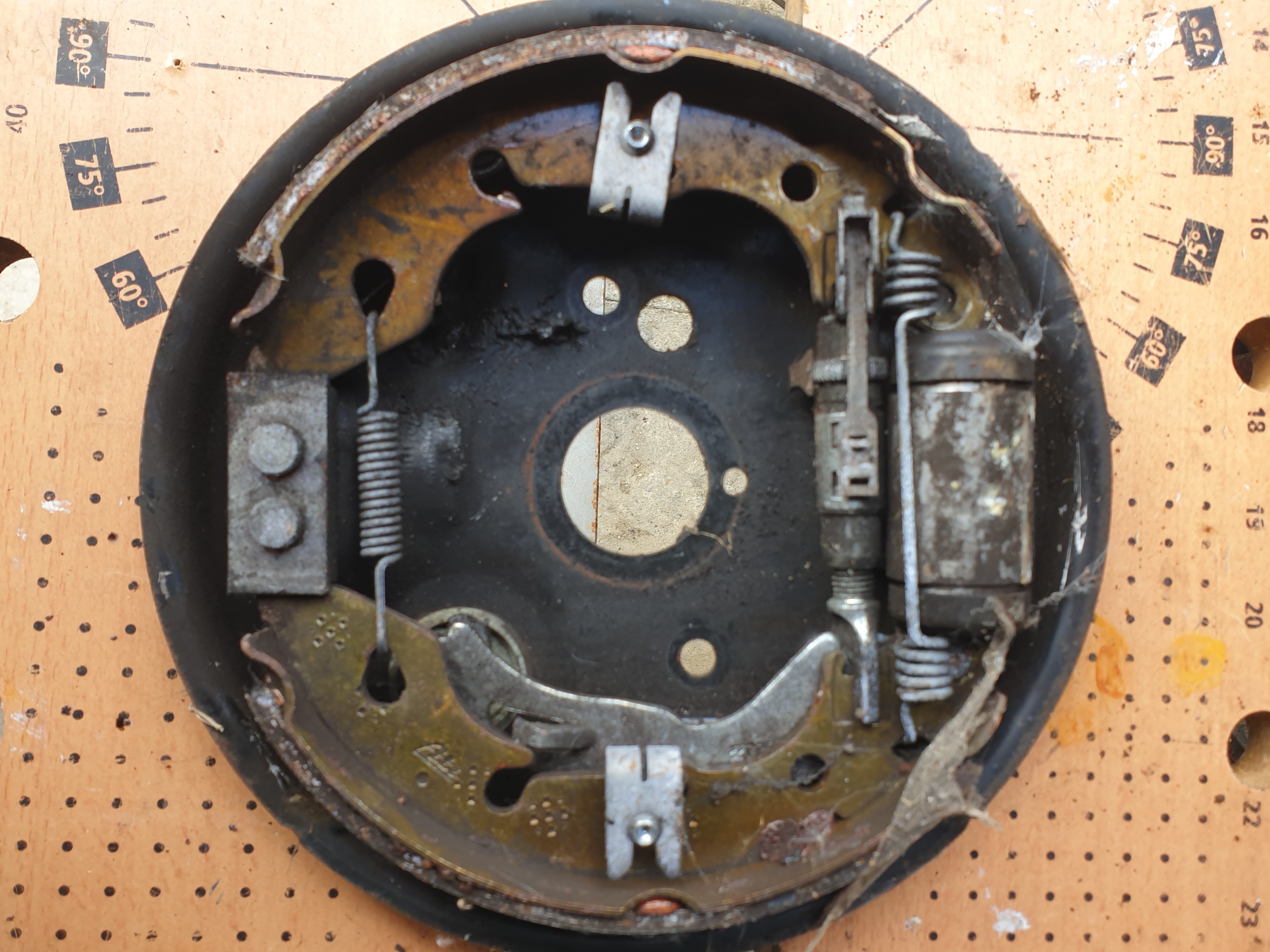

Treated Becky to a new set of rear brake shoes yesterday after discovering that the old ones were delaminating. Not too surprising as I think the old ones were the original fitment so "only" 12 years old! If you want to see some of the shocking pictures I've posted them in the "not grumpy but not smiling" thread. When I'd done the shoe replacement I started to have a good look at the rear axle which I've commented before is considerably past it's best with quite a lot of "tin worm activity" around the spring pans. The worst bit seems to be around the front edge of the O/S pan where the metal thickness is now probably half what it was when new. There are, so far, no signs of any cracking and nothing has bent or moved out of shape but I think the time is rapidly approaching when I'm going to have to bite the bullet and replace the axle. With this in mind I've been in contact with IM Axles regarding their product: https://www.imaxle.co.uk/new-fiat-panda-axle They state that their axle for the Fiat 500 has thicker spring pan metal compared to the original but make no mention in their advert for the earlier 169 axle so I was interested to know if that has thicker pans too. They confirmed that that is the case.

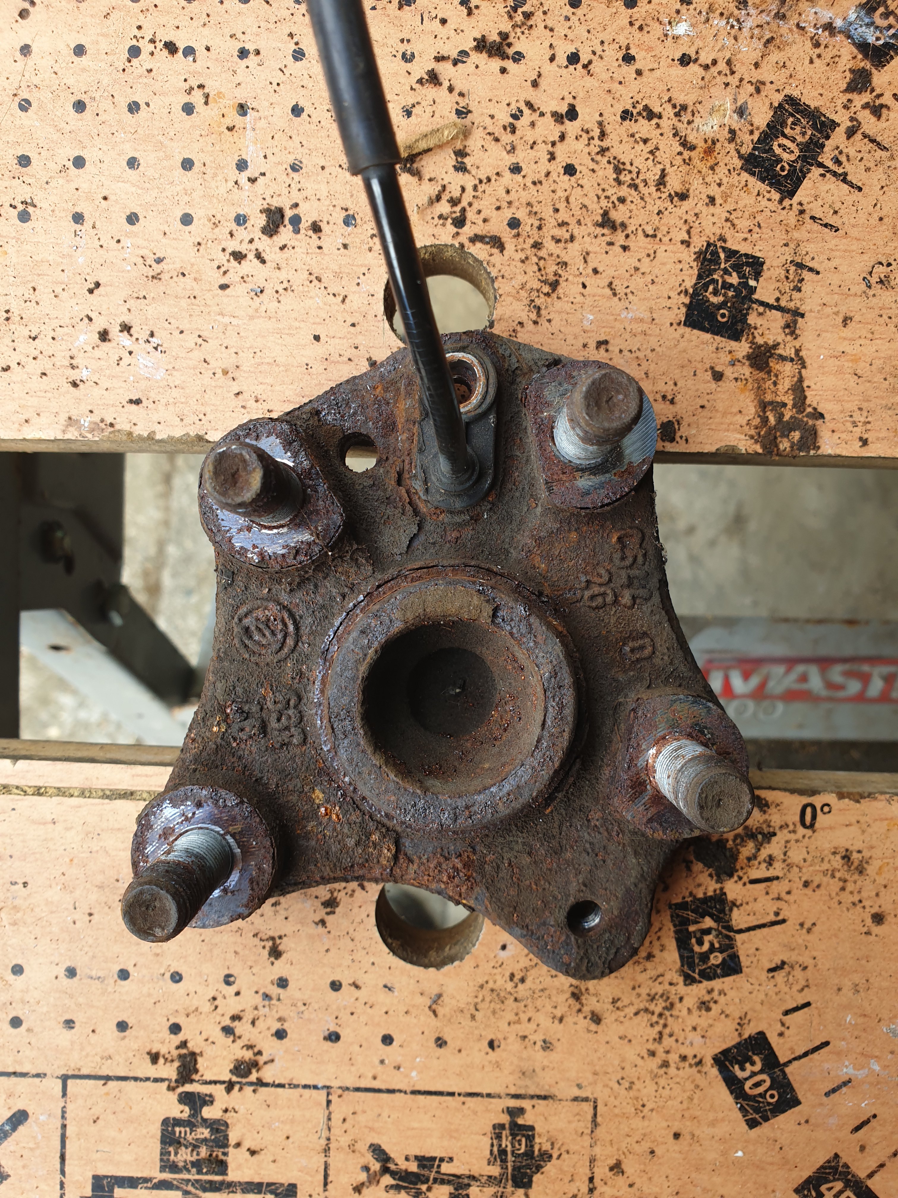

Can anyone tell me whether the axle stubs are held on with nuts and bolts? I can see four large nuts on the inboard side of the hubs (looking very rusty, not looking forward to tackling them) but are these studs threaded into the axle plate or will I discover hex heads when I remove the brake back plates - which I notice are held on by 2 hex headed screws which also look pretty rusty!

Hi Jock
They are held on with studs.
I have about 80% success rate removing them without trashing the threads, but the studs and nuts are available fairly easily.
Strangely, older ones (04/05 plate etc.) seem to usually undo better than newer ones. No obvious reason. Another wierd FIAT thing, I guess.
As usual, wire brush and a few doses of PlusGas seem to work best.

Thanks irc. So the studs are threaded into the axle plate with the hole in the axle end plate being a smooth bore? Hmm. So there would be no need to undo the two allen bolts which hold the brake back plates to the axle plate. I'm thinking, having got those four large bolts undone the axle plate complete with stub axle and back plate can just be swapped over as a unit? (brake pipes and handbrake cable etc will need to be disconnected of course but does the ABS sensor have to be extracted from it's bore?)

Hi Jock
This lot were from a 55-plate that seemed to have been parked underwater for most of its life, but mostly good to go again.
In this particular case the ABS sensor cable had been damaged (when the cup failed and the spring made a bid for freedom) so it's coming out, but otherwise it would have stayed.

Thanks for the pics irc. That's very helpful indeed. I think I'm going to wire brush the threads to within an inch of their lives and run a thread nut down the exposed length of them before I start. Lots of plus gas and use my air wrench to work it repeatedly both ways to loosen. The brakes in the second image are slightly different to mine and it's interesting to see them. The self adjuster is different but similar to mine and I kept on seeing it in adverts when I was researching for Becky's pads - which in the end I bought from my local factor. Didn't need to buy self adjusters as the old ones were in good order after freeing up but very interesting to see an illustration of this other type - the shoes themselves look slightly different too.

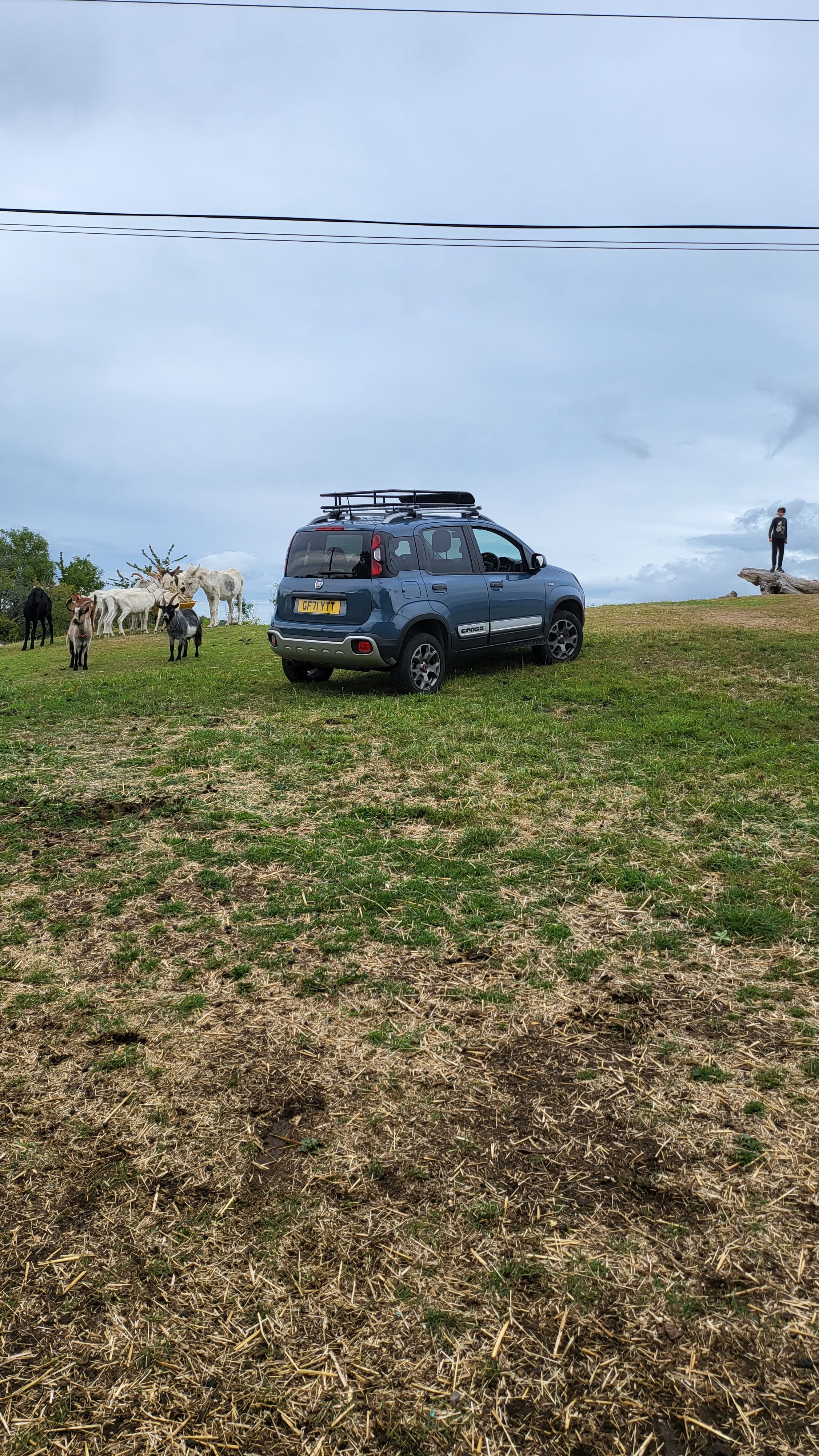

We are off for a 5 day trip to Wales with 5 people in the car.

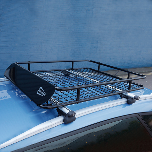

Fitted roof rails and a roof tray / cage for the luggage. Makes the 2022 Panda Cross look a little more purposeful.
Total cost with roof bars only £125. Roof boxes are soo expensive. This is the cage (not my car though). Will add a photo of it on my car tomorrow.
Maybe some spot lights in the future :)

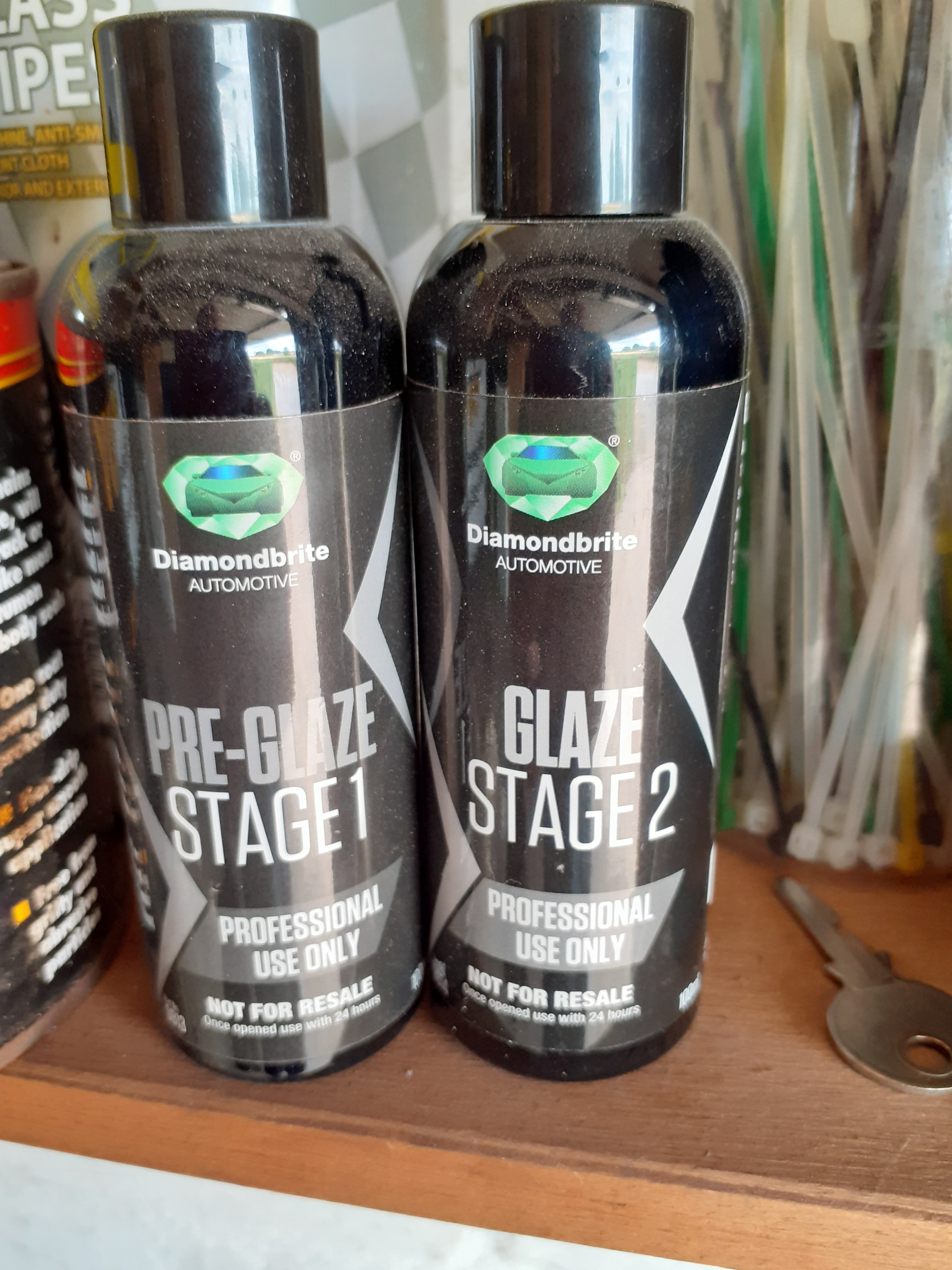

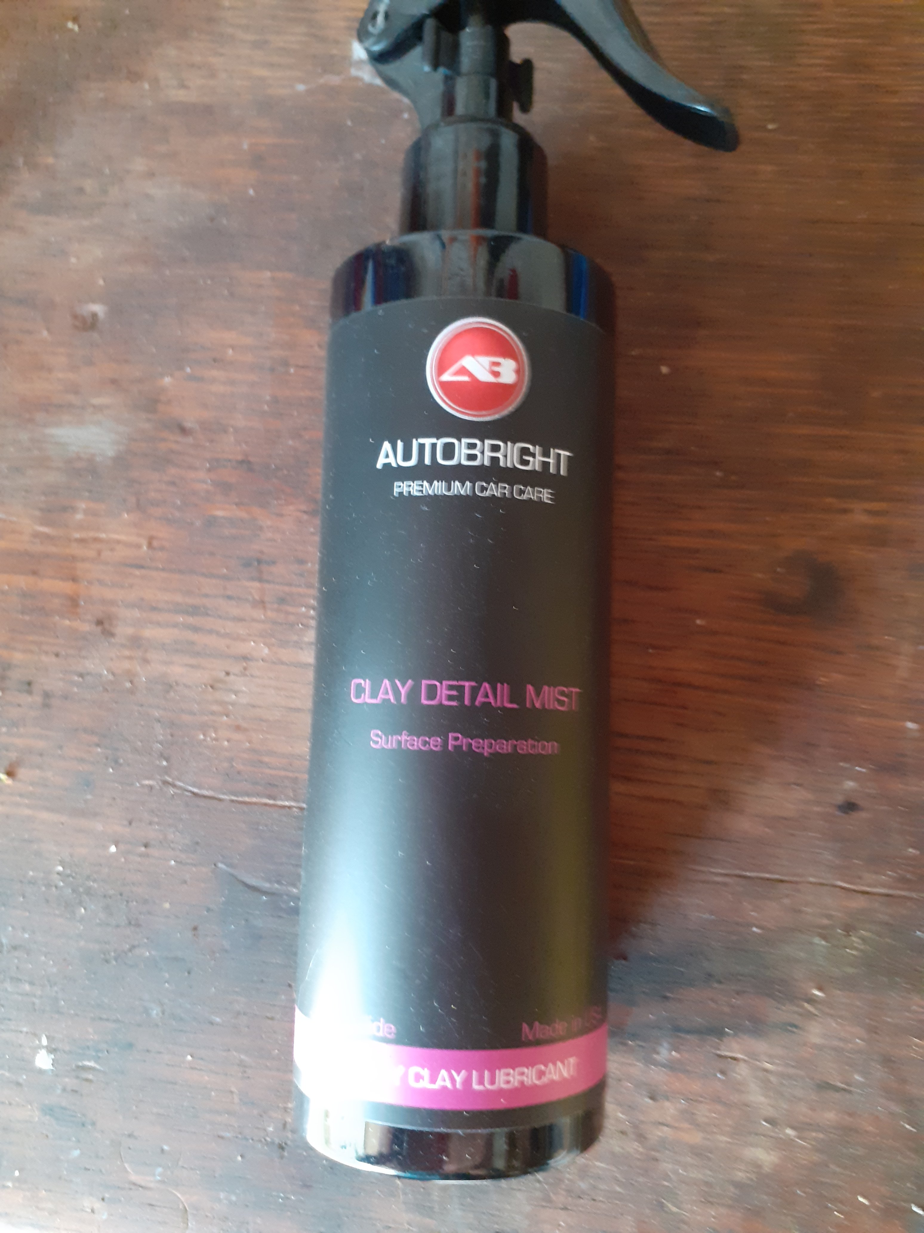

Right I have now taken photos. Ive decided just Autobright Clay bar and clay bar mist spray followed by a really good buff up. I have run out of autoglym polish but sometimes follow with this. I am pretty impressed with Diamondbright polymer sealant. The treatment is two parts and it needs a dry hour after the 1st coat then a light buff and the final and the effect is profound. The best straight polish I have used is Armorall shield as the effect lasts much longer than standard car polish. At least 3 months, but is does sometimes leave runs on the paint after rainfalland dont do the screen. Rain and washing restore armoral shine and the runs can be rubbed off with a micro fibre cloth. This can be topped up with their orange liquid wash n wax. The auto bright spray seems not only to be a lubricant for the clay bar but als the most effective shine product I have ever used. NOTHING comes close in my experience and its easy to use and can be used on the entire car, As can and should the Diamondbright be. They said do the whole thing. Diamondbright seals the plastic bits well and my car is still looking new a year after its last treatment. I try and avoid the front screen as I believe its better left totally unmolested. I clean this with Carb and brake cleaner as the best thing to reduce smeary grime. Armorall shield on tired black pastic is one of the best things as a quick and easy restorer. Diamond bright definitely stops insects and bird pohh sticking to the paint to a great extent.
Basically clay block evry inch, glass plastic and all untill its shining and spotless These things remove the lot, residual insects, residual bird pooh, tar, oxidation and bloom and also micro scratches. Its not hard but is a bit slow and tedious. The spray is outright astonishing and the fastest way ever to really shine a car. Once done with clay I usually polish with autoigym too and then I now coat the whole car once a year with Diamond bright. My car was treated with Supaguard when new which is similar but extremely poor in comparison, as well as being outrageously pricey. Supagard do do a very good trye treatment but its expensive and a bottle does not last long. I always wash the wheels and / or wheel trims with either armoral wheel treatment or wonderwheels and find it does reduce brake dust sticking impossibly. On wheels not cleaned for yonks, I have an electric tothbrish for cars cant remember who made it but its 1st rate at wheel cleaning with some chrome polish it will with care shift everything leaving them like new. I follow with Diamond bright spray and wonder wheels or armorall wheel.
