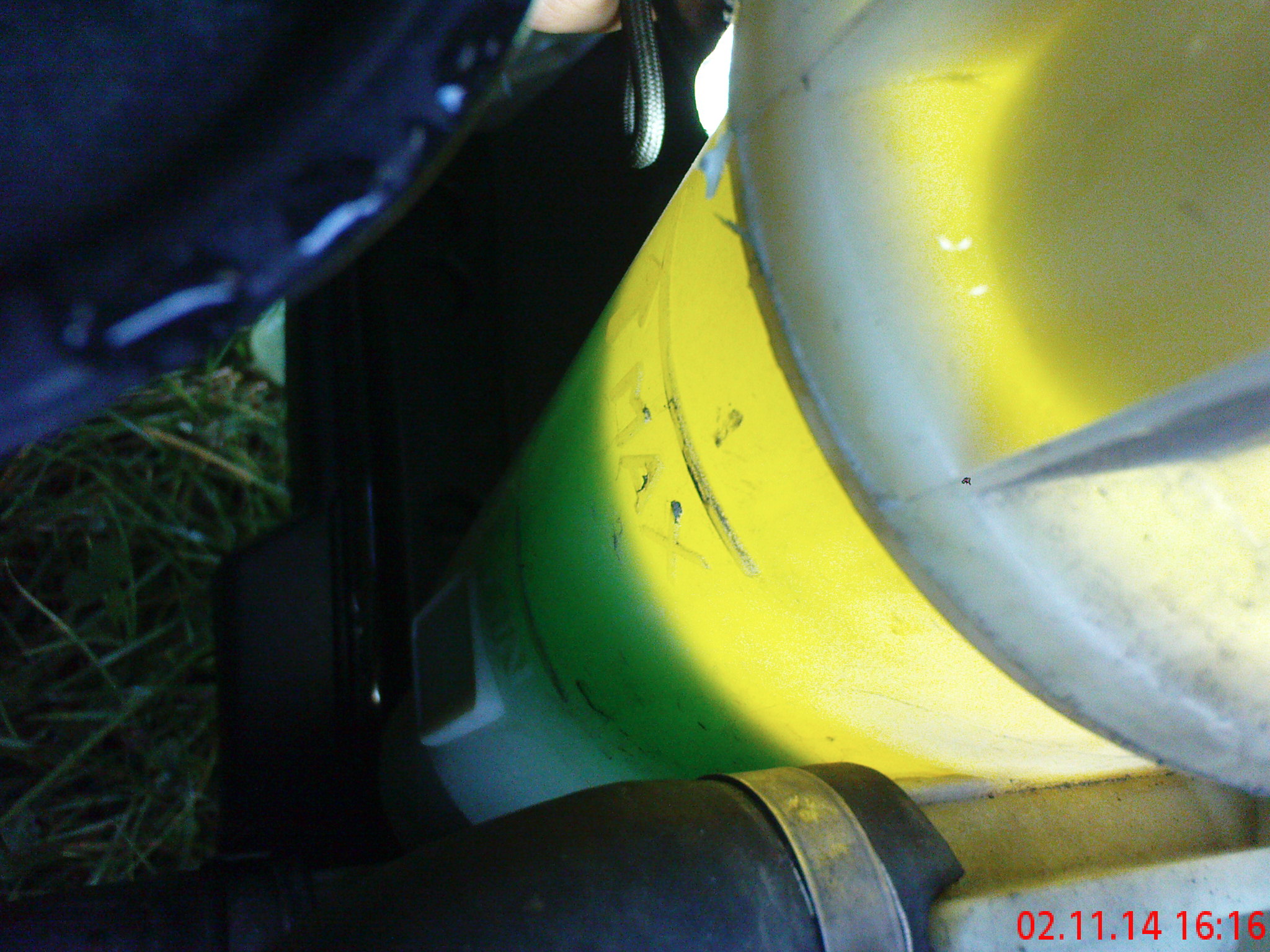

-----------------engine ON --------------------------- engine OFF

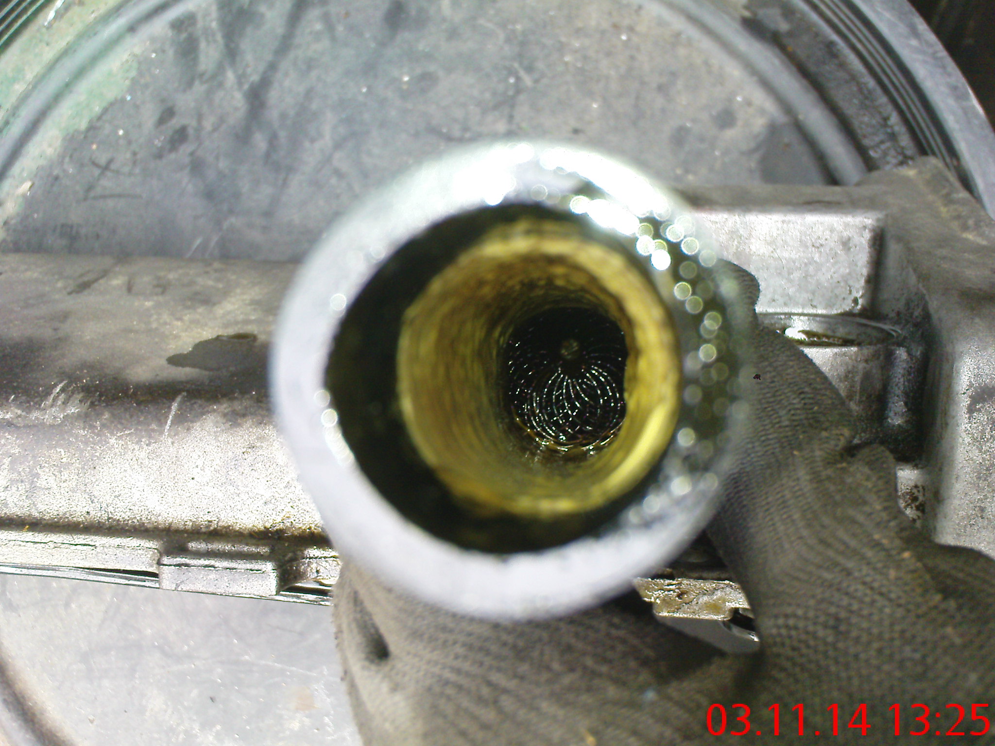

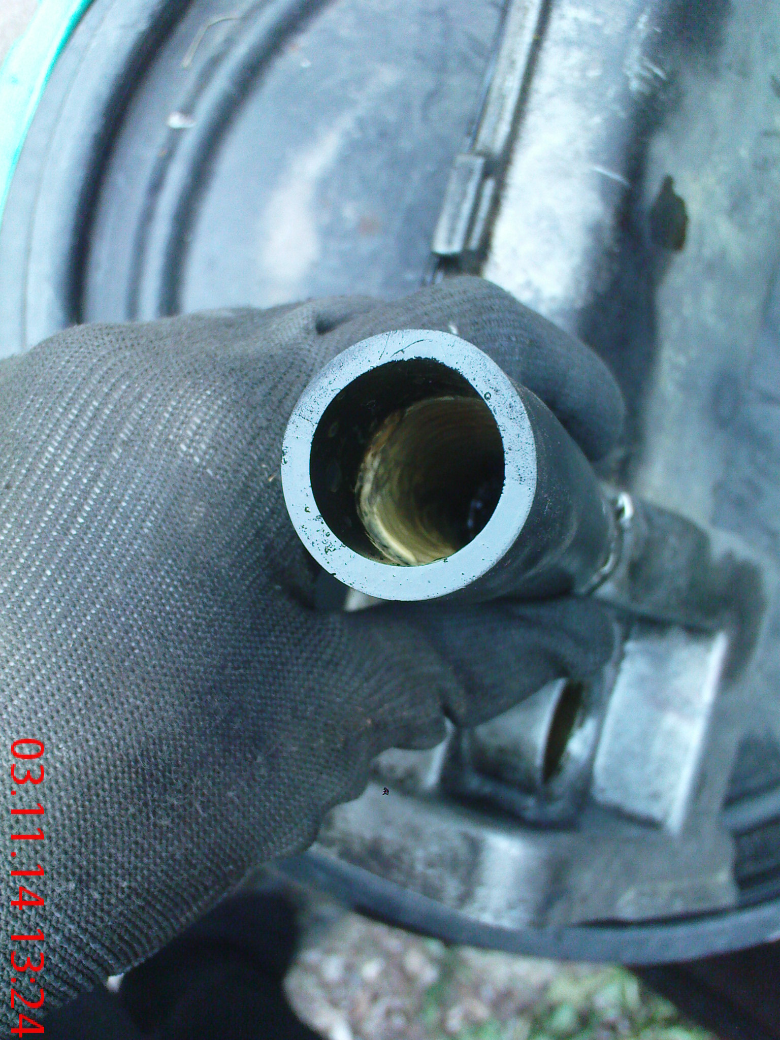

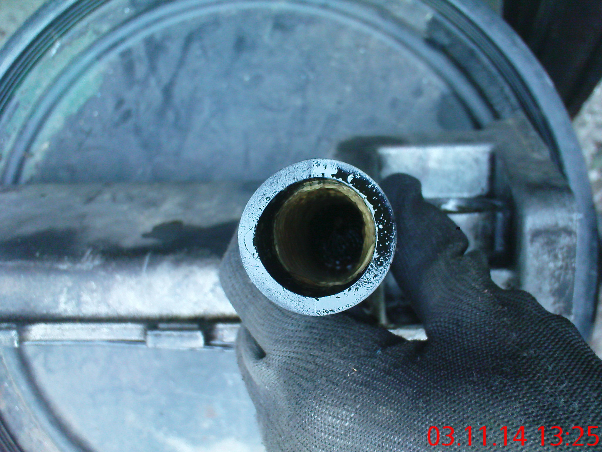

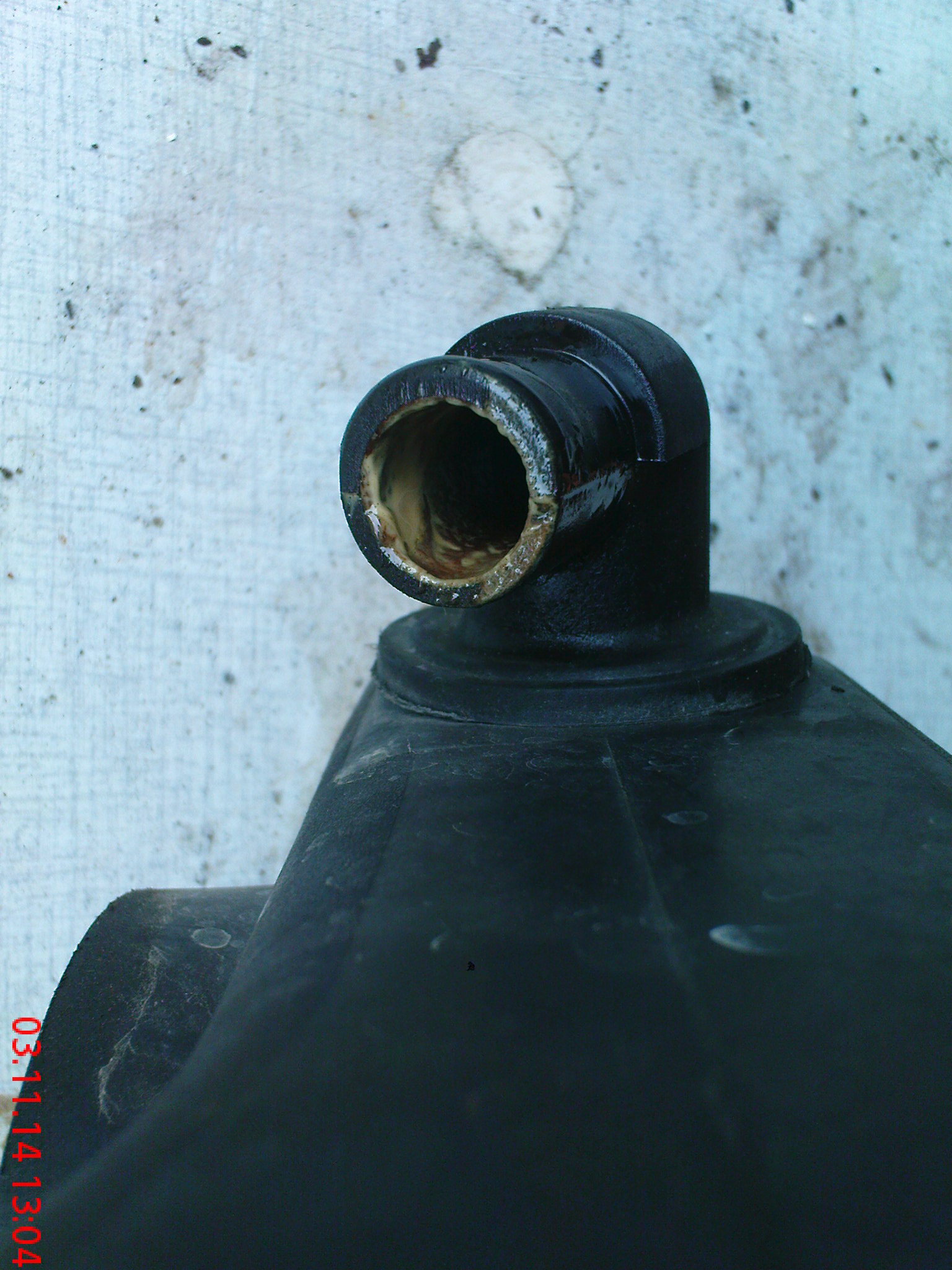

Nice pictures, but I can't figure out what parts of punto mk1 they represent. Is this a oil system or coolant system mayo?
last pic is air filter plastic housing, other pictures are a pipe that attaches to cam cover and goes inside air filter box

OK the mayo may be normal so not indicating any head gasket issue.

The link between mayo and HG issues becomes more tenuous the further you get from the sump. Short trips increase the chance of mayo even in a healthy engine as one of the by products of combustion itself is water (which is why you see water coming from exhaust pipes on cold engines, even on cars without a cat).
what do you consider short trips i make 10km one way trip every day
