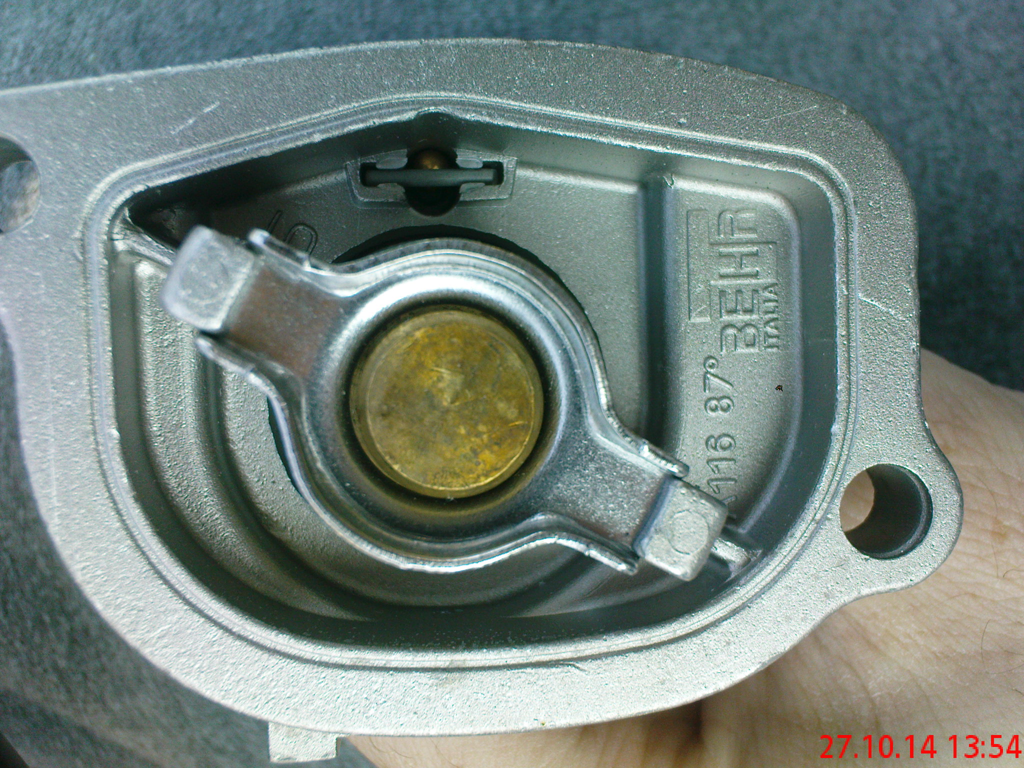

eaten material around thermostat bolts
original termostat fitted but still got this problem

I will start suspecting the head gasket if you get symptoms like this.
I'd get a real thermostat (new one) and use some RTV on the gasket. Points to acid in coolant (either no anti-freeze or never changed and combusion gases getting into it, turning it to acid).
I still think you have some air in there.
