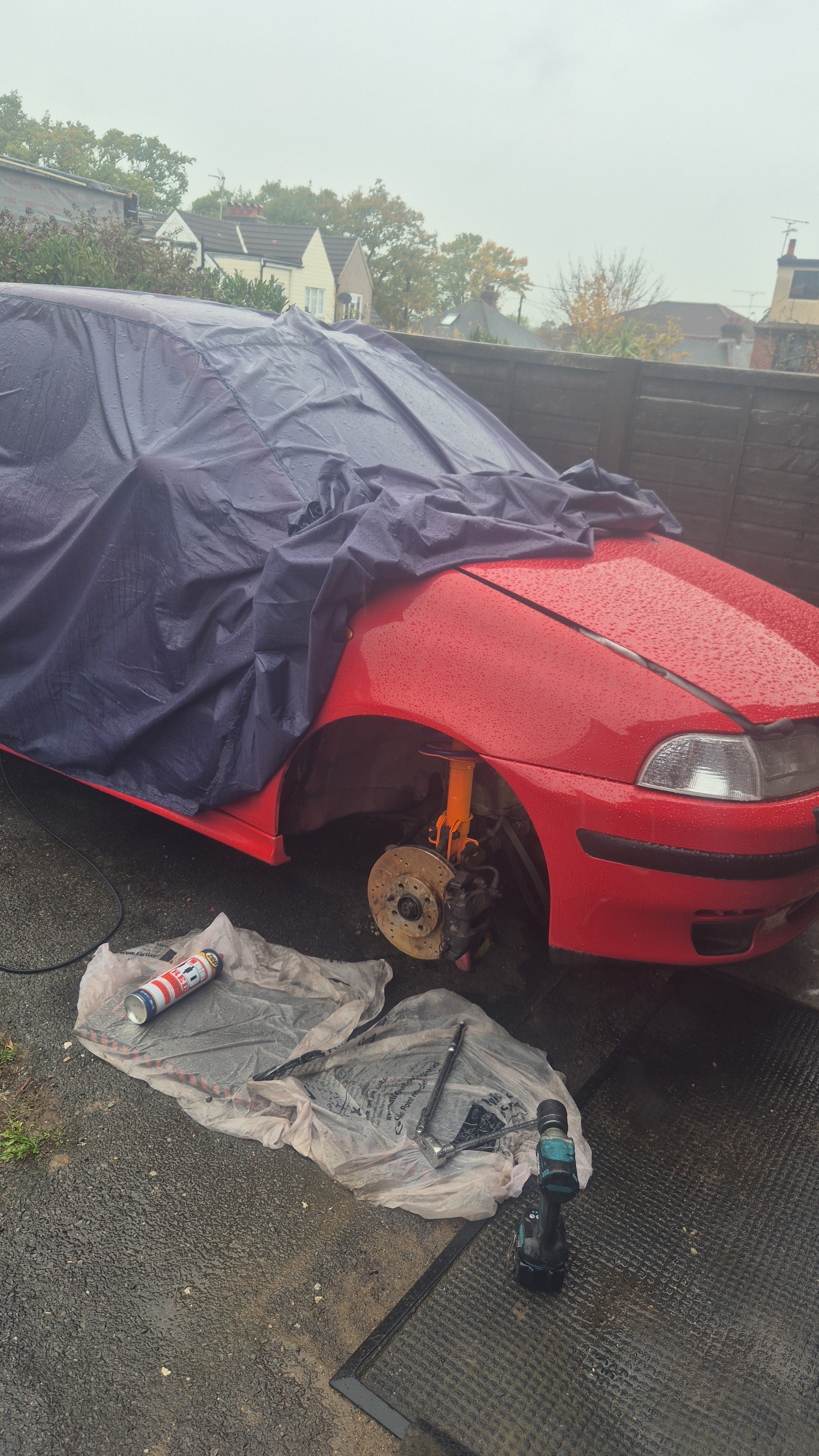

Today I even checked the timing in the rain 🌧 to make sure the crank pulley hadn't slipped on a worn woodruff key but its spot on..
