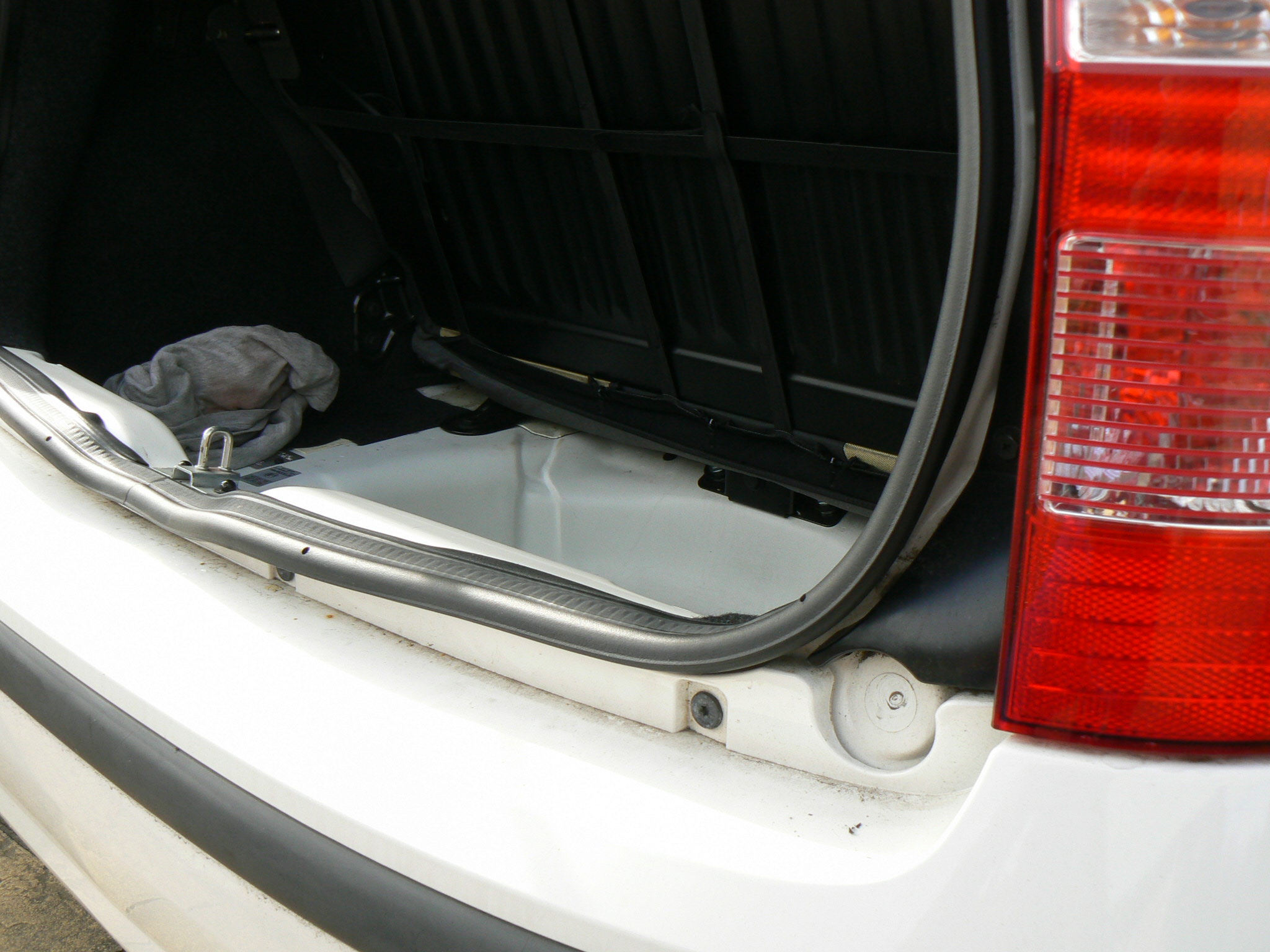

I had a really good look and feel round the boot and under the rear seat. Below the rear window seals etc, etc. All dry but as I was doing this I quickly noticed that there was water around the lock fitting and a small drop further down the panel inside the boot. There were also "witness" marks on the inside of the panel around the exit "flapy thing" which lets air out through the rear panel which indicated that water had been running down from the area of the lock
At first I though water was getting into the rear hatch somehow and running out through the lock to dribble down the inside. Strangely though, although the parts you can see in the pictures above were very wet there was no sign of water on the lock in the hatch or any sign of water leaking from inside the hatch. OK. Maybe it's something to do with the seal? So I carefully pulled the seal off all along the bottom of the aperture. Starting just to the right (Off Side) of the lock I was immediately greeted with wetness.

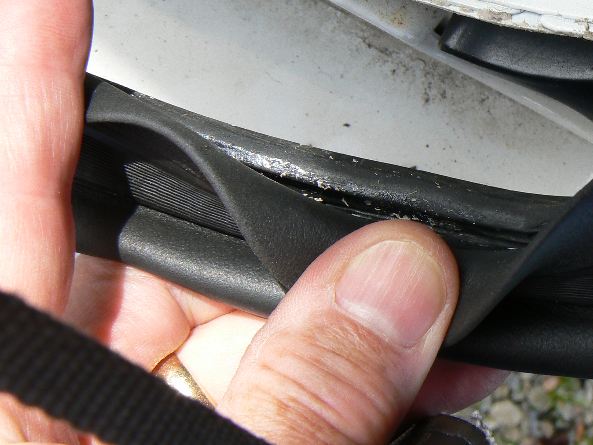

If you look carefully you can see that there is dampness to the left of my thumb but not to the right of it. This picture was of the seal where it fits in the bottom right corner Continuing to pull the seal off until I had almost half of it off, up to about a foot vertically on the left (Near Side) and almost to the top on the right (Off Side) - because that was the side where the water seemed to be - it was obvious that water was lying inside the section to the right of the lock but not to the left or any higher up the sides. The inside of the "U" section of the seal was very wet as was the flange on the body, but only that bottom part, from the lock to the corner where the seal starts to go vertical. Oh, hello, do I see sealant in the bottom of the "U" section of the rubber seal?
Looks like glazier's putty? And not very much of it either. As I look round more of the seal I've already pulled off I can see further evidence of it. Looks like someone else has been in here before me chasing this leak.

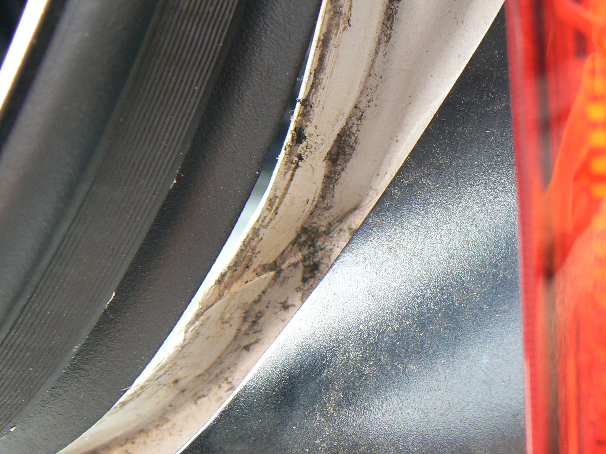

If you look just to the right of the flange you can see an overlapping panel joint which runs downwards towards the left and is not completely flush so forming a very small "groove" through which water can run from the outside to the inside of the "U" of the seal. Interestingly this is where the wetness starts which you can see in the picture featuring my thumb! I'm about 90% sure I've found it now!
But why doesn't the other side (Near Side) have the same problem? It's completely dry and there is the same panel joint? Look carefully.
The joint runs downwards towards the right so it's encouraging water to run towards the seal isn't it? well yes, but look at the witness marks (black) where the seal has been gripping. Continuous right through the area of the joint isn't it? Which seems to indicate that the seal deformed enough to effect a seal but also, just to the left hand end of the joint is a depression (it's clearer with the naked eye) which is not there on the right hand side joint, which I think will be encouraging water to flow down and away from the "groove" of the joint?
So what to do now. Well I think it's highly likely the water is getting behind the rubber in that right hand corner and then running along the "U" section to reappear at the lock where it's then running down the inside of the rear panel to collect in the wheel well. The person who tried to cure it before me had the right idea but maybe didn't actually isolate where the leak was as he/she applied sealant all round - or maybe just decided to cover all the bases? Also nothing like enough sealant was applied and the sealant itself was not the best choice and unlikely to be effective. I intend to use Geocel "The Works" which can be applied to dry and/or wet surfaces. Not the cheapest but wicked stuff! Just hope I don't have to remove it later!

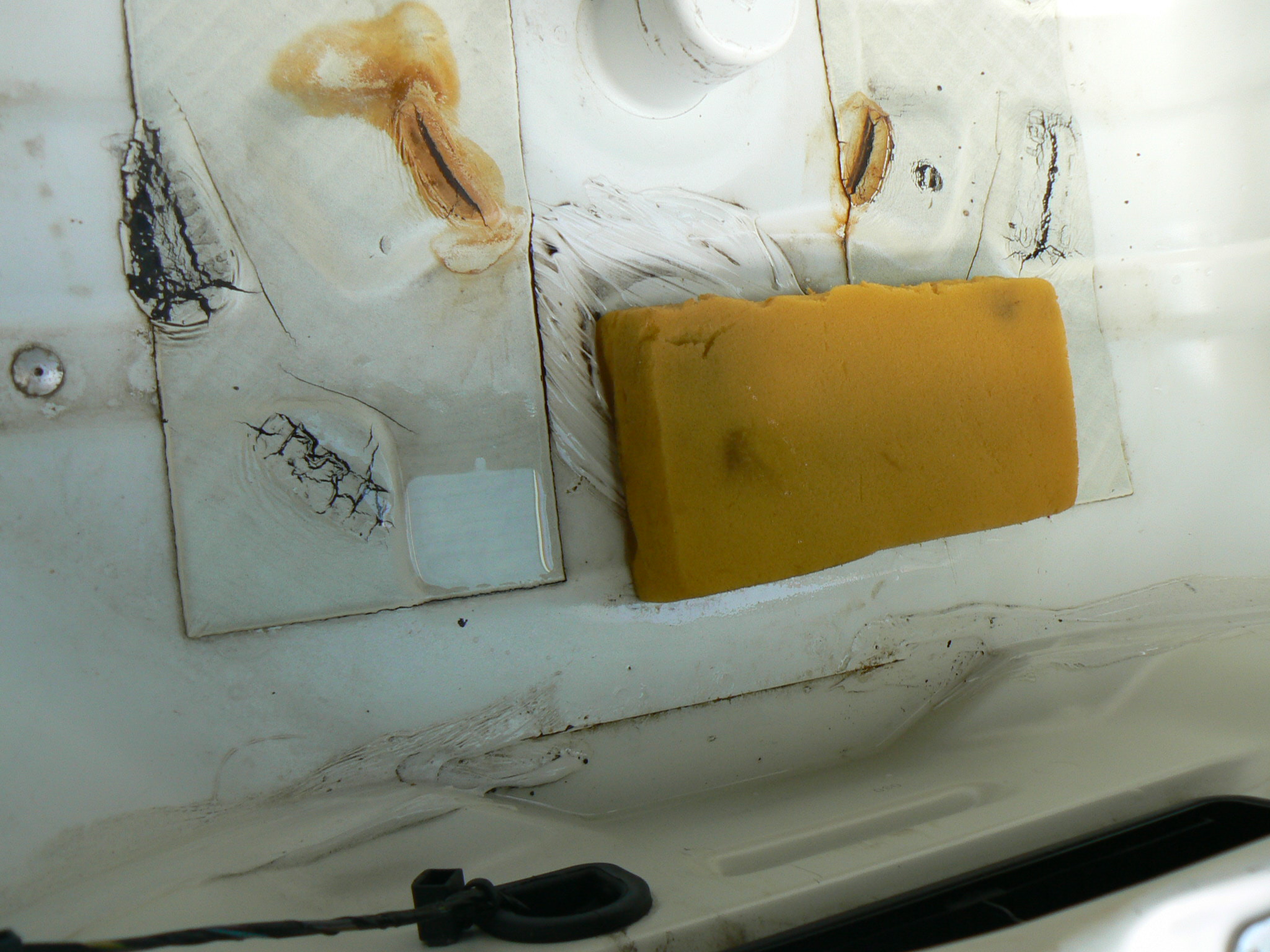

So, pulled of the seal up to about the level of the back window, both sides, and again, as I originally reported in earlier post, there's wetness, inside the "U" section, from that seam joint on the OS down to the lock. Nothing on the NS or higher up. The water's got to be getting past the inside of the seal, at that seam and running along. The "U" of the seal is completely dry higher up so, with the bottom two thirds of the seal pulled off already, I repeated the cleaning and drying up to the level of the back window and injected bathroom silicon (left over from recent reseal on the bath) into the "U" section of the seal and pushed it very firmly back onto its flange. Surprisingly I seem to have used just the right amount of sealant as it "squished" out just a little but not too much and with Becky being white it blends beautifully!
As I was inspecting my handiwork I noticed the air flap valve which is on the rear panel of the boot, just above floor level. I ran my finger around it and it came away wet! I think this is almost certain to be water that has run down from the seal above it but, as this fitting proved easy to remove (four little plastic clips) I did so, cleaned it all up and sparingly applied a little of the sealant to the foam seal around it's perimeter before refitting it.

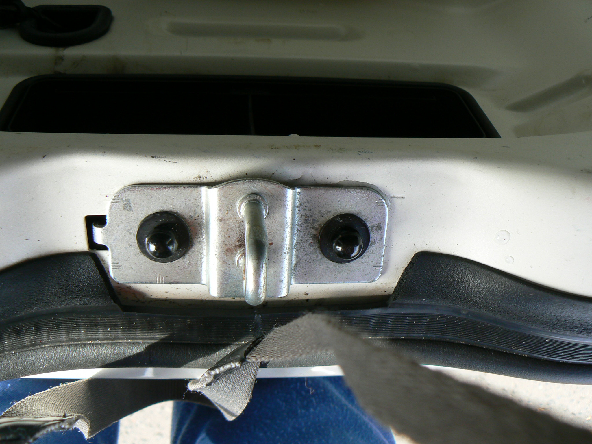

Finally, just as I was about to walk away, I remembered that I had noticed the seal was not being compressed quite so much at the bottom than at the roofline. Winkled out my trusty 10mm socket and "T" handle, slackened off the hatch striking plate and adjusted it inwards slightly until the hatch, when closed, is compressing the seal evenly all the way round. Gently fully tightened the two striking plate nuts. The immediate and unexpected result of this is that the hatch, which previously closed with a bit of a rattle, now closes with a quality whump and no rattle!
So now I suppose it's a case of standing by, with fingers crossed, and waiting for the next rain storm (sure I won't have to wait long). Feeling quite confident though that I've probably "got it". Oh please let it be! I really don't want to have to clear off a whole lot of solidified silicon sealant! Hopefully I'll be able to report a happy outcome, within the next week or so, to close this thread.
