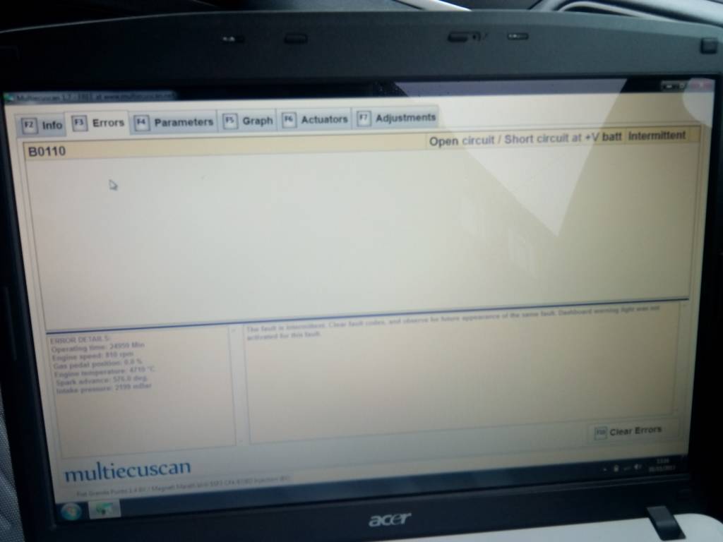

B0110
THATS THE CODE :)
Something to do with battery
When I bought the car the battery was flat annnnddddd the caps are missing of my battery1383312777786.jpg
