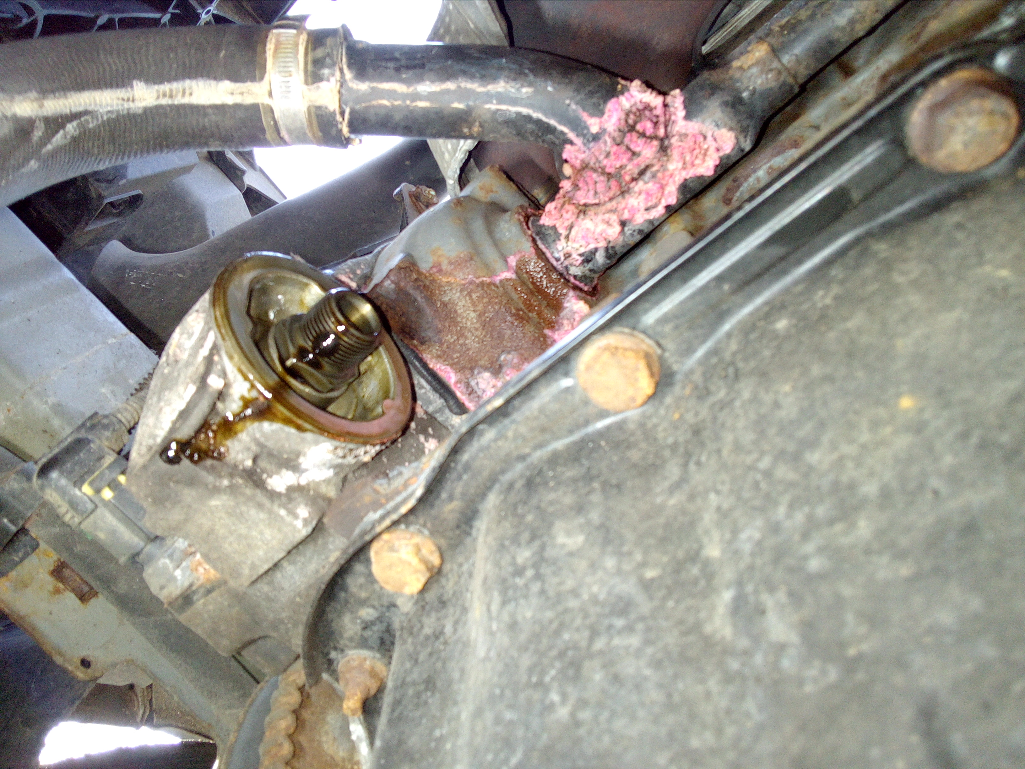

Sunny dry day and 10C so just serviced the Punto and changed the Oil Pressure switch. The orange triangle light now goes out just after starting the engine whereas it had taken two or three starts to extinguish it before.
Pressure Switch was a Borg & Beck MPN: 11995263RMP which I got from eBay seller PARTS IN MOTION. PS: You'll need a 22mm open ended spanner to remove/fit.
With oil filter removed I can now see where my slow water leak is coming from so another job to do. The joy never ends.
