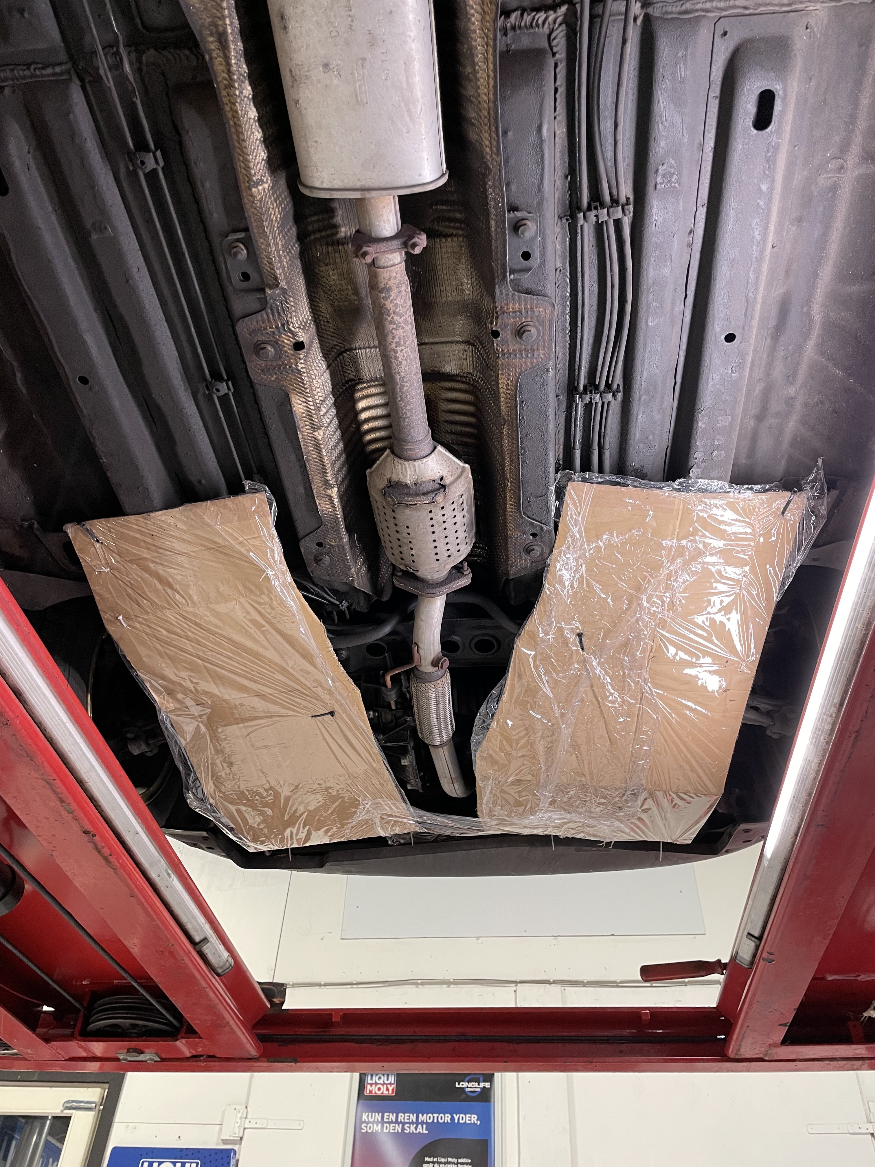

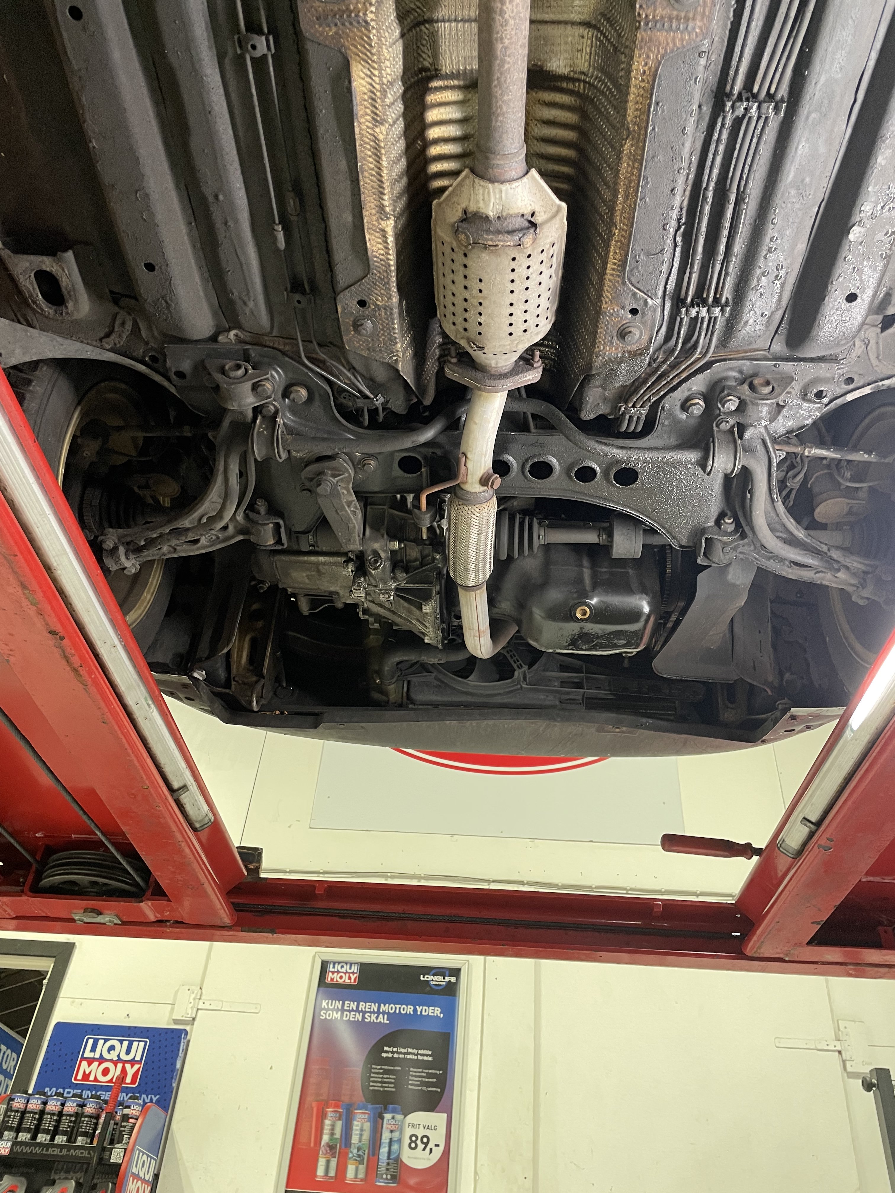

I live up in Scandinavia where it gets quite cold, my car's heater has a bit of trouble to keep me warm when I'm driving, but it does warm up when holding still.
I made this temporary skid plate and found out it helped keeping me warm. Does anyone know how to get a proper skid plate or know any other trick to keep the engine warm in the winter?

With the age of the car you'd probably have to make your ownid get a good template made out of cardboard the look to a local engineering/lezer cutting firm to make one out of sheet steel/aluminium then get a few holes swaged into it for extra strength

My heater core was burning hot when I installed that skid plate.
Thinking logically, blocking the radiator shouldn't be doing much since the water inside it wouldn't recirculate to my engine when the thermostat is closet and the air flow is being limited by the fan and radiator.
I'm thinking i need to do something directly to the engine. Like make a shield on my exhaust manifold that both keeps warm to the engine and block air from radiator. Maybe cover the engine with some cloth of some sort?

The radiator thing, well thats pretty standard procedure for cold weather climates, the aim of blocking the radiator is that when the stat opens the rad doesnt cool as fast, the cooling system is a feedback loop if you think about how it works. When the stat opens water rushes through the radiator and cools, back up through the water pump and through the engine and then hits the stat, its only at that point that the stat will react to the change in temperature. So if its really cold it can cool it the coolant so much that once it goes through the engine and hits the stat and shuts it, it has already cooled the engine down further than you might want to. So by blocking all or part of the rad off, when the stat opens and goes through the rad it doesnt cool as much and in turn doesnt cool the engine as much going back through - should result in the engine finding a sweet spot when the stat isnt going open and snapping shut as cools and repeating and you'll get a steadier more linear temperature. Block too much and you might find it starts getting to warm, don't block enough and it will have no effect. Remember its a metal box containing many explosions a minute, it just being cold outside isnt gonna make it stay cold, it should have zero problems staying hot..
I've seen this method used countless times on cars and lorries in cold weather, never ever have i seen anyone basically put a blanket round there engine however..

I live in Helsinki. My car is the mk2b punto. There is an engine guard for that car which you can probably modify to fit your car. You can still get them new in the after market online. Mine has survived since new in 2004. The guard also makes a difference to the sump which has never been rusty.
Edit: You can get them for your car?
