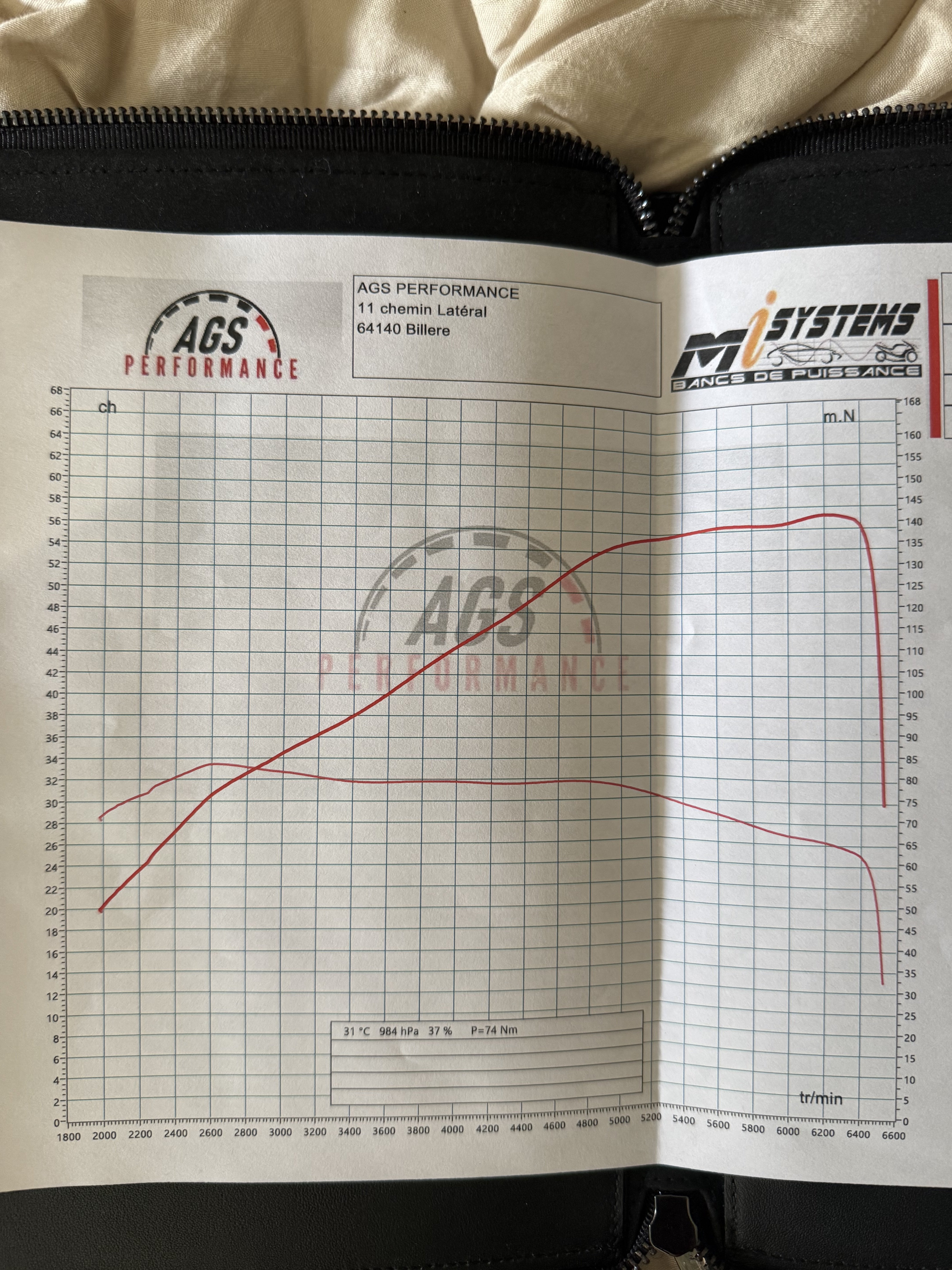

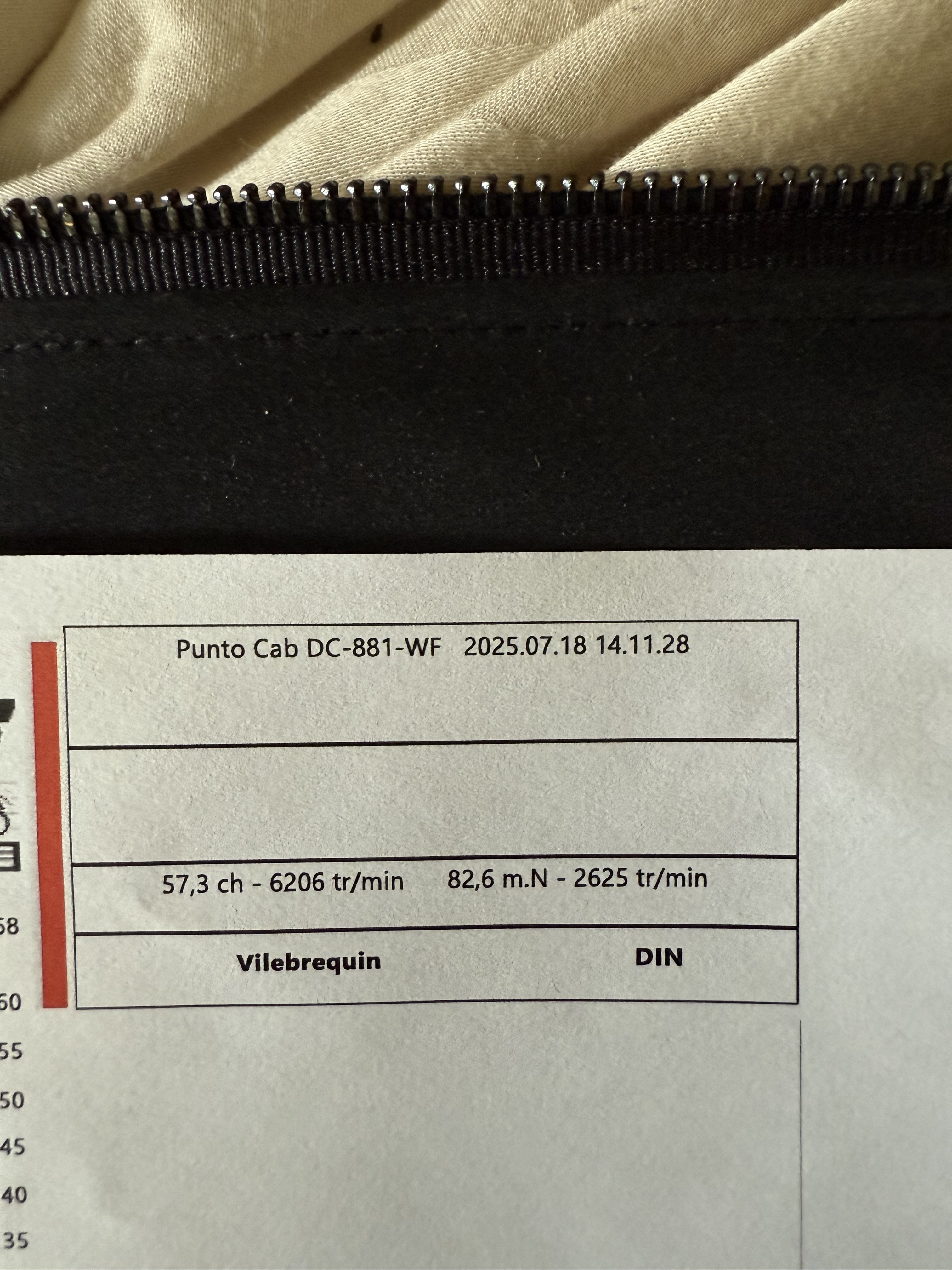

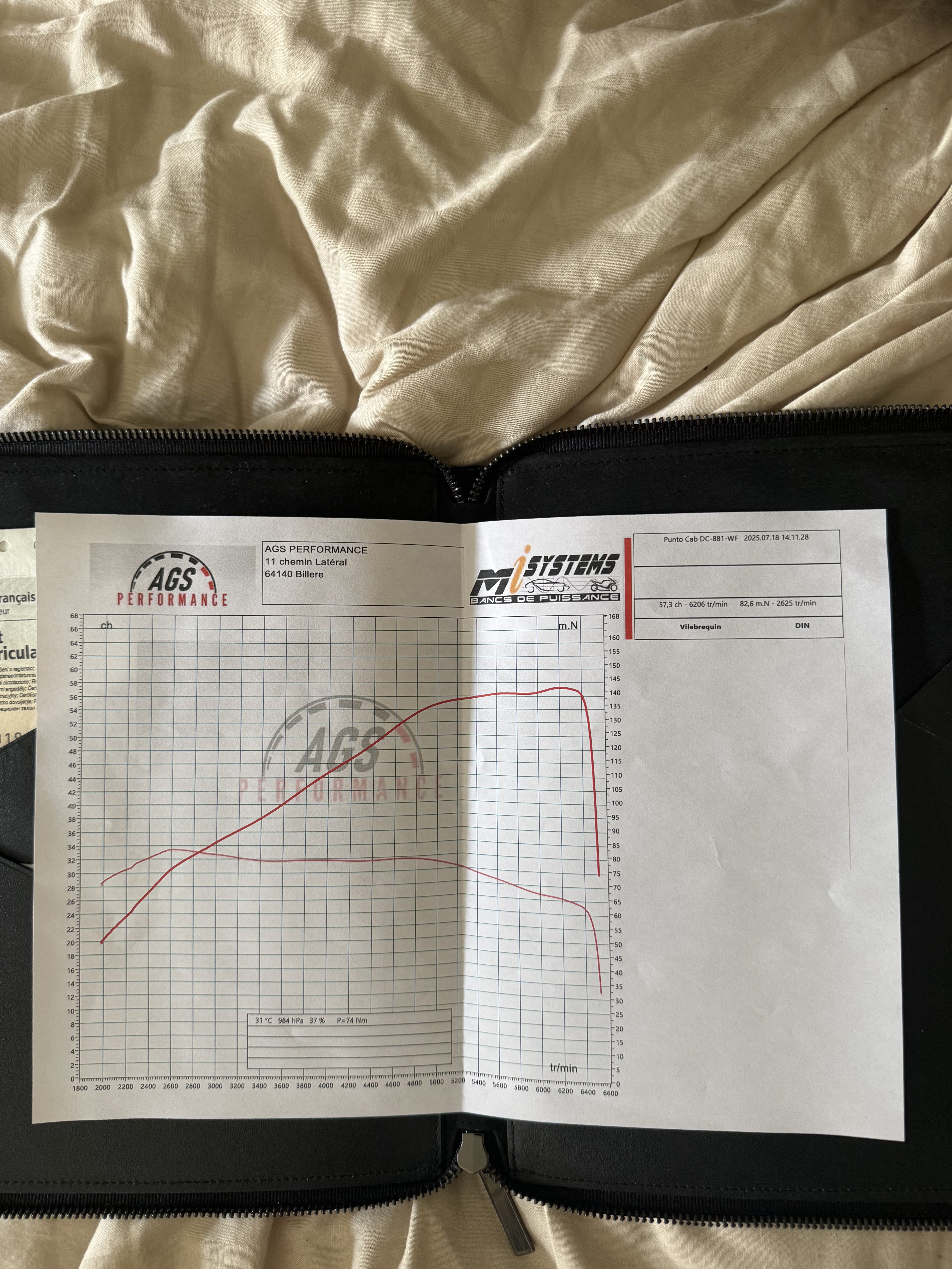

Hello everyone,
So I just came back from the dyno, and the results were astonishing, but not in a positive way lol.
For context, the flexible (exhaust part) is really damaged, like there is a big hole. I think it’s because of rust. Also, my intake hose is also broken so it doesn’t help.
Since I bought all the parts of the exhaust (down pipe, cat, muffler) I wanted to see the difference before/after the installation. After the cat, everything is stainless steel.
So I’ll put the video and the results in picture here for suspense…
The run was made in 3rd gear.
I mean… 57hp!!! It’s like the 1.1L, I was not expecting such a high loss.
I wanted to cry (I didn’t) but how insane it is.
And the volume of the car… AT LEAST 130dB…
So next thing is, I’ll install every exhaust parts next week.
I’ve ordered a K&N cone filter with hose that may arrive August 7th.
I’ll do another run, hope getting back the 30hp and even more 🤞

Yes it’s heart breaking.
Hope I can really get at least the 30hp back…
