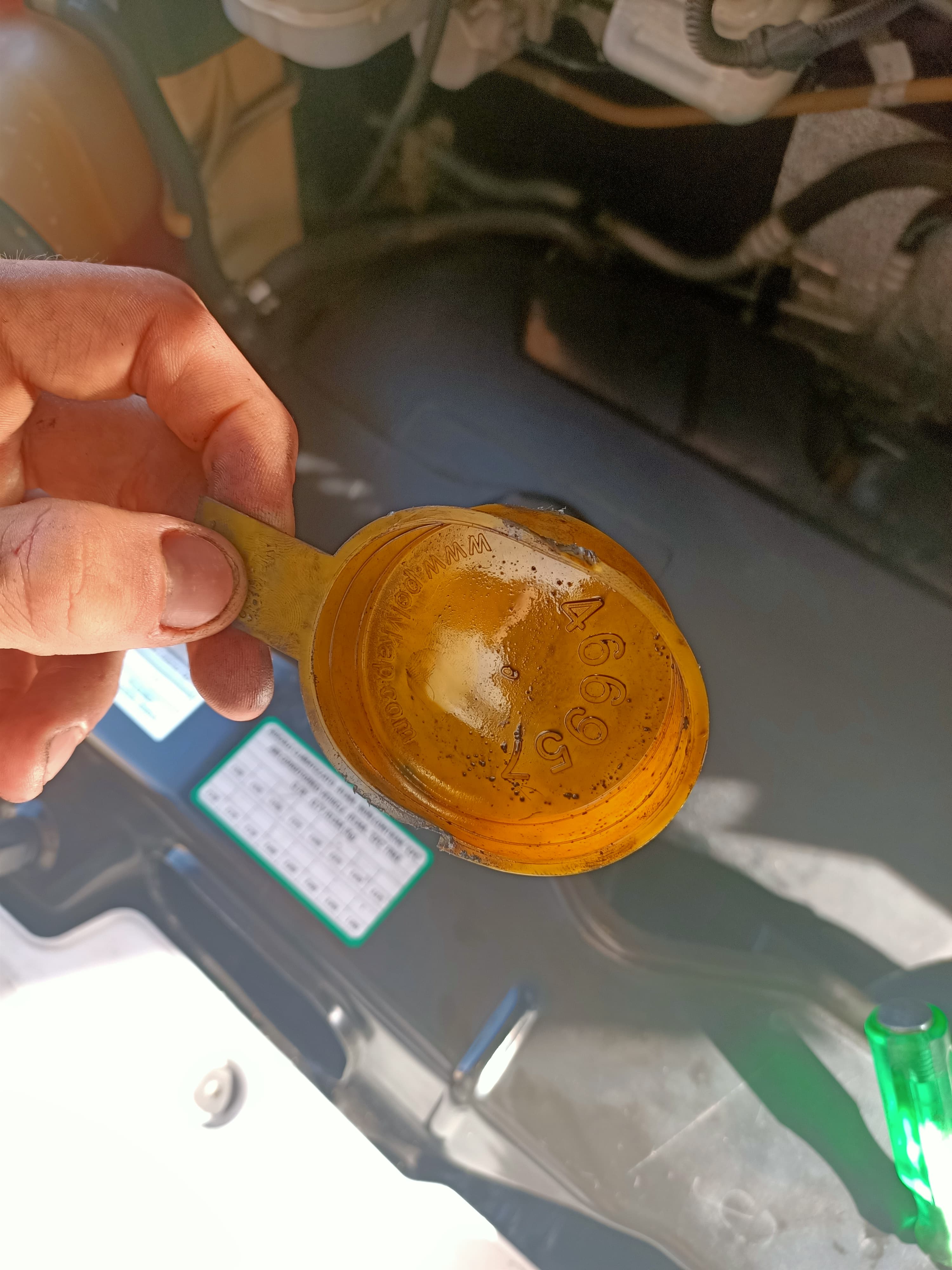

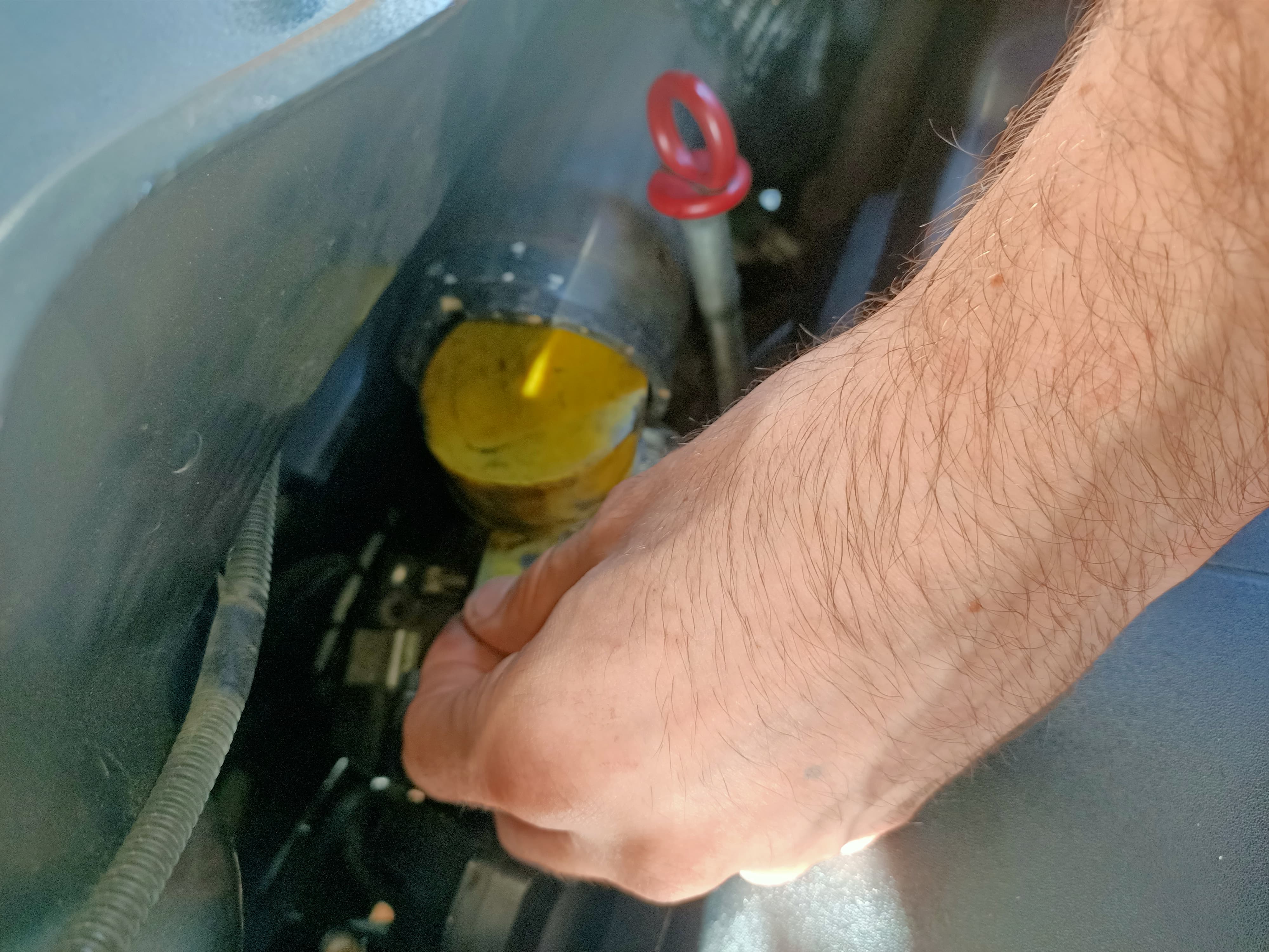

Ok this might be a bruh moment, but i was trying to solve it, thinking it might be an electrical issue etc (which it still may be)
and i remembered the clogged AF part and wanted to check further upstream to see if its equally clogged
anyway, i found a literal measuring cup looking mother****er lodged in this hose leading to the combustion chamber
wtf is it doing there... i believe it's meant to protect the hose off the shelf from dust and deformation but bruh... did the mechanic literally just leave the cap on and force the hose on until the cap lodged sideways in there... if it got melted it would have destroyed probably the egr cooler, egr valve and other **** too
bruh, wtf

That's astonishing. I think you are spot-on, that looks like a protective blanking cap and the "mechanic" hasn't realised it's supposed to be removed before assembly. Doh !
