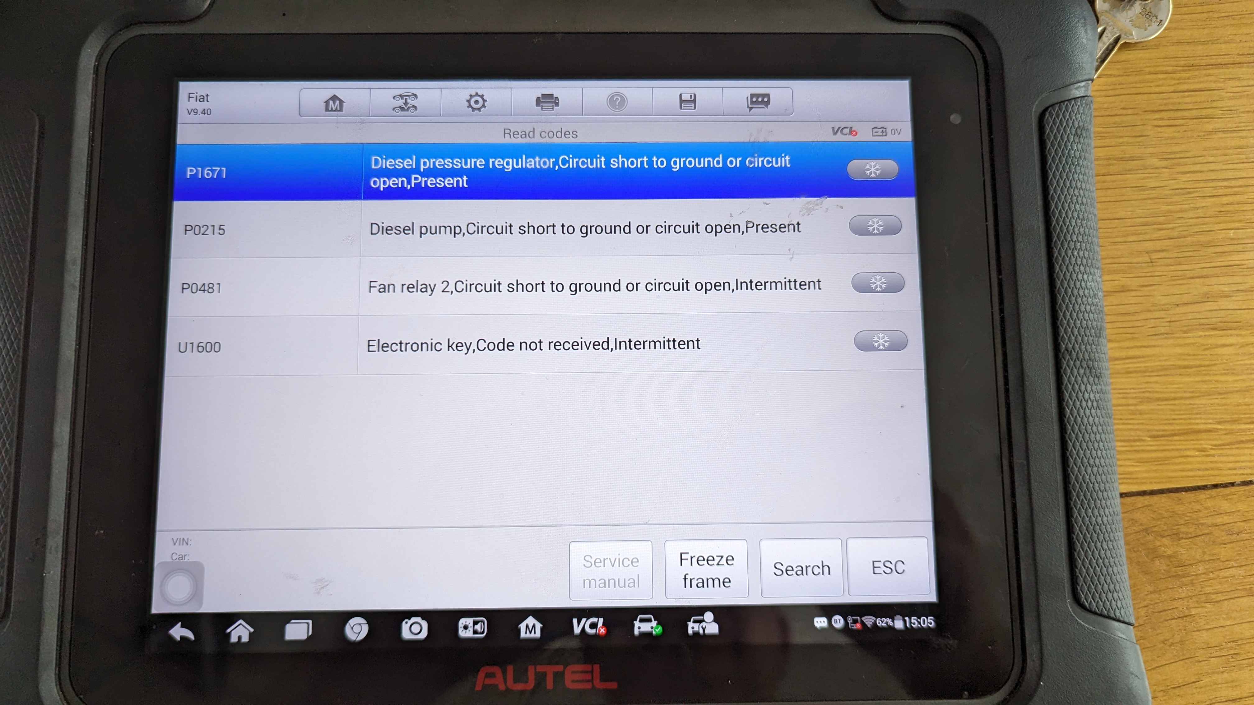

This is what's currently showing up both before and after replacing pump ln fuel tank.

The first 2 codes are the problem.
Nether of which have anything to do with the in tank pump.
P0215 description on that code reader is not very clear.....I think it refers to the main injection relay.
Surely this U1600 error code relating to immobiliser needs fixing first.
As mentioned in earlier thread."Not helping with battery voltage low, but seem to be as suspected immobiliser /key issues.
Did diagnostic bloke make any suggestions?"

My advice is if unable to find a good mechanic, would be to show/tell a reputable ECU specialist the latest codes read on the AUTEL tool in particular, if that code read was recent, the "U1600 electronic key code not received" one and asking him how much to program the immobiliser out of the ECU and what instructions you need to follow.

Latest diagnostic
