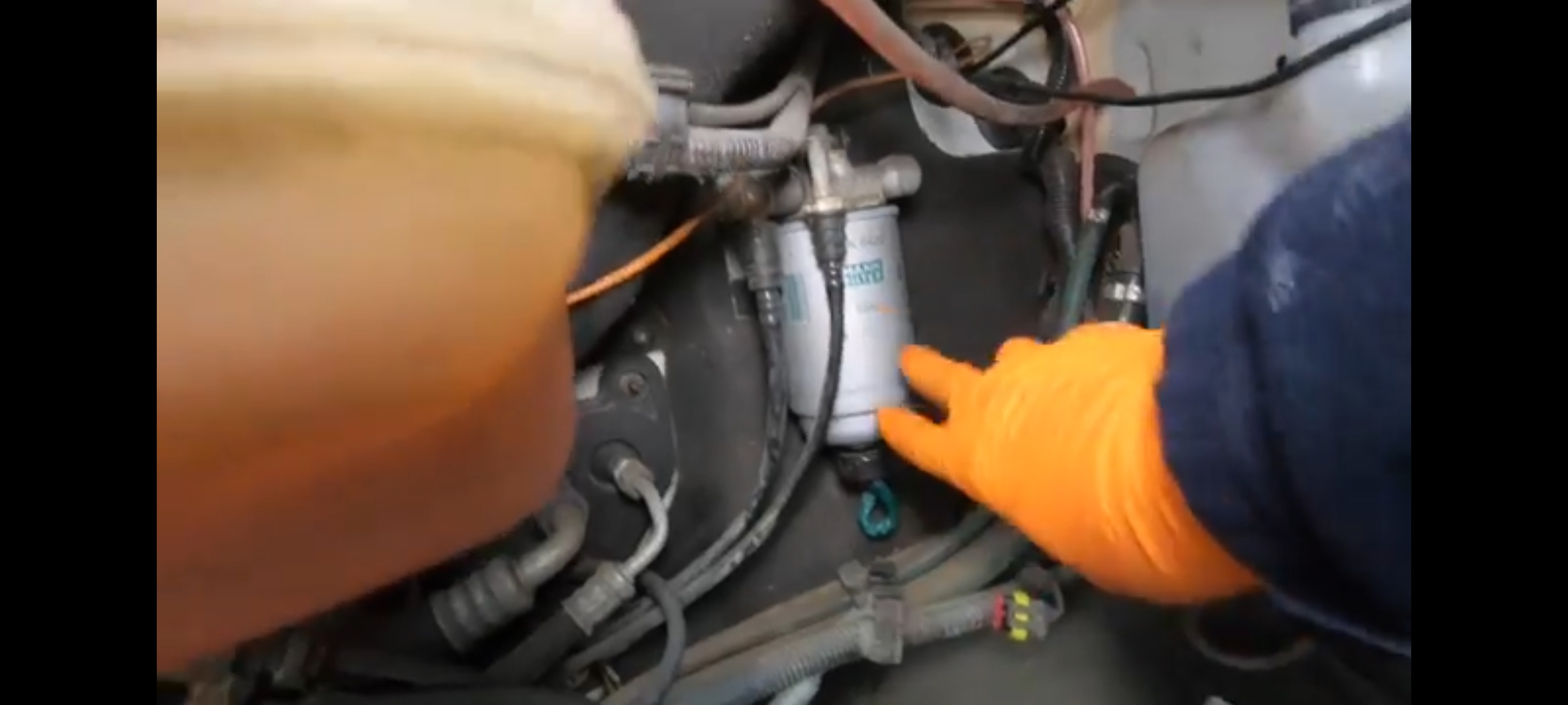

Does your fuel filter look like this example ? Black button is priming pump, but you will need to bleed air out. With the linked type of filter the pump diaphragm can harden and crack with age. A new filter top would be required.
You will not find an OBD port on vehicle like yours, with mechanically controlled injection.
Hi.

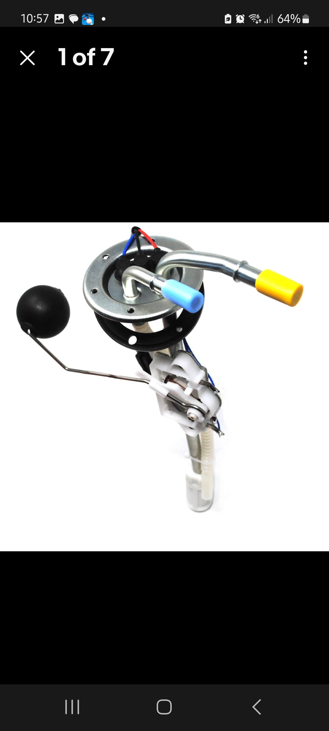

Not it is not the same, its a metal canister with water sensor at the bottom looks like one in photo attached. As my sender unit has seem to have died it has 2 fuel pipes on top a supply and return I wonder if this has caused the failure .I would guess the pipes are just going into the tank grabbing at straws me thinks
Thanks in advance. Ps Also photo of sender unit to fit van.
