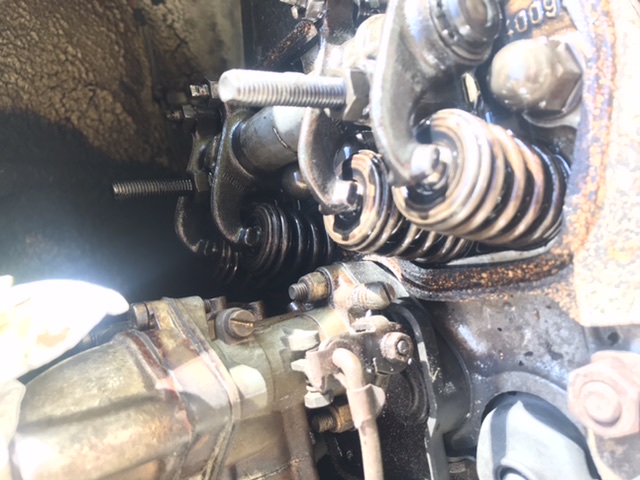

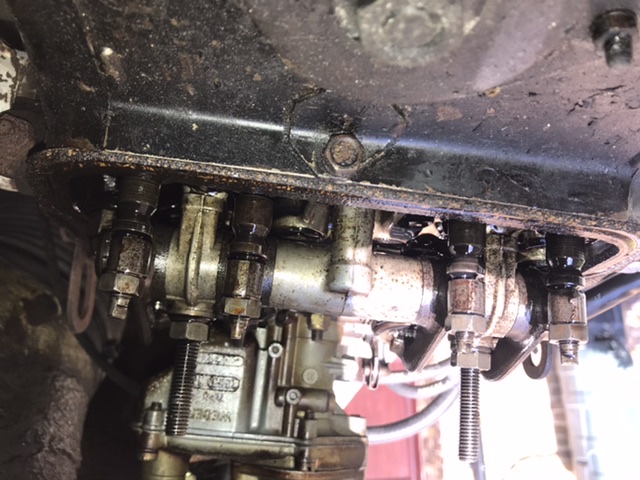

When one rocker arm goes down is it normal that it will then stay down for a while while I turn the fan belt wheel? I’m turning it very slowly and the arm stays down for a little while before moving back up. Not sure if I’m doing it right but if I am then the valves are way too tight. Rocker arm 4 just went down and a 0.015 inch feeler gauge doesn’t even come close to fitting in the gap for valve 1
Sunlight isn’t making photos easy here but attached is a photo of what I think is the 4th rocker arm in a down position.. seems pretty similar to the others but it won’t go down further.

When you come to adjust the tappets the easiest system is "1 more than there are rockers" Therefore, with the 500/126 engines which have 4 rockers, the number you are looking for is---5. When rocker 1 (nearest the BACK of the car) is fully down you adjust number 4 (1+4=5)---when number 2 is fully down you adjust number 3 (3+2=5) etc, etc. The valves WILL stay down for a short period of time. It will be made a lot easier if you remove the spark-plugs when adjusting the tappets. The feeler gauge should be firm "pull-through" when the clearance is adjusted correctly. If you set them to 8thou. for the inlets (rockers 2+3) and 10thou for the exhaust (rockers 1+4) you will be just about right.
Well surprisingly I didn’t break the car. The valves were so tight so I corrected them and took it for a test drive and it ran very well. The hesitancy issues weren’t present all the time, they’d come and go, so a few more test drives needed to make sure I’ve sorted the problem.
