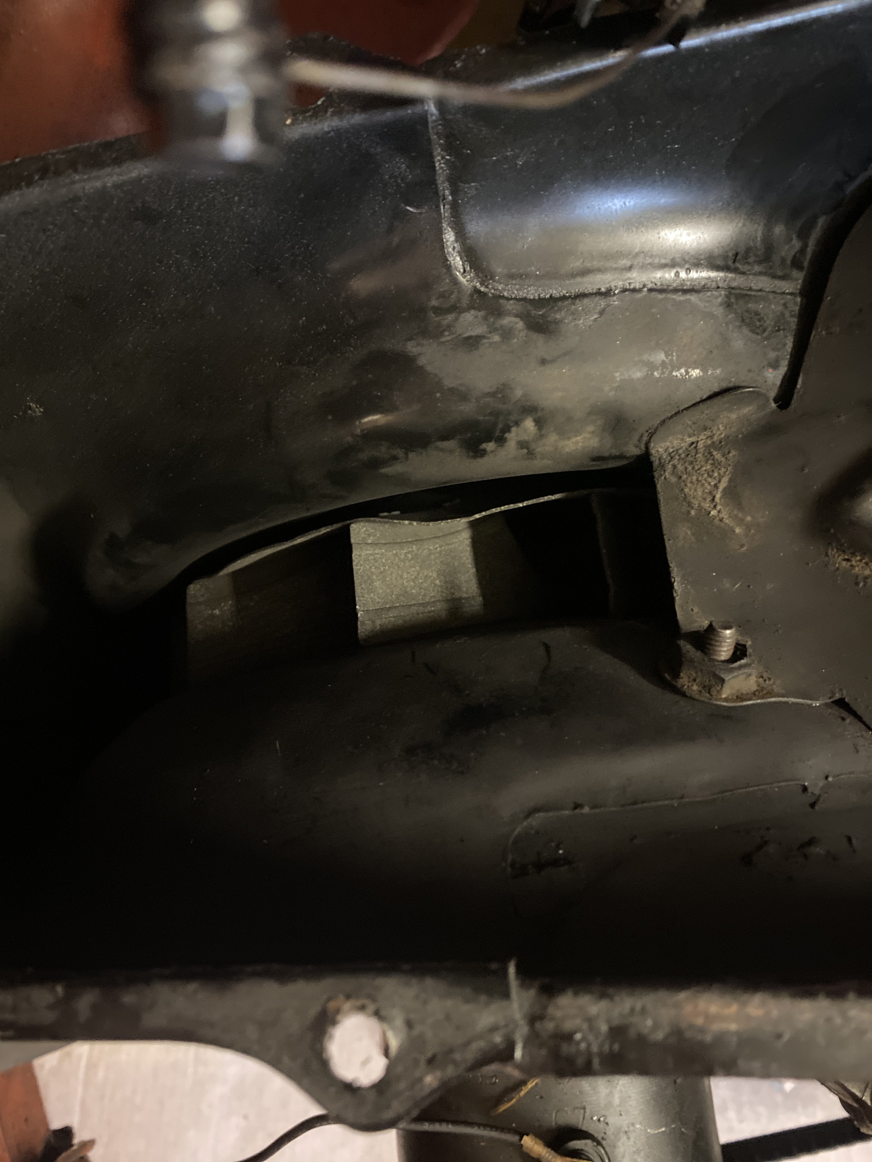

When you touched the vane on the fan did I detect a rattle in your video? If so it is on the verge of failure.
also re heat expansion you are looking on the cooling side of the engine so that will not be a factor.
When I turn the engine the fan scrapes the bottom of the housing. The picture shows which part of the fan hits the housing. It looks absolutely terrible. I’ll replace it
