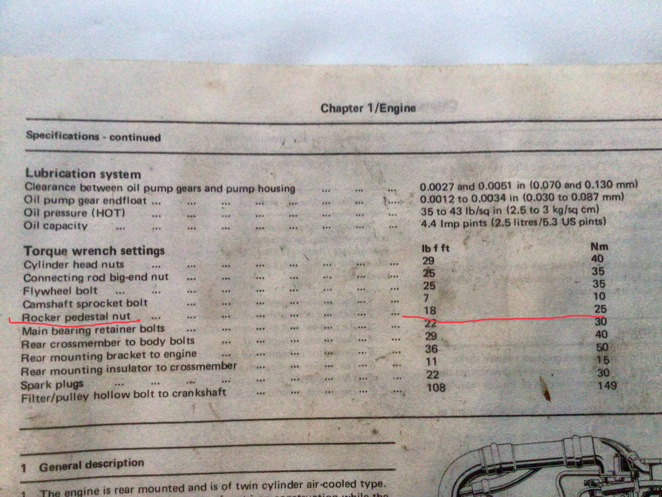

Agreed! Any idea what the torque tolerances would be on the two 13mm nuts that secure the rocker shaft? I can't seem to find that in my factory manual. Thanks!
