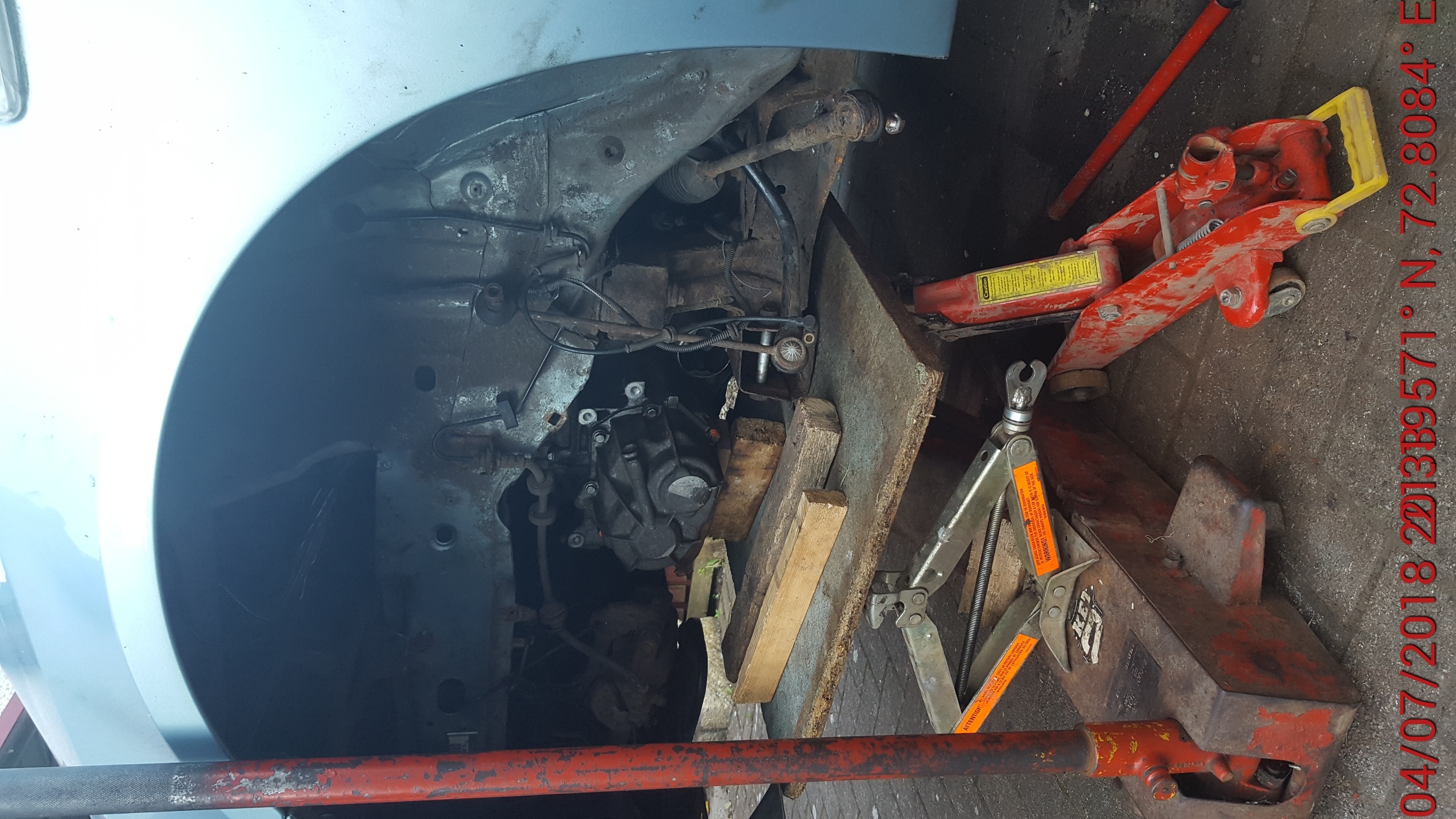

Nearly in.....

Hi guys
Got the gearbox back in (all the bellhousing to engine bolts are in but still to secure it to the two mountings). But I'm a wee bit worried that I've cocked something up. The lever thing shown in the photo which is operated by the slave cylinder(? again apols for the non tech speak) has little or no resistance when i move it back and forth (I've not got the slave cylinder back on yet). Tbh, think when i took the slave off before removing the old gearbox the lever was like that also, but can't remember for definite, and i can't quite work out whether it should or shouldn't be like that. Very much appreciate any comment on this.

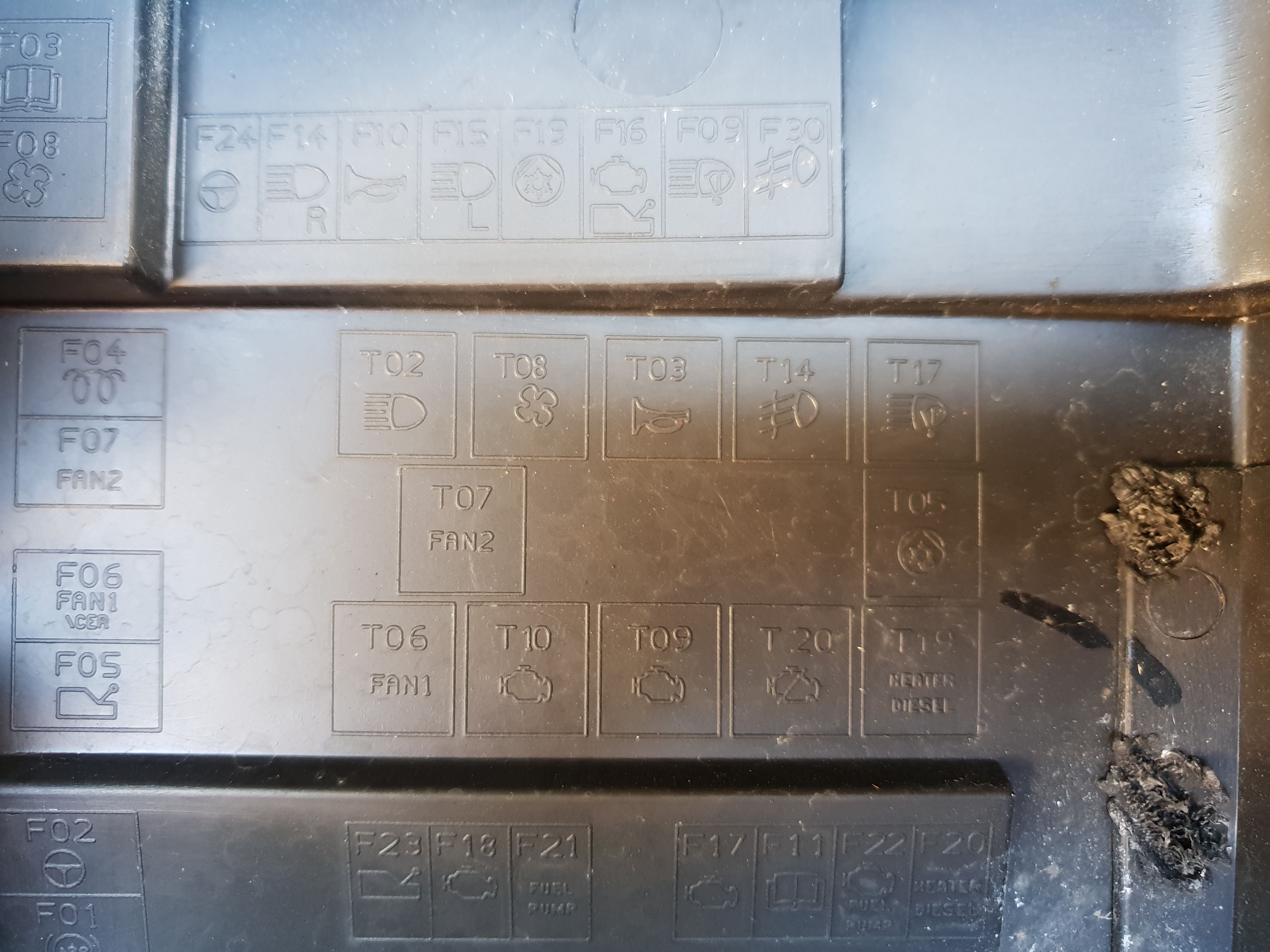

Have you replaced the black master fuse board on top of the battery? According to the wiring diagram, there should be a red 125 Amp fuse next to the orange 150 Amp one. It looks as though there's never been one there in your picture.
The 125 Amp fuse supplies the ignition switch (H1) via the 20 Amp maxi fuse (F3, the large yellow one in the grey fuse box). If there's no power to the ignition switch, then the starter motor won't engage and turn.
Check that you have 12v both sides of fuse F3 with or without the ignition switched on. There are test points on top of the fuse, so you don't need to remove it to test for 12v.

Hi Davren
No, haven’t done anything with the black master fuse board at all (except rumble it about a bit, along with all the other gubbins in that area, when taking out/putting back before/after replacing the gbox). So, given that the car was running fine without the additional fuse to which you refer, before she was taken off the road and after re-assembly, I was surprised that this might be a thing, but I will certainly do the tests that you recommend. I’ll also have a wee swatch at what’s on the other Stilo, which might give me a clue as to what should be. TBH, anything’s worth a try.
I’m also going to try a different battery in it (I’ve got a bigger, newish one in an old Volvo I have), to see if that will make any difference. The one that is in this Stilo is less than a year old and I’m fairly confident that its well charged up since the green light is showing on it and when I had it on the mains charger after a few hours the charger showed negligible charging input. But, who knows, over the last few months there have been extended spells when the battery has not been in use, so you never know, and I am aware that strange things can happen with Stilo electrics when the power input is a bit not what it should be.
In relation to my previous post, do you think that the clicky/buzzy noise from the two relays (which has now stopped, along with everything else), has anything to do with things? And if so, I was thinking that I could maybe swap them over with what I’m pretty sure are the same relays in other stations on the same board to see if that has any effect – on the basis that the two that were making the noise are located in ports which are designated on the battery cover lid with an engine management type symbol are important to the core functioning of the engine/system (?), whilst others are for less vital operations (for the purpose of this exercise, at least), like fans. Does that sound like something I could try, do you think, or am I way off track and talking bo*****s (as usual)?
