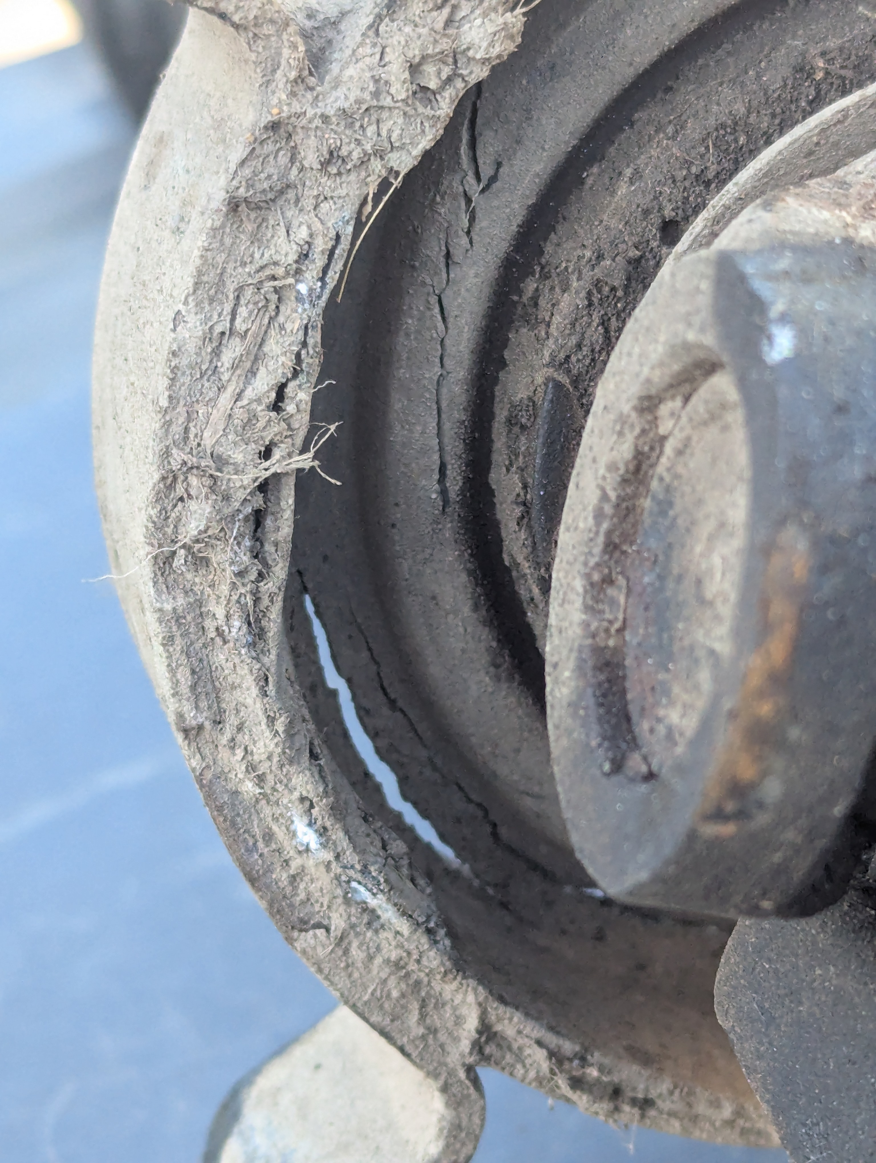

Hi
Twin Air cross... from nowhere knock knock through body shell when not under load
Power on fine
Lift off knock knock
Gear change fine
Prop shaft central bearing?
Help please
Not had this experience but it does suggest centre prop shaft bearing (assuming it drives in a straight line i.e not a catastrophic failure of a front suspension bush). Prop bearing is usually the bonded rubber surround that fails it seems. Should be able to inspect with the car on the ground and a torch to highlight anything untoward. I know there are pictures on here of a failing bearing (mount).

Here's one thread https://www.fiatforum.com/threads/panda-4x4-clonking-juddering.502664/page-2#post-4699775
Also do the basics, check wheel niuts are tight and that the engine mounts are sound, Check exhaust mounts and drive shafts just in case. Dont leave it though as DMF failure can be catasrophically expensive if not caught in time.

Ordered prop and will get it up in the air tomorrow
Came on from nothing to undrivable in 10 miles

Tough to get the cups out of the opposing flanges but otherwise all good
Replacement arrives Monday
