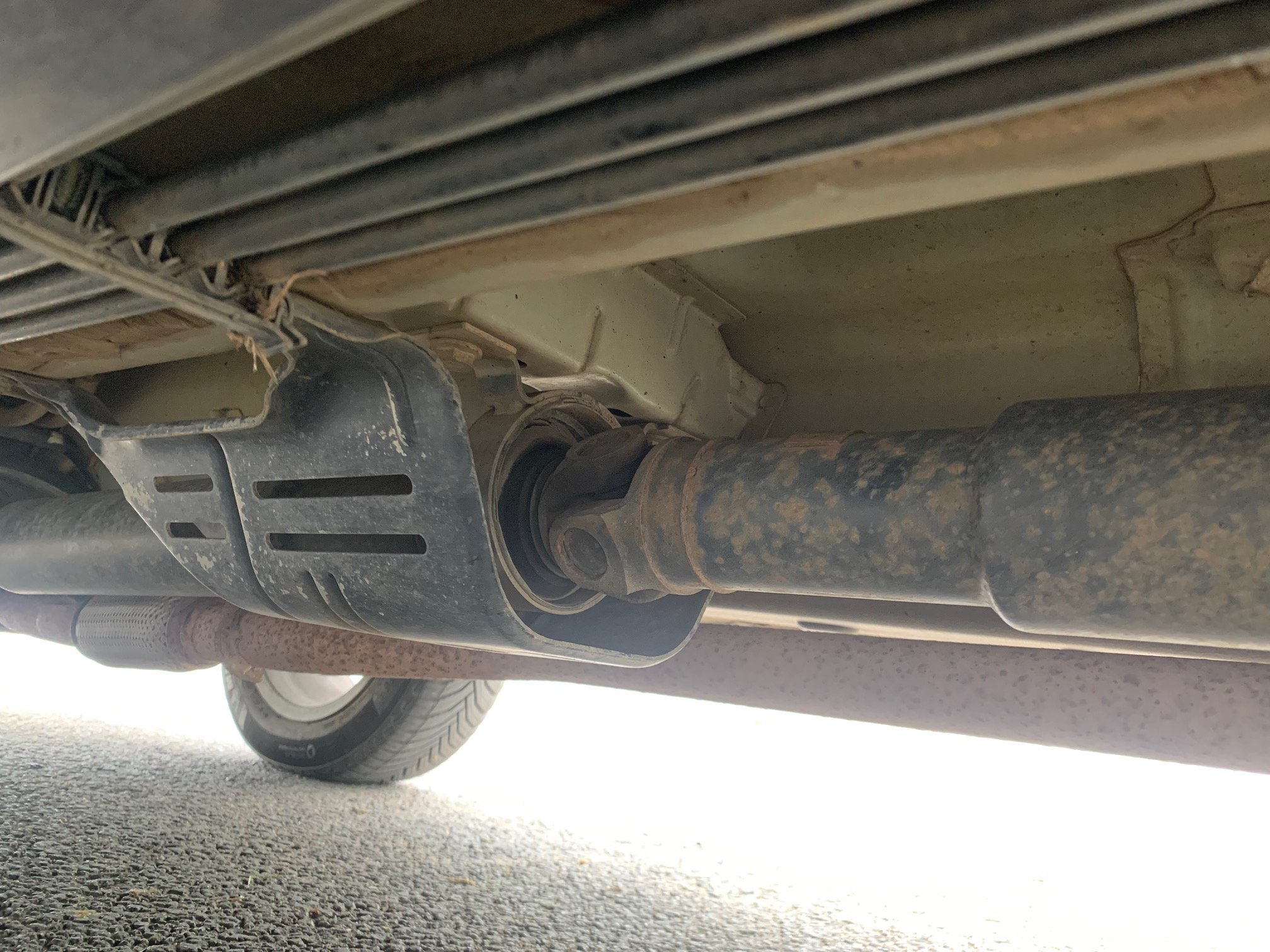

First chance to get under and have a look today. No dead 🐿️ found.
Pic of centre bearing attached, likely has been replaced as doesnae look that old, and rubber support appears to be moving around as intended and doing its job well.

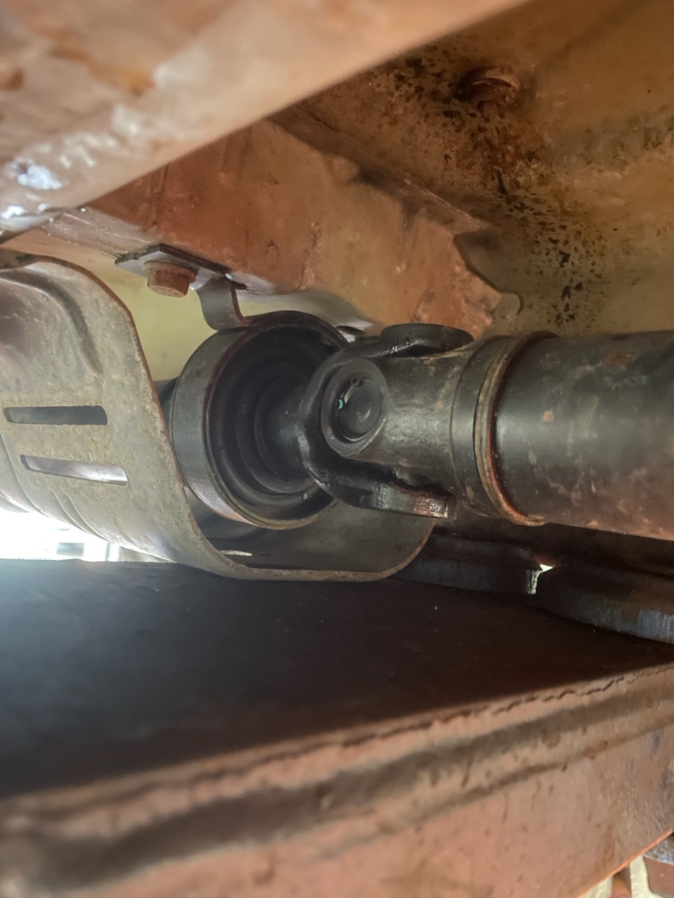

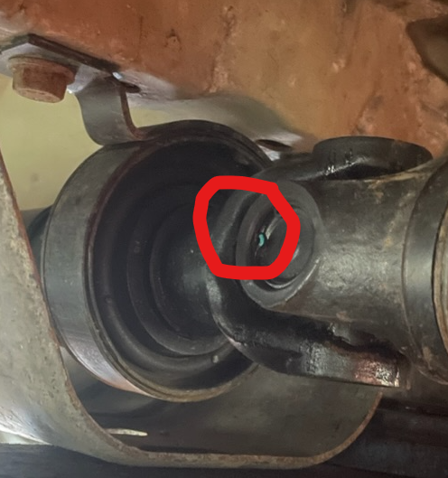

Two interesting observations based on your photo:
First, I think that whole propshaft has been replaced - the universal joint and its fitting to the tube is different to mine (see my photo) and it all looks very clean compared to the rest of the underside.
And second, note the ring of grease spots on the car, being flung out from that universal joint. I wonder if that is where your clonking is coming from? Mine is dry there (the bearings are sealed)
In my photo you can see the beginnings of a little deterioration of the rubber ring: five years and 47000 miles old. There's a long way to go on that though before I need to do anything

@Herts Hillhopper you beat me to it and I actually went and looked under the car (this time...). I would agree a replacement propshaft and relatively recently (note relatively clean marker on UJ circlip). Do you know if the prop shafts are dynamically balanced (originally) maybe this is part of the issue?

The whole prop does look fairly clean under there, so it may well be that it has been replaced. The ring of grease seems relatively dry, so I wonder if that was from the old bearing, and may indicate why the prop has been replaced.
