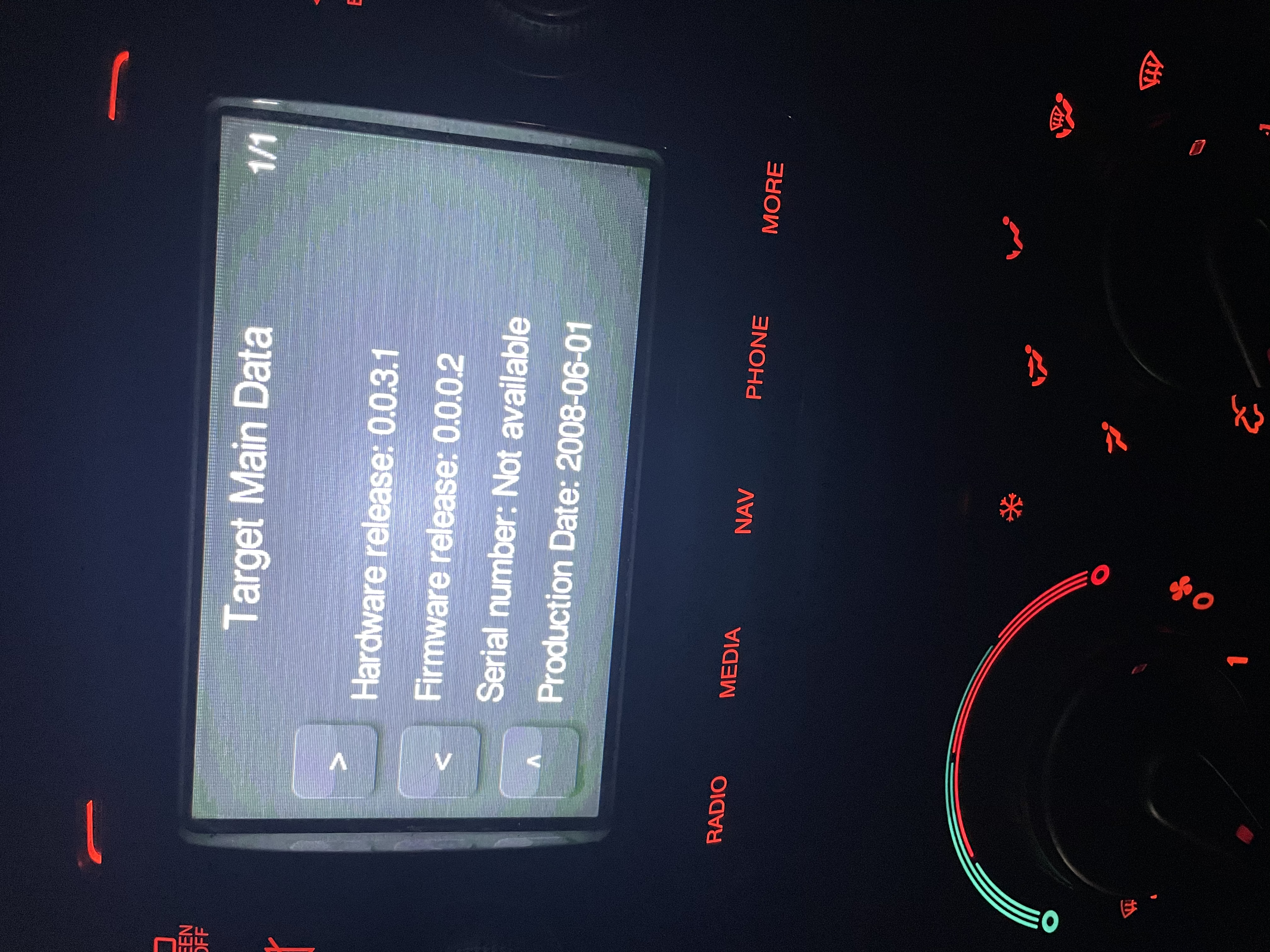

I’ve recently bought a boxer 2016 and the dab cannot be pressed , all the dab settings are active in the engineering menu and I’ve tried the 3 firmwares in consecutive order but they just say not supported , this is a picture of my version installed currently

With my Relay 2016 I had to start by upgrading to 12.00.24.01, then 13.00.57.05. I've yet to try the final step to 13.00.74.00. Now the DAB button works, but the radio can't find any DAB stations when it scans. I suspect an aerial problem rather than a radio firmware problem.
