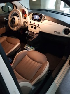

My radio in my fiat 500 2017 is stuck suddenly on Fiat logo screen and can't go further steps..
And the last radio station is still working but no buttons is working except mute and volume...
Wht shall i do?
