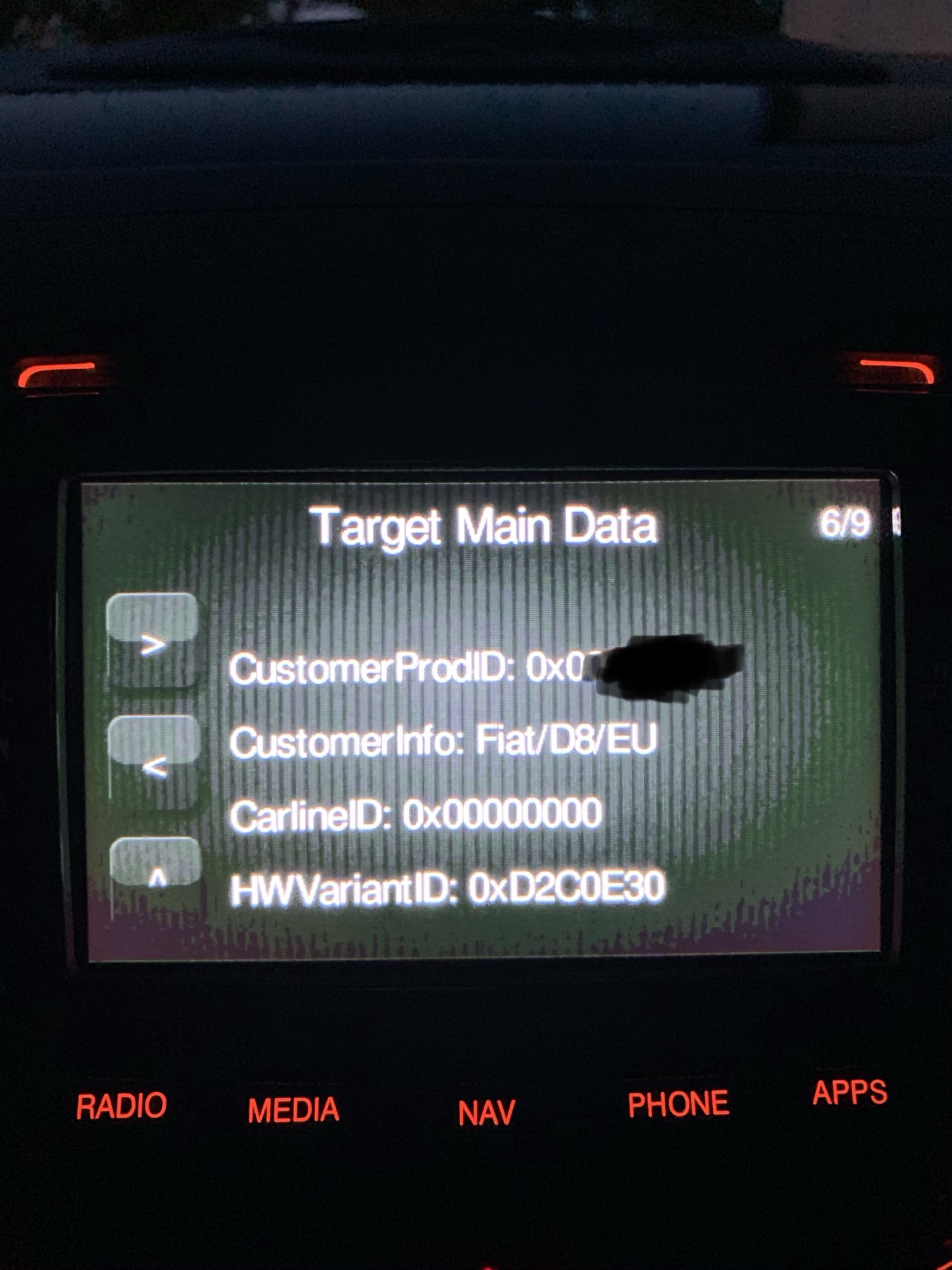

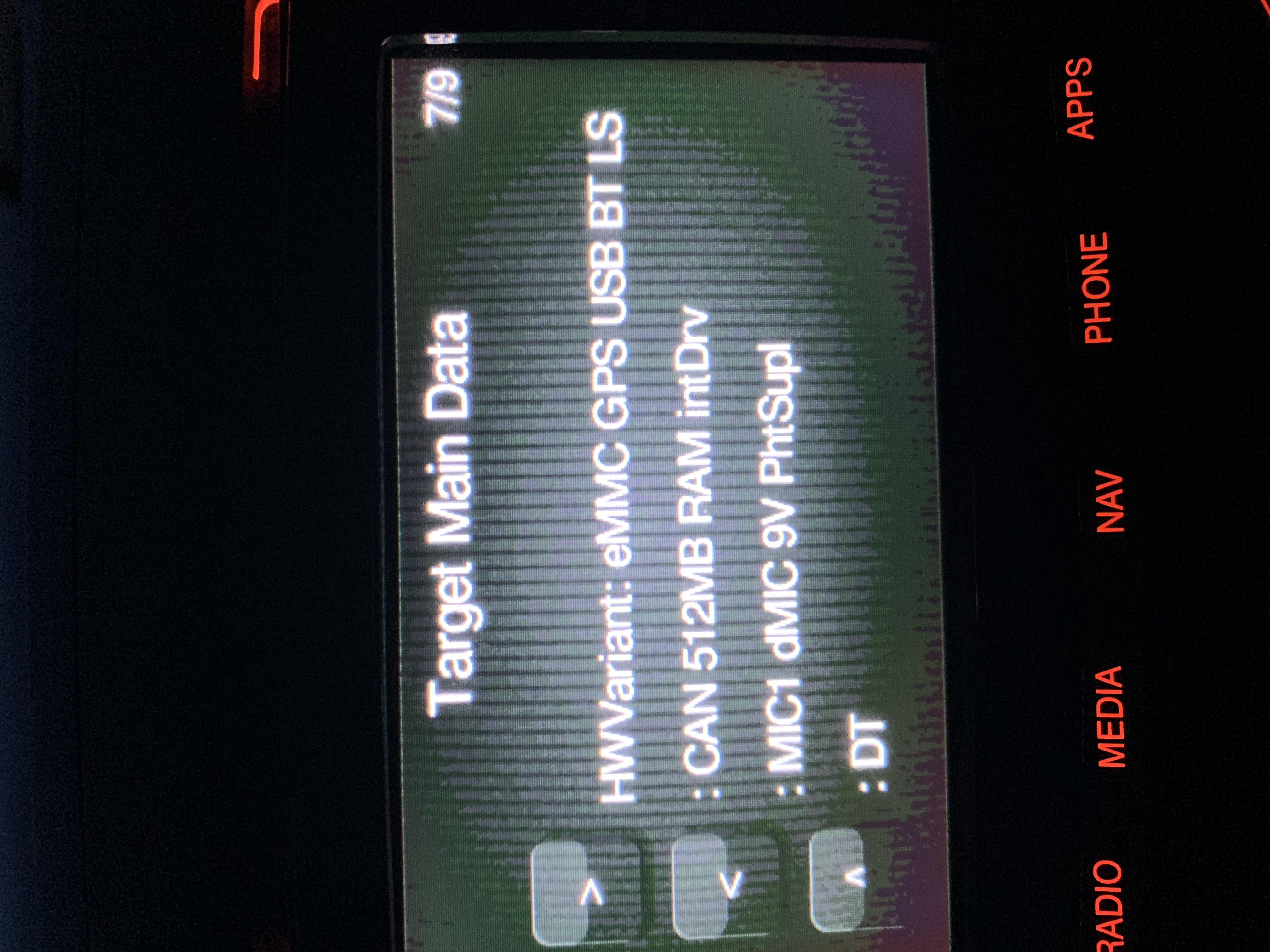

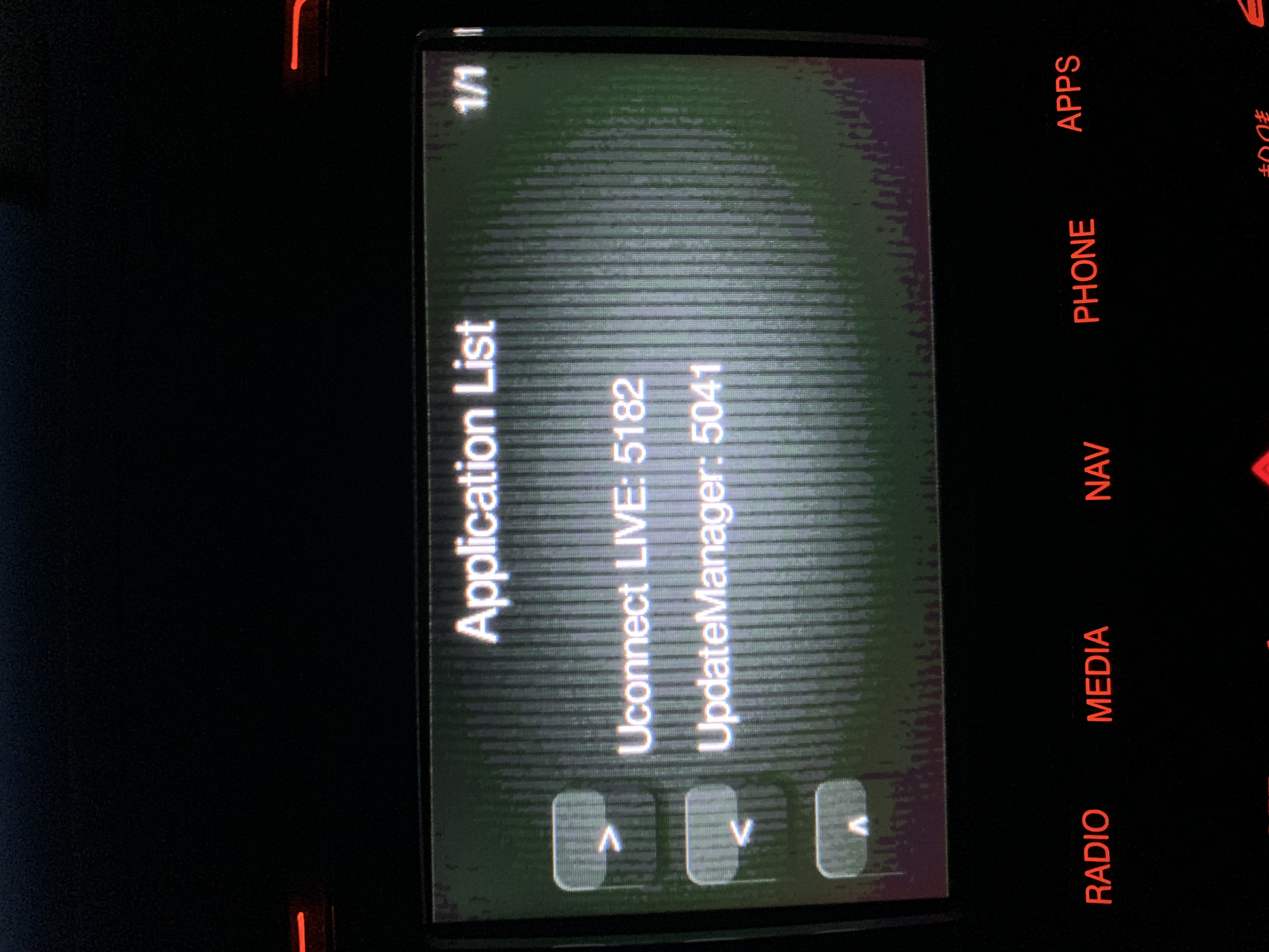

Hi, I have a 500L Trekking 1,4L from 06/2016 with Uconnect 5‘ includes Live NAV.
My Dealer Updates the Uconnect in Jan 2018 and the Most of all are fine now.
The only thing is, after this Update the eco:Drive don’t work, the Data’s don’t go in the Cloud and the App don’t geht new Data’s.
Fiat can’t Help, he saying it’s a software Problem and he don’t know any Fix.
Maybe a new Software Help.
Think you you get a new Update next Time?
Oh i forget my Hardware Information:

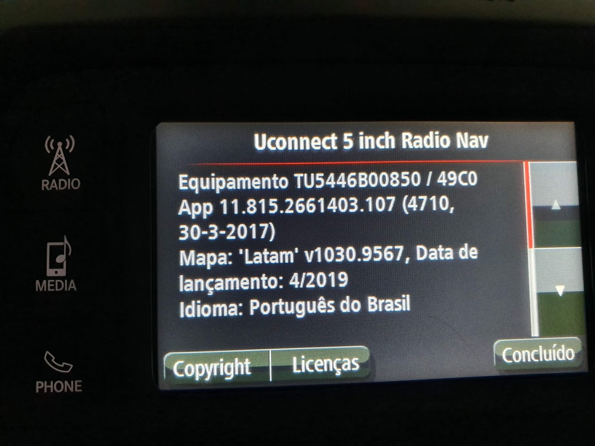

Hi ! I'm from Brazil and I reachead here looking for an upgrade to my 5" uconnect nav radio (ROW). Actually I was looking for a way to change Fiat logos from the unit to Jeep logos because I bought this used radio from a Fiat Toro to use in my Jeep Renegade.
This is my radio and the SW version (see attached)
I've downloaded the lastest version you posted here ( #13 ), and even I've been warned, I decided to go ahead.
And Success!
(see attached)
I still have the blinking hodometer, as my jeep dealer was not able to do the proxy alignment. I've bought an multiecuscan compatible adapter to solve it, just waiting to receive it.
But my question is: when I prepare the pendrive to upgrade in tomtom home, It generates a file named ttgo.bif, which is a text file where you can read:
VehicleBrand=1
VehicleModel=35
Do you know which would be the values for the Jeep Renegade? Maybe if I change it, the radio would display Jeep logo and graphism ?
Thanks
And Success!
(see attached)
VehicleBrand=1
VehicleModel=35
Thanks
Hi there,
Great news about flashing the EU model on ROW. I have heard many stories on the Alfa Romeo forums about it bricking - so it appears to cause issues on some variants of the radio. :D
For the splash screen, I've been asked before, and from what I can diagnose, I think the radio's cfe bootloader has the splash screen configured from factory and cannot be changed. Think of it as your PC BIOS splash screen, the firmware inside the bootloader is controlling this.
Because the splash screen images come from the UUID of the device, in this case, the '226' parameter, this causes the installer to install the features of a 226 vehicle. As far as I am aware, without direct nand modding, there is not much we can do.
I tried to decompile the firmware images before, but they're digitally signed, so there is no way we can mod the actual Windows CE system on it through USB firmware packages - I had many ideas to improve the firmware but as it is locked, we can't do much. I guess Fiat doesn't want us snooping around stealing proprietary uConnect software (maybe why the blocked the official download links)
As you have a nav model instead, maybe the tomtom parameters can help? I assume they're for the TomTom app features in something, I do not think it would work with modifying the actual System bootloader as that is not booting off the USB but try it out with different values - you never know :)
I would try a proxi alignment when your tool comes, be careful with elm327 tools, some don't work as they're missing the Canbus protocols and only do generic testing. You'll need to find one preferably on Aliexpress with a PIC18F25K80 chip (and FT232RL interface if USB), look at the board design and see if the resistor 121/120 is present - if so remove that with a knife and it will work fine. I've tried this on many elm327 v1.4 Usb PIC and elm327 vgate bluetooth PIC (alfaObd on Android/PC can do more settings on proxi alignment - but I found MultiEcuScan to be more stable). There are many fakes without this chip so I compare the board design images with the ones on the MultiECUScan forum to determine which work.
