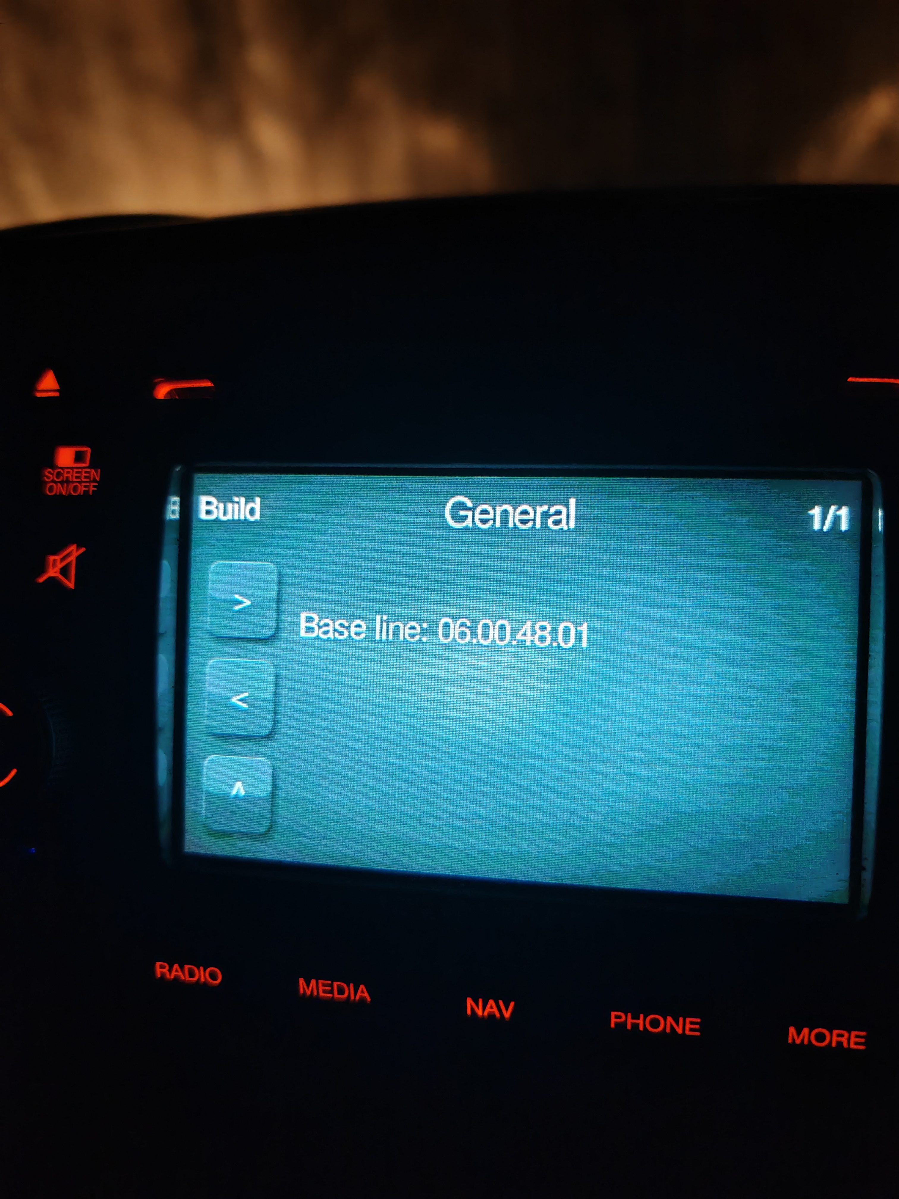

Hi, my unit is restarting nonstop I don't know what region or too much about it ( I'm in UK) but these are the screenshots .
I hope a software update, if I can make one , will sort it out. Thanks
