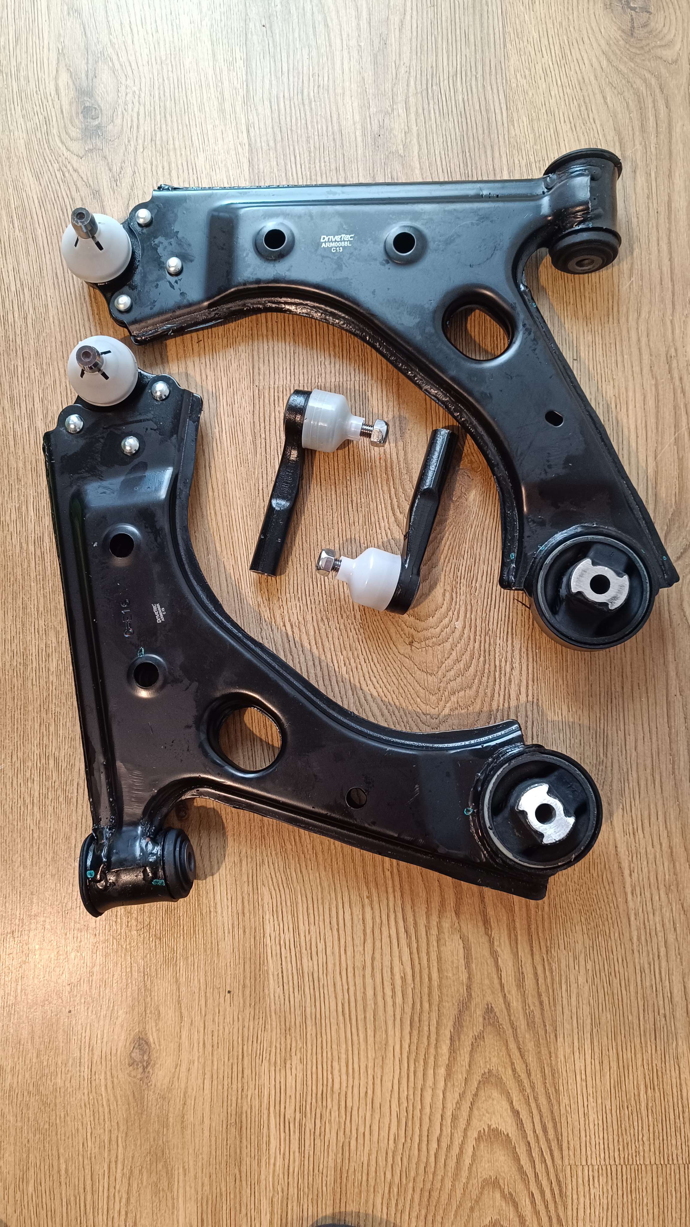

I've ordered new control arms and rod ends from GSF. The price is actually better for all those parts than I could get on ebay. It qualifies for free delivery too, but i'll be going past there tomorrow anyway, so i'll pick them up. Sadly next Wednesday is the earliest I could start this job.
I suppose I could have had a go at putting new bushes in there, but these are 16 years old and probably not worth trying to repair.
I'd say a good choice of supplier. Much more likely to get a quality product than from an ebay unknown.

I collected the new shinys. These bushes actually feel rubbery, nothing like the old ones.

They do look nice.
I didn't realise just how much the bushes could dry up and lose their movement until i tried these new control arms. I've tried spraying old bushes with grease/WD40 but it didn't make much difference.
