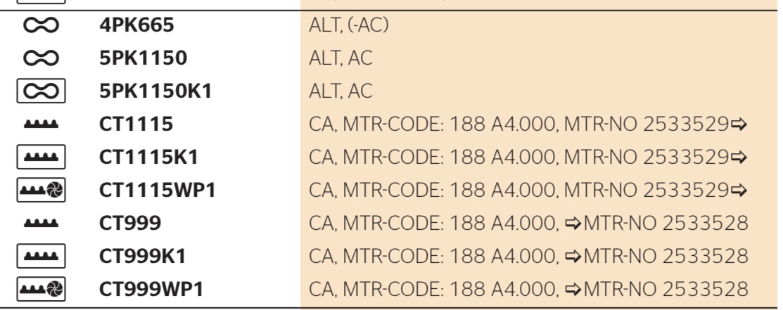

I have had a good trawl through the forum and I cannot find the answer to this question. I have two 169 Pandas which are both due a new timing belt. I am struggling to select the correct one though.
Panda 1 is a 1.2 FWD 2008 with engine code 188A4000 169AXB1A - it has an engine number that starts in 4 so I guess that the correct Gates kit would be KP15627XS?
Panda 2 is 4x4 1.2 2010 with engine code 188A4000 169AXB2A - I cannot make out the engine number on this, it is very corroded and I have tried a mild abrasive with no joy. Given that this is a newer car than Panda 1, would it be safe to assume that the engine number will be greater than Panda 1 and therefore Gates kit KP15627XS would also be the one to go for?
I have tried the sites where you enter your registration number but they suggest different timing belt kits depending on your engine number.
I would be grateful for any help you can give me please.
