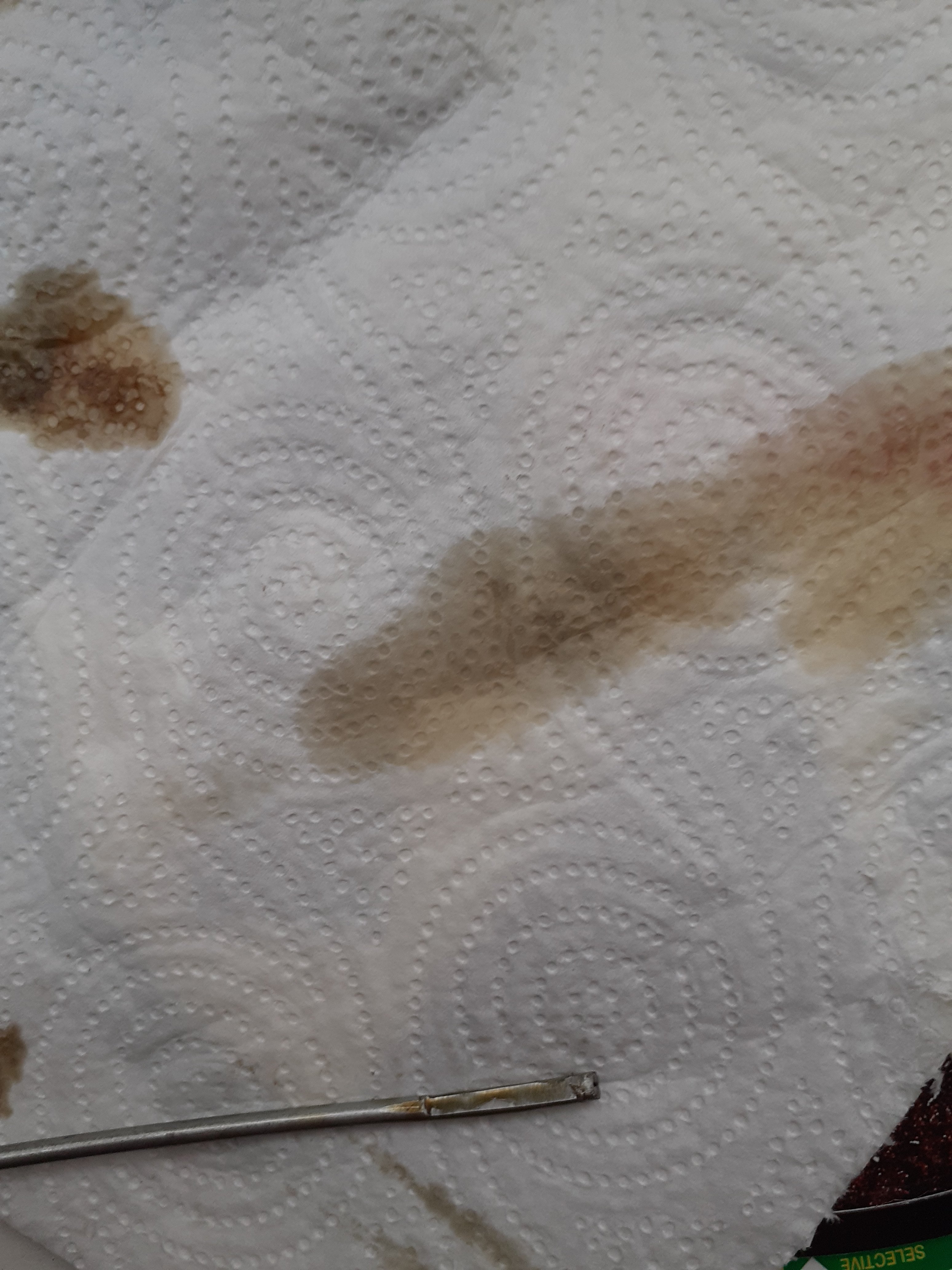

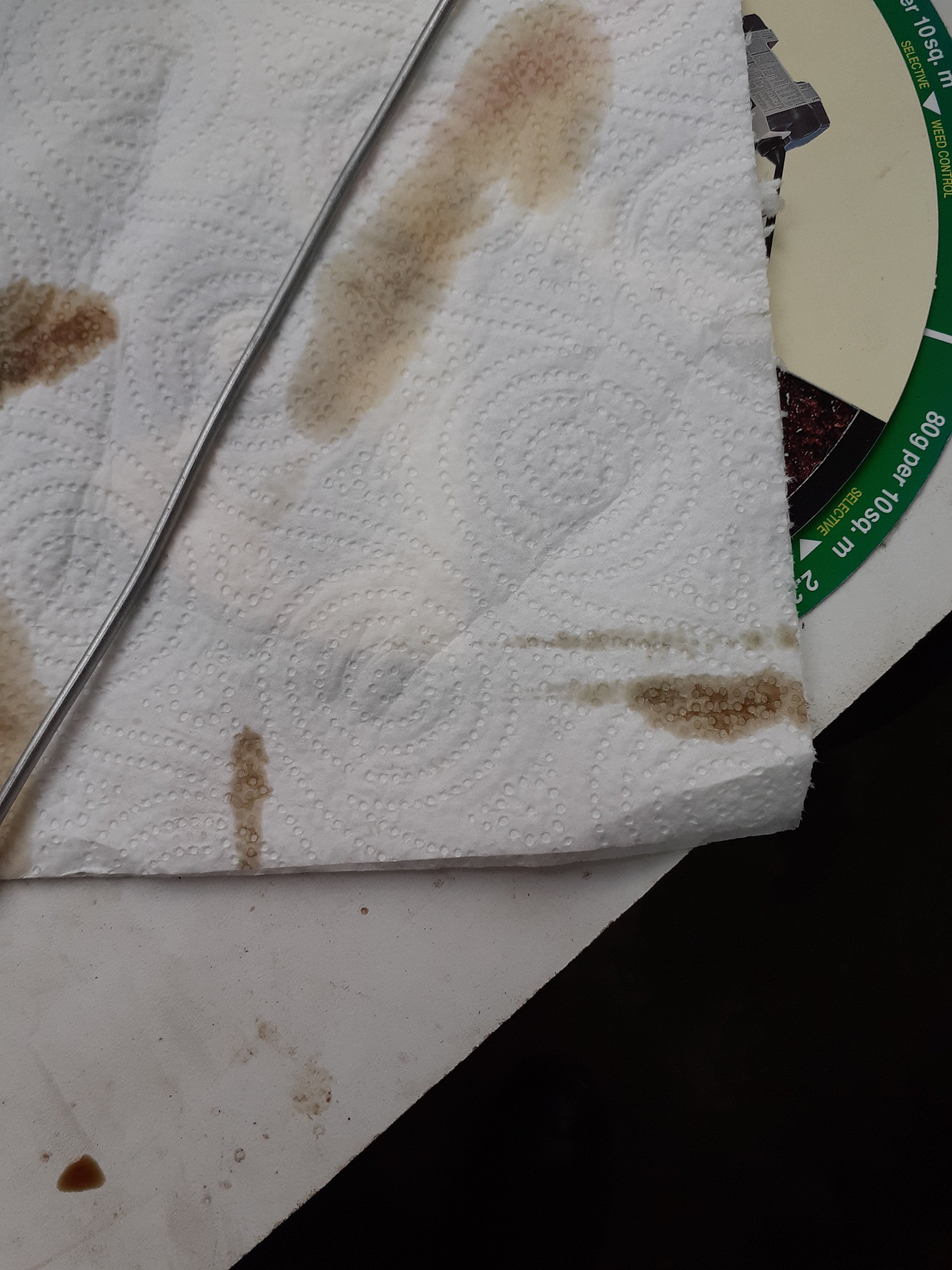

Well here is my oil level check experience from today and it should be an eye opener. The car is a 2019 TA85 Panda 4x4 with 13K on the clock. A couple of weeks ago I checked it and could not get a reading off hte dipstick. Oil would not cling to it.... Maybe something on the rag I used to wipe it. I was certain it was actually right but. After reading this thread and other tales of oil level sensors casuing limp home mode in some 500's I decided to actually go resolve this.
The moral of the story is that my engine is overfull and it is so easy to read this off a sensible dipstick
Fiat are a load of dipsticks
The paper towel test is better than nothing but it seems to me its about =or- 50% accuracy.
Using a steel rod the level on the paper towel is immediately obvious and very clear, but you can see clearly it on the dipstick anyway.
I used a piece of thick steel wire, bent it so it sits exactly on the top of the engine cover, cut and bent it so it cannot be dropped into the engine, flattend the end and then used a grinder to give identifyable flat showing min and max levels.
I suspect a length of wire coathanger would give a better view than the Fiat dip stick which I shall remove entirely as it is WORSE than useless.
I hope it may be possible to fix a metal dipstick in place with a bit more thought but as its hanging inside the engine I dont intend to rush into this.
It is very clear the last top up given when Fiats magic wand showed no oil was entirely unnecessary, but I am OK with the level showing about 6mm too high. Its not too extreme.
No wonder some people are having issues with incorrect oil levels and subsequent problems. Sue Fiat if your out of pocket.
