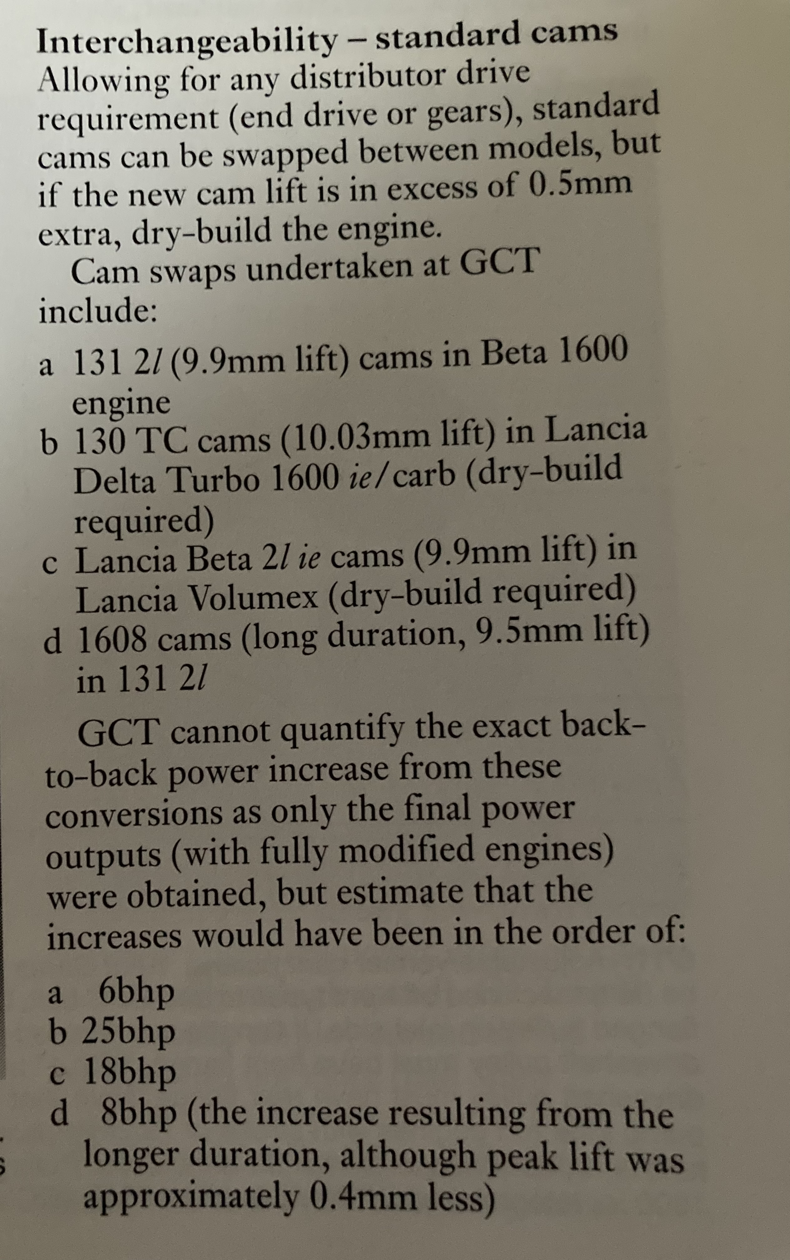

I like the approach advocated by Guy Croft, he spent ages evaluating stock parts and interchanging them between different engines.
In the extract below fitting stock 1608 cams. In a 2lit engine can result in 8hp increase.( no machining, stock shims)
The downside is the time taken to find the parts as they become more rare. Buying a spare engine for £500 is a great idea if you see one, but check the spec carefully (block & head casting numbers) Lancia TC’s generally perform better like for like than Fiat TC’s but the engine is inclined so you cant use sump and cam boxes

I bought mine in 2003! And its signed by Guy following my visit to see him, now deceased unfortunately)
In an unassuming workshop on the side of the road near Lincoln he had on his shelves some of the most sought after Twin Cam parts ever! Raw castings of Abarth 16v heads, 037 Rally car superchargers etc. He spent hrs on flow benches and dynos learning and understanding the intricacies of this fantastic engine. His engine specs produced good performance but crucially were very reliable.
