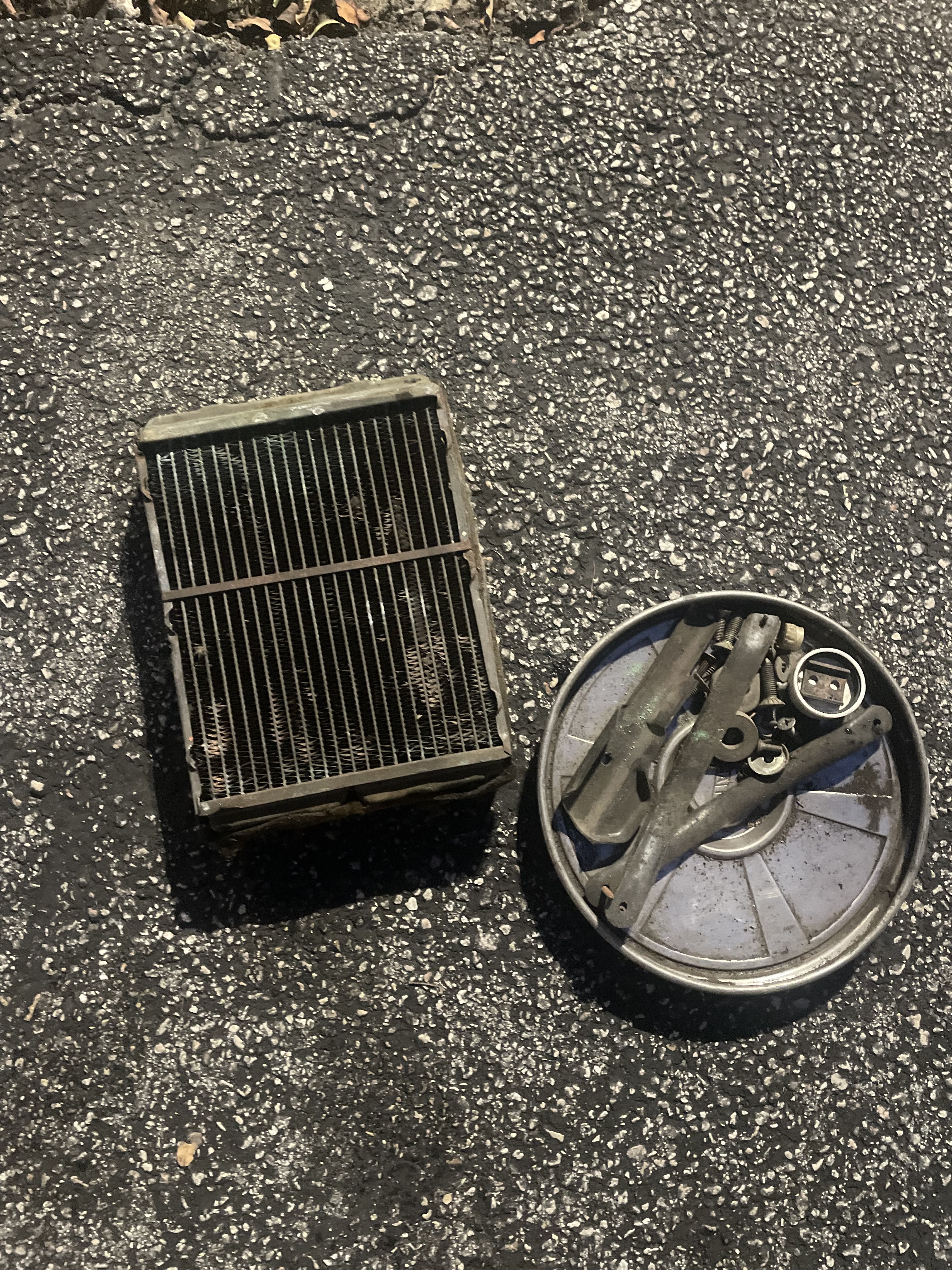

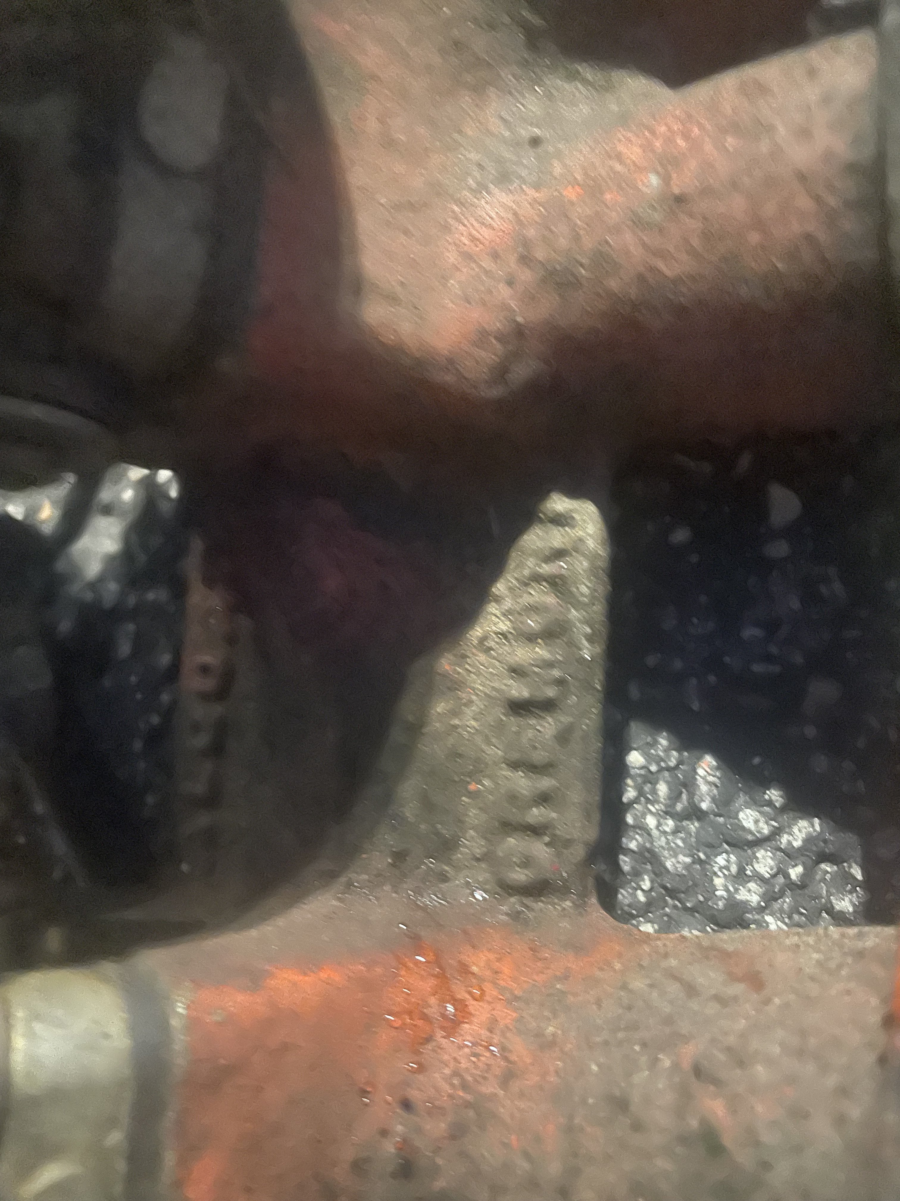

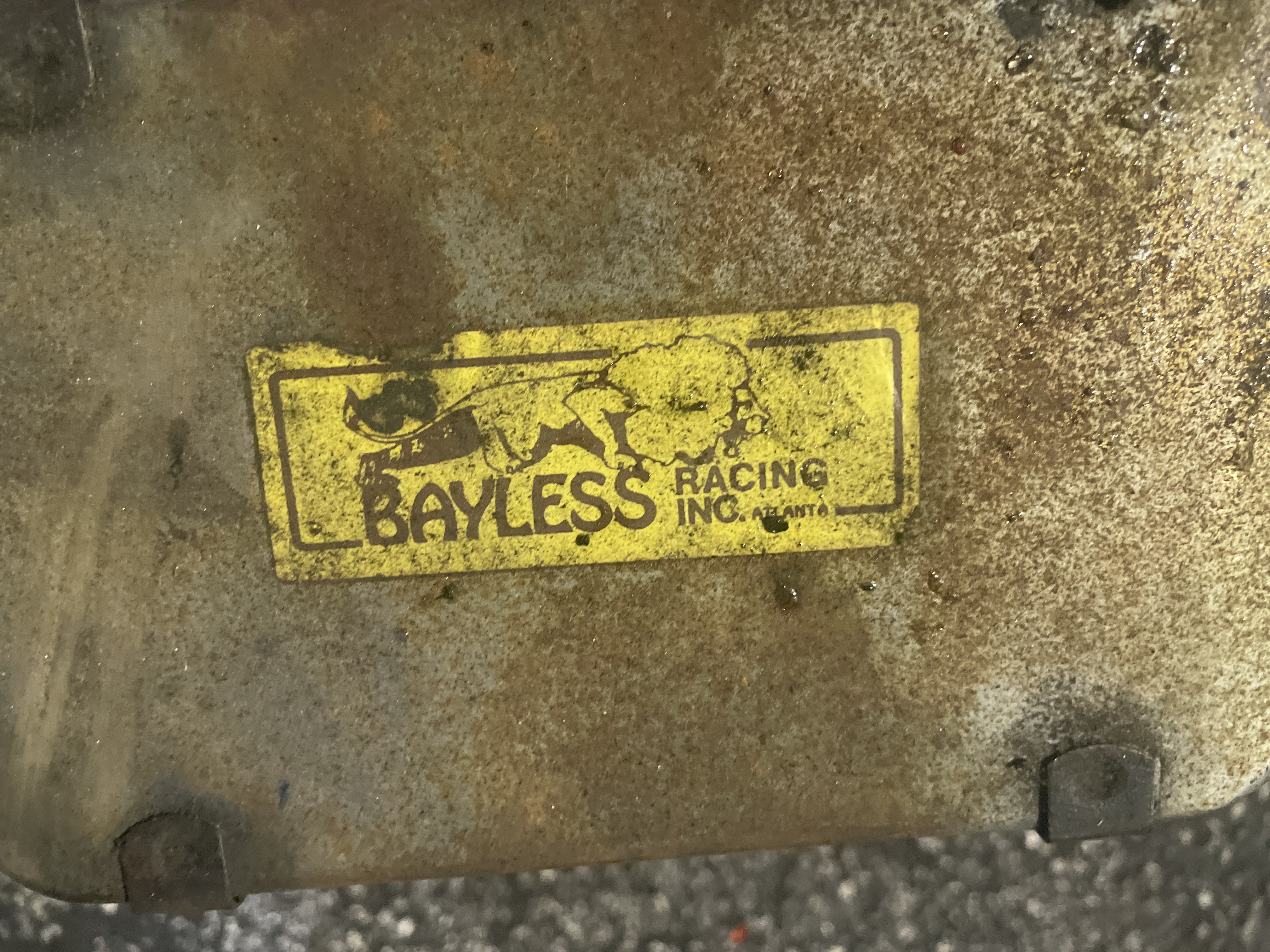

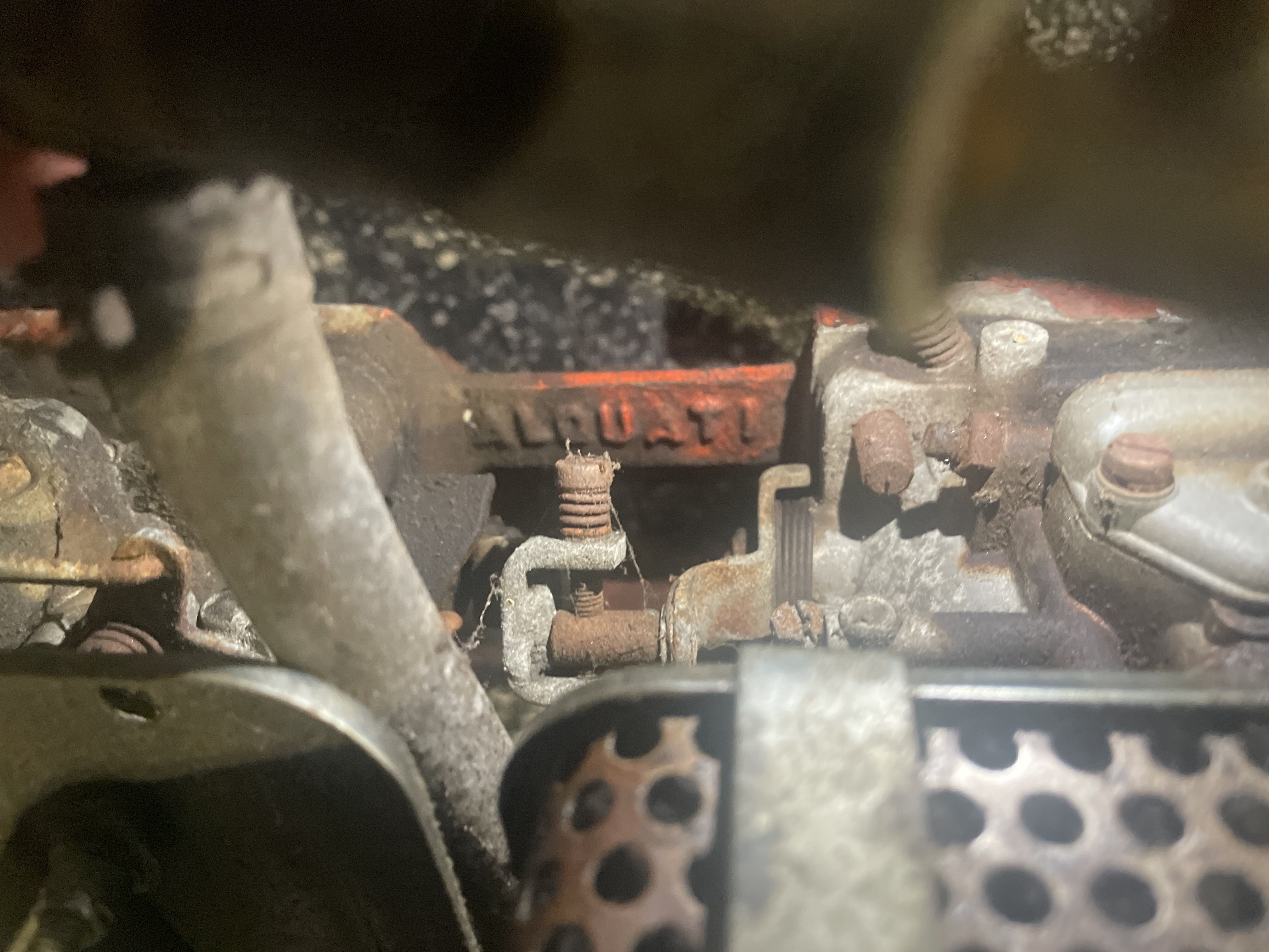

Good evening,
My name is Gene and I just bought at an auction a Fiat 124 CS1 late 1978.
In the trunk I found a couple of spare double bodied carburetors mounted on an Alquati Cremona manifold. I also found a small radiator. Any clue about these carburetors?
Any help is welcome.
Thank you!

Alquati was a supplier of tuning parts for Italian cars including camshafts, cylinder heads and inlet manifolds. Iirc, Cremona (Italy) was where the Co. was based. Afaik, there were various very similar looking manifolds made to suit different twincam engine, some were for the Fiat t/cam, some for the Lancia t/cam, the differences were subtle e.g. height of carbs when installed, whether engine was slightly inclined, intake runners biased towards one end to provide clearance for some other component e.g. alternator. So, if planning to install this manifold on your car, best check that it is actually correct for your particular car.

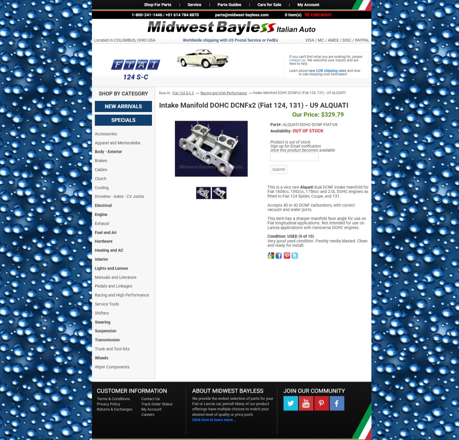

Here's a similar manifold from Midwest Bayless but it is listed 'as out of stock'.

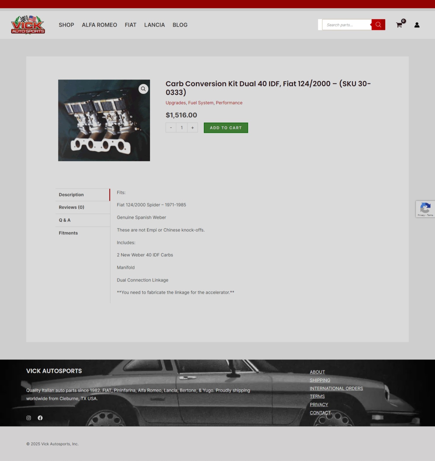

Vick Auto list a modern equivalent ;-
The small radiator is called a Heater Matrix, it's fitted inside the heater box/assembly under the dashboard, it connects to 2 metal pipes that protrude through the firewall (bulkhead) and are connected by rubber hoses to the engine cooling system :-
Re - the type of carb, looks like they're Weber DCNF, to find the exact type, clean the carb. mounting flange next to the manifold, the model type, size and the version (iteration) should be stamped into the flange.

Maybe offer the Alquati set-up for sale and given that Midwest Bayless say it's very rare, it might be worth quite a bit to a classic Fiat enthusiast/collector. If those carbs are Weber type DCNF 40, these were used on many of the older Ferrari's etc. so possibly might be worth quite a bit on their own?

I think these are DCNF carbs
The manifold looks similar to Twincam head but I think they may be off a Lancia which has the engine inclined with the inlet side higher than the exhaust
I have seen Montecarlos fitted with twin DCNF’s but not seen them on a Spider
The parts are rare and can be serviced so valuable. Its worth getting them ultrasonically cleaned before you sell them
