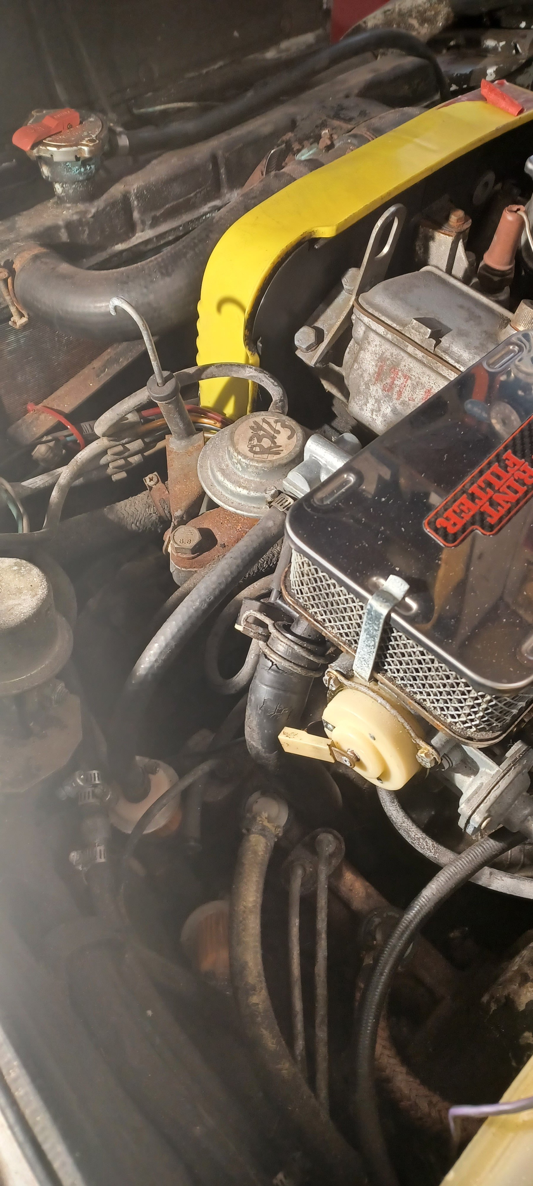

Until any more 124 Spider owners come forward , I have this from an old DIY manual which appears to show as in photo D , your last pic. Note these are Solex carbs not Weber so may differ . Pic appears to be for a LHD drive vehicle so could be relevant.
Also the throttle linkage on cam cover appears to line up with carb in that photo and auto choke mechanism facing rearwards.
Obviously check what other say and what looks most logical.:)

Do you have a tube coming out of the bottom of your chrome air box? If so, is the box mounted so that tube is closest to the round faded yellow plastic piece with the wiring attached to it? That would mean that I mount the box to the carb as in my picture B correct? My version of that yellow piece is black, but looks like the same piece.
Hi Steven..yes it appears like your picture "b" , the part on mine that is white with the wire attached, and black on yours is your electric choke , the hose attaches to the tube coming out the bottom of the air cleaner right next to it...if you enlarge the other 2 pics I posted you can see it but here is a little better picture! Hope this helps!
Cheers Terry
