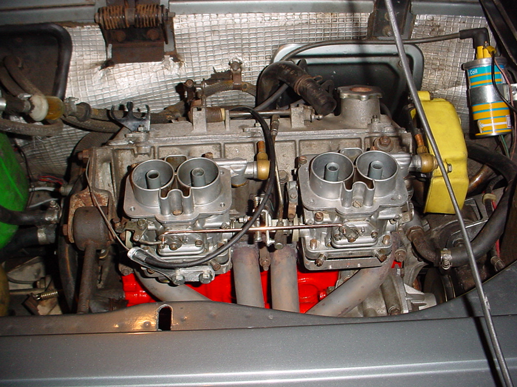

Did someone mention twin carbs ;)
I have a tuned X1/9 and twin 40's are if anything slightly too big for that and that's with 32mm chokes!
