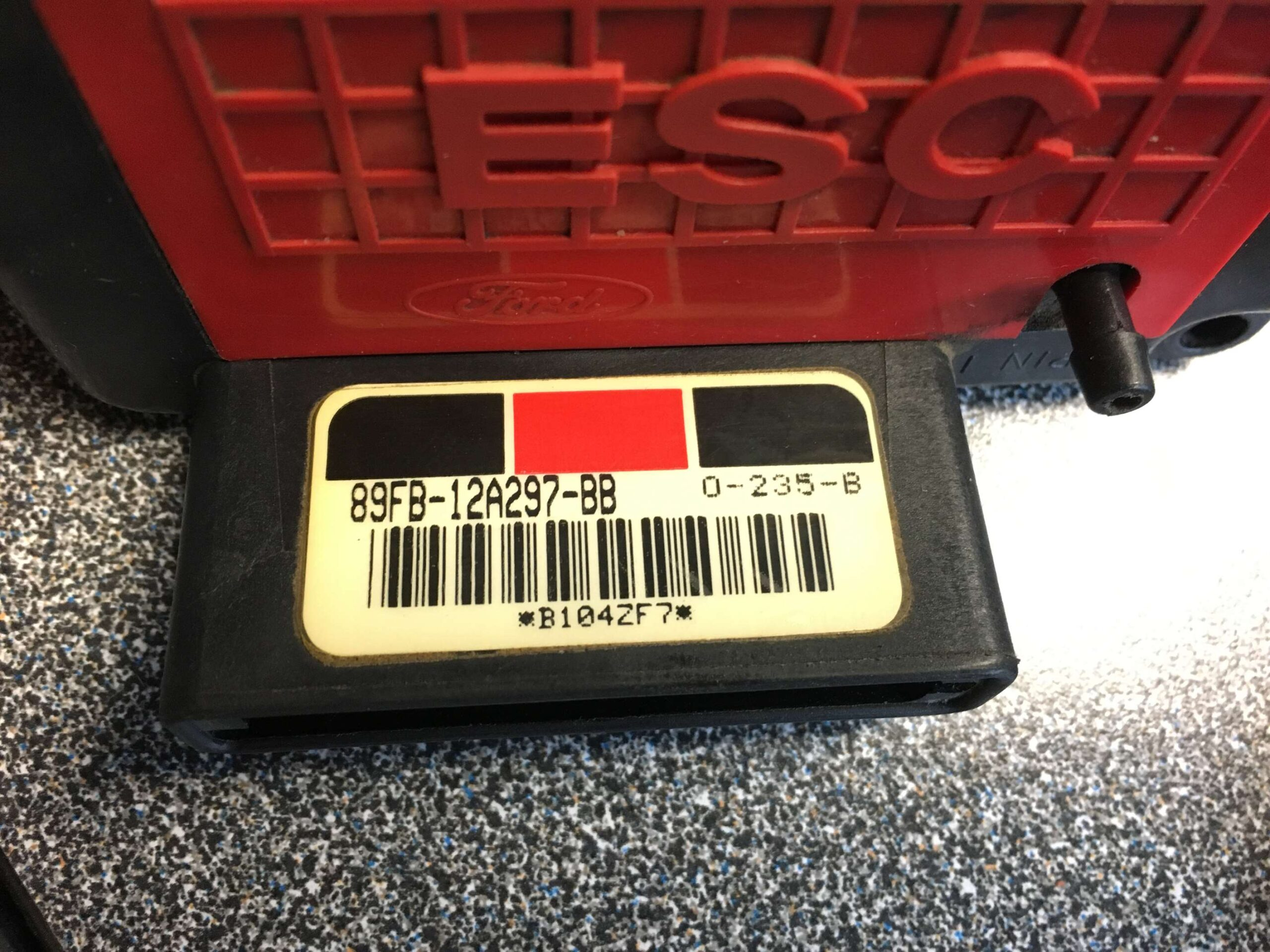

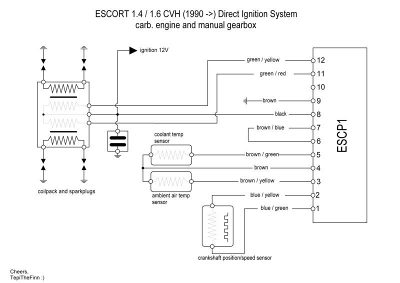

This isn't exactly the one I was thinking about but does seem to be available . Other than that there are some simple ECUs late 1980 to mid 1990s with their pin outs details in the Haynes Engine Management Pin Tables 3558 and 3578 though mostly early injection, but fairly simple layout

That sounds like a good starting point. From memory earlier Fords ran 1243 firing order. But that ESP1 looked like a "wasted spark" setup
It doesn't have to a Ford, just whatever is available around your area that age, providing there is enough information available.

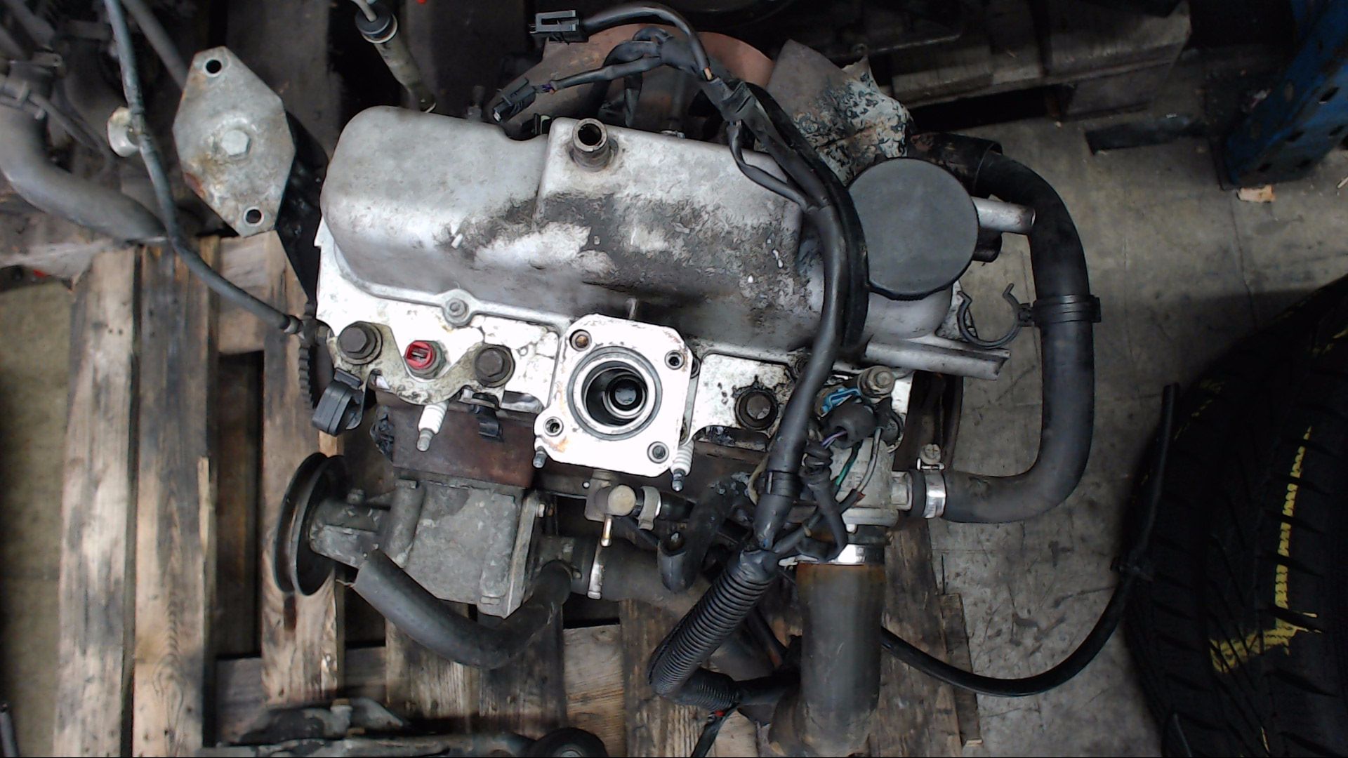

Hi Purf! And thanks for the reply! My car has the 899cc (series 100) pre FIRE engine. This type of engine with different displacement is used in the fiat 600, the zastava 750, the fiat 850 and many more fiat cars, from the period. On the early engines and some cinquecentos, for the polish market, there was distributor and a carburetor. The distributor was mounted on the head facing upwards facing the bonnet. On all SPI cinqecentos, pandas and any other fiat the hole for the distributor is plugged on the head and the carburetor is replaced with throttle body and injector (and sensors). My car is early SPI and it doesn't have an immobilizer.
The pump will be an electrical one, for carburetor use.
Where i live there is no one capable to diagnose the problem, and i'm not to happy spending loads of money replacing unnecessary parts. I've owned cars with carburetors before and i'm happy with the performance and setting them up.
