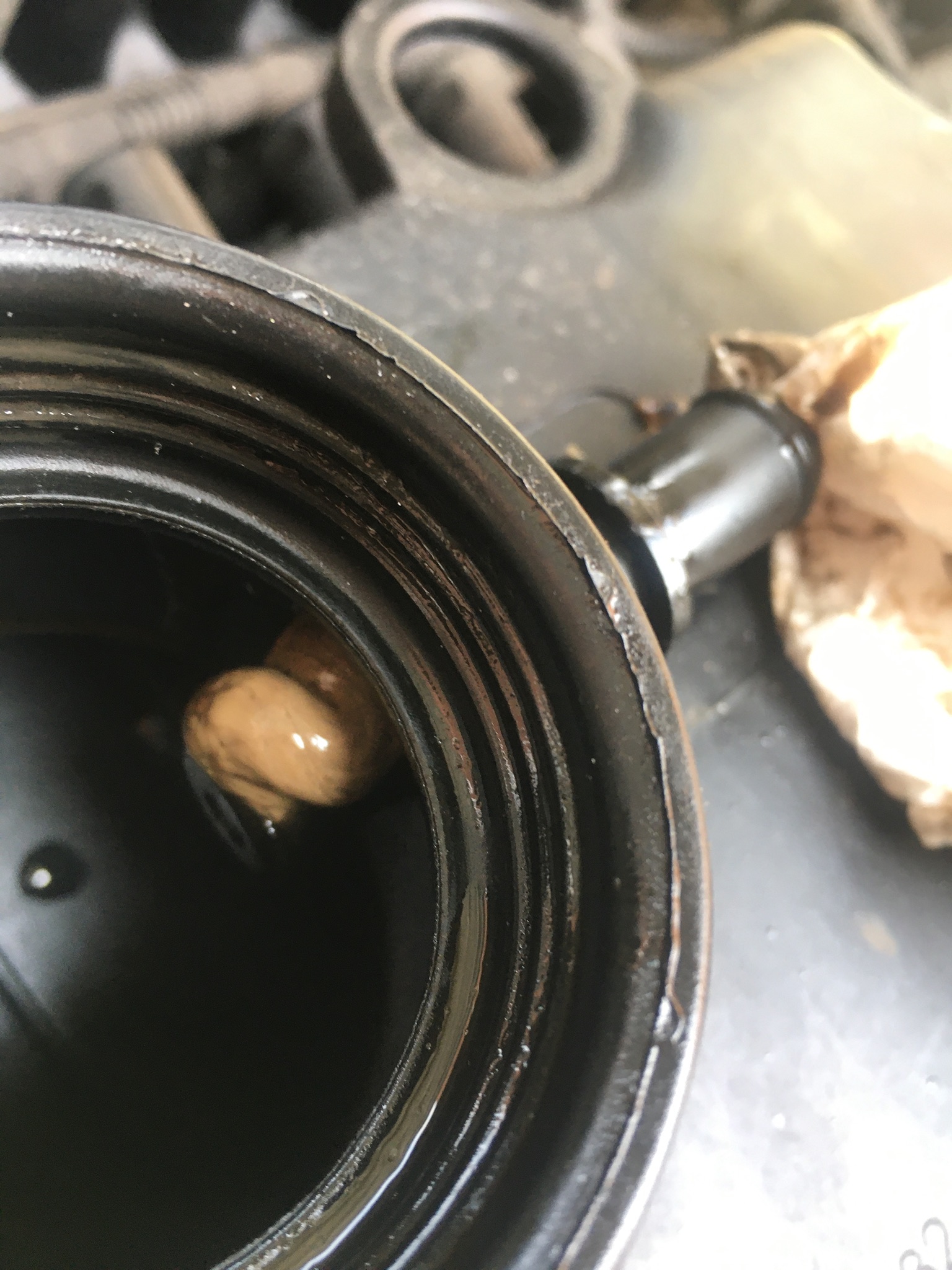

Pull the MAP sensor out and post a picture

Hi all, thanks for all the feedback. So a work mate had a look and he unplugged the map sensor and plugged back in and fired up first time. Could i just need a new sensor? Oil levels are fine but checking daily.
MAP sensor gets bad readings due to a drop of oil on the sensor
A blocked breather tube is the cheapest cause

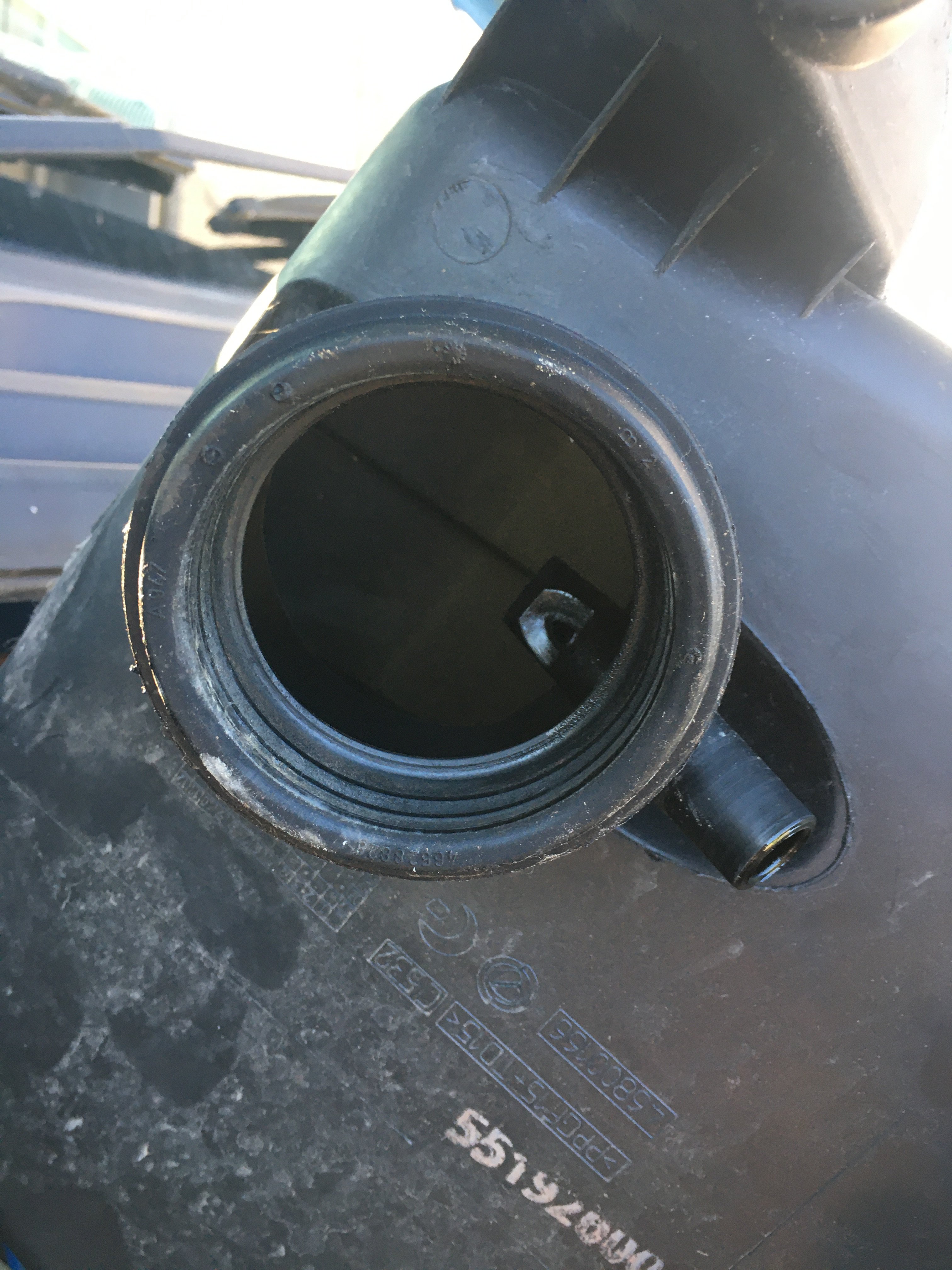

Take the airbox off (2X 10 mm bolts) post a photo of the bit underneath
If there’s oil (mayo looking) then it’s likely this tube is block
