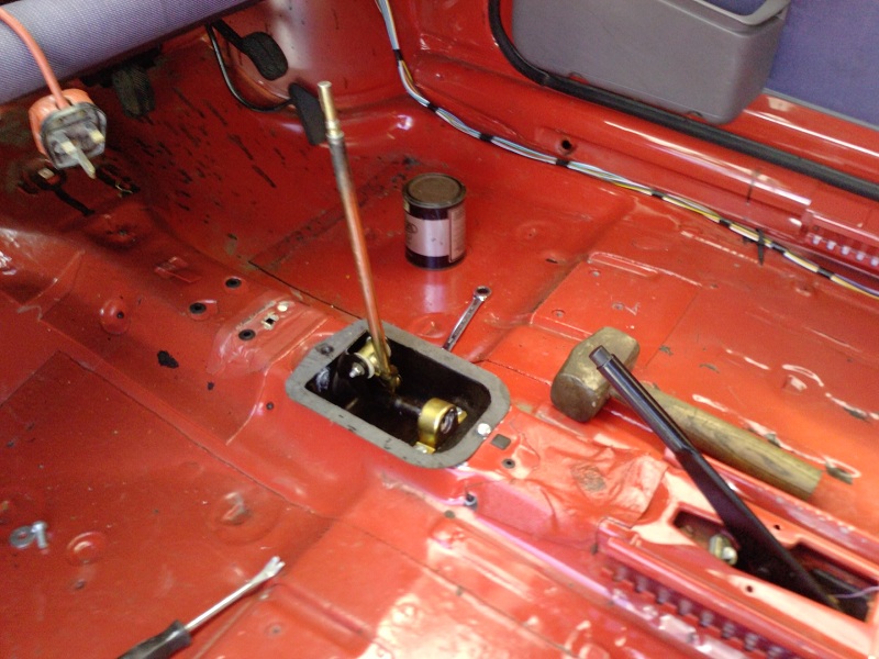

Gear linkage all connected now. Was a bit harder than expected, the Punto carrier is larger, so had to enlarge the hole in the floor - and also the Punto linkage has a forward support which is part of the car so I did not have.
Managed to save the day using a piece of Panda gear selector (the push rod) which I cut and welded to support the gear tube. The ball joint at the end meant it was perfect!

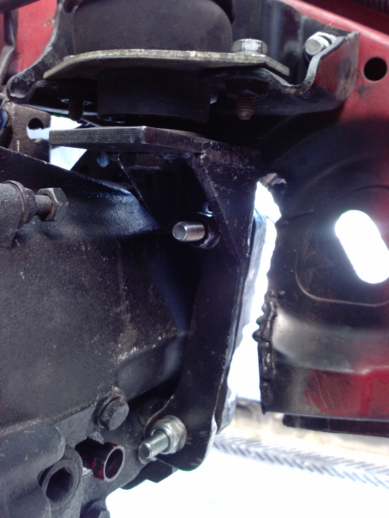

This is the passenger side gearbox mount. I've moved the Panda rubber cup and bracket forward, handily there were already 2 captive nuts so I just drilled another hole and spaced it with nuts, so effectiveley making a stud in the wing.
The 'c' shaped piece is made from thick steel which I cut at 90 degrees, welded, and I then welded 2 triangular supports in. Finally with a hole drilled in the top for the mounting bolt.

Yup had to take an inch or more away from the arch to house the end plate, welded it back up with steel plate though so it should be just as strong, if not better.

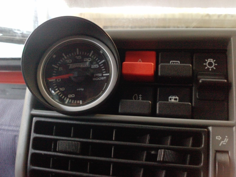

I've mounted the boost gauge obviously in the clock hole. Nicked the clock light wiring for the gauge wiring, so it will light up the gauge on sidelights.

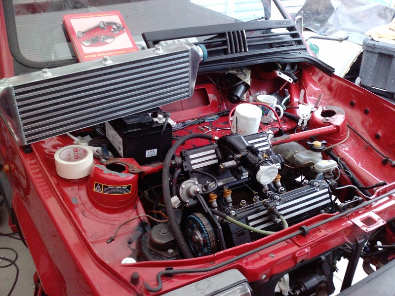

I just got myself an awesome front mount intercooler. Seriously. Its like car porn :)
I'll get pics up soon!

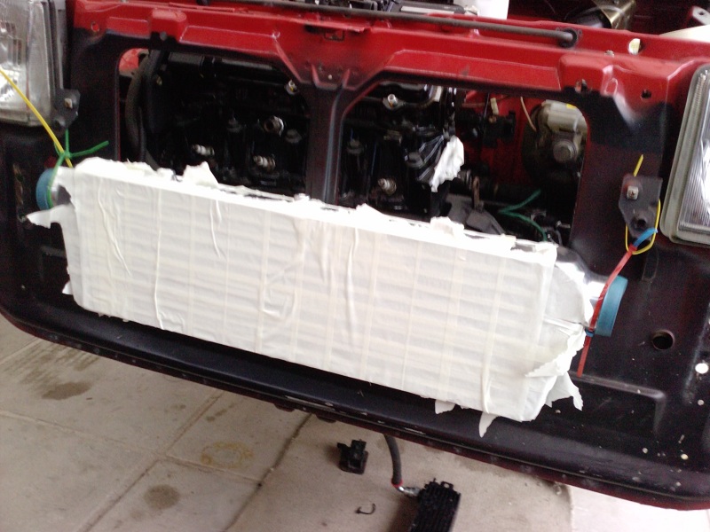

Its going stealth - under the bumper - with some holes cut for extra ventilation. Also painting the face of it black so it blends in.
Can't be doing with a big riced-out intercooler. Not cool!
