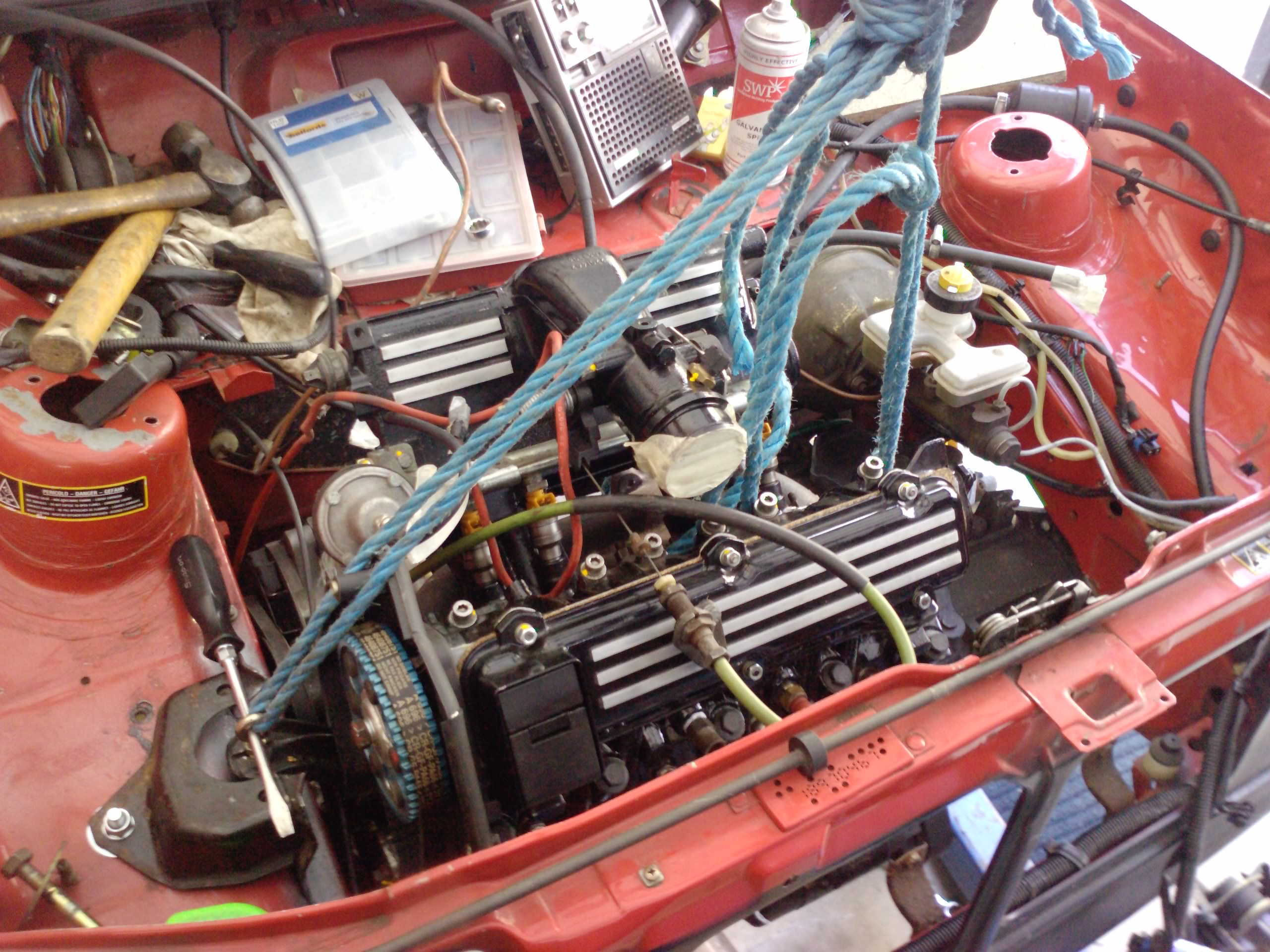

Tonight I'm going to lash the pulleys and cam housing on. I started it late last night but realised that its going to involve a LOT of tea drinking and head scratching!!!
Its one thing taking an engine apart and rebuilding it.....but rebuilding and engine that you've never seen before is near impossible. Especially with the joke that is the Haynes manual! haha

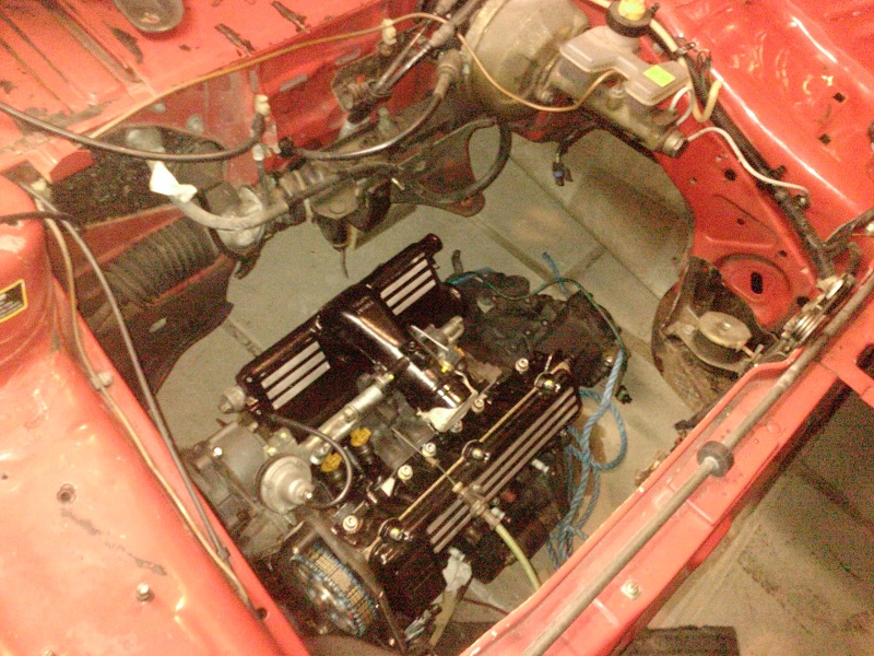

Note that the drivers mount has been repositioned and welded 6 inches forward and has to be taken an inch closer to the wing so that the final drive end plate does not stick into the wheel arch. The Punto GT box is 2 inches wider than the standard Panda gearbox, so have to compensate.
Looks like its an engine out job to change the alternator belt! hahaha

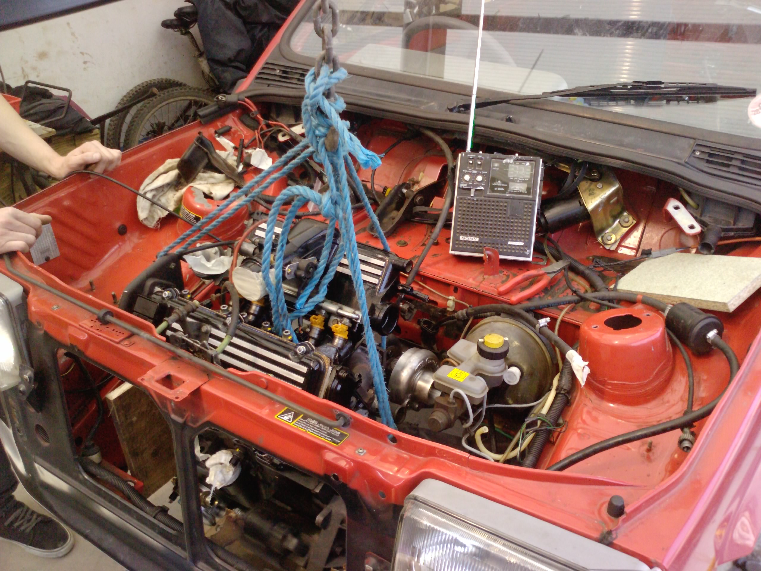

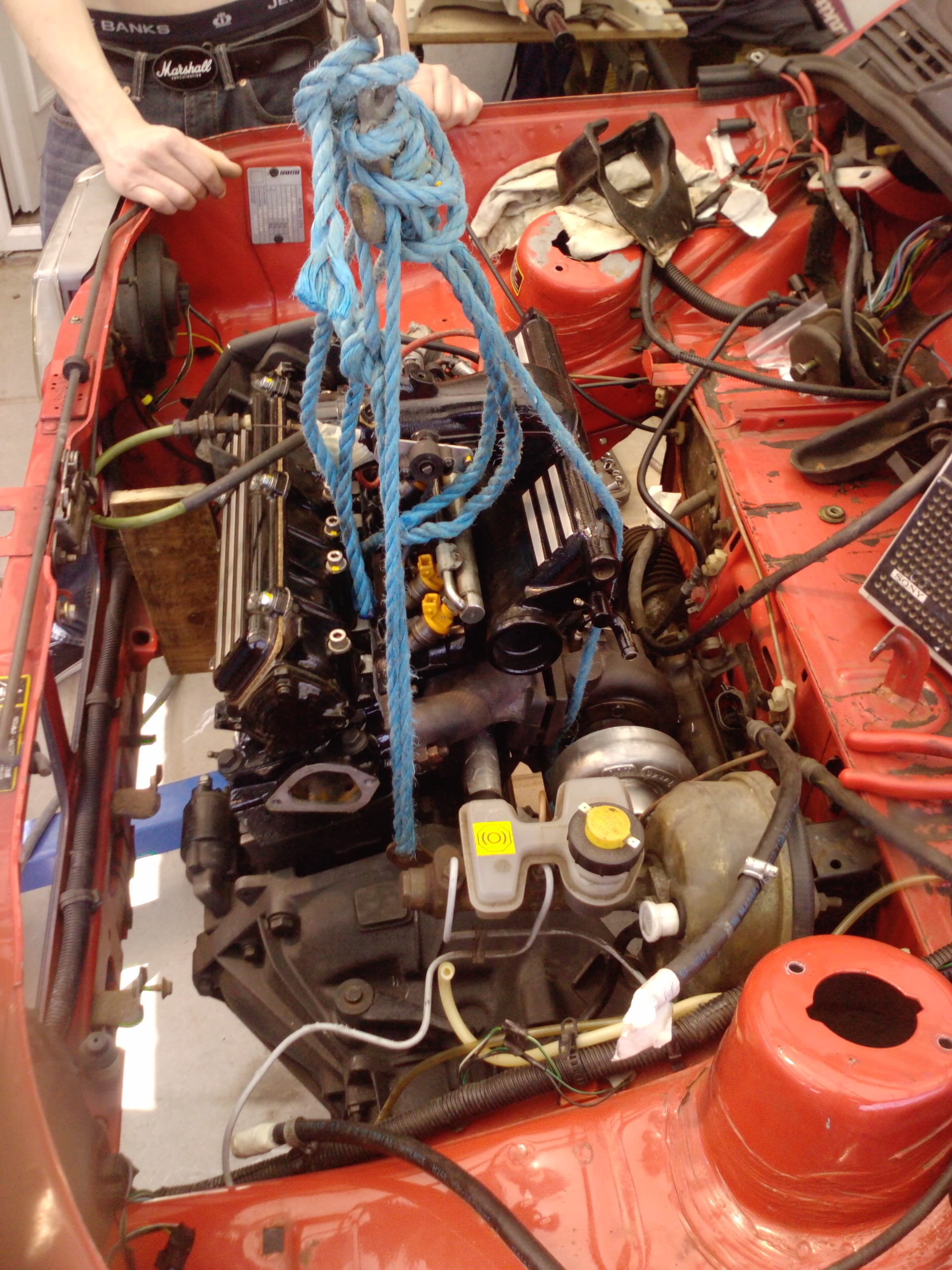

Finally got the engine mounted nicely.
Such hard work! Been up every night into the small hours. Had to move the right hand wing mount 6 inches forward, bring the gearbox mount nearly to the front of the car and make new brackets out of thick steel for each one.
Also had to cut a lot out of the wheel arch / chassis leg to accomodate the larger gearbox end plate.
Then there was a major clearance issue regarding the water pump and the r/h inner wing. And then just when everything looked good, I took measurements and found it was drooping towards the gearbox end by a few mm's, so had to remake the mounts!
Anyway, its mounted nicely now so treating myself to a reasonable bed time.
Gear linkage is on the cards tomorrow......even more hassle! Nothing fits....at all!
