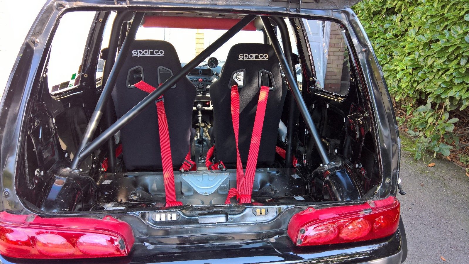

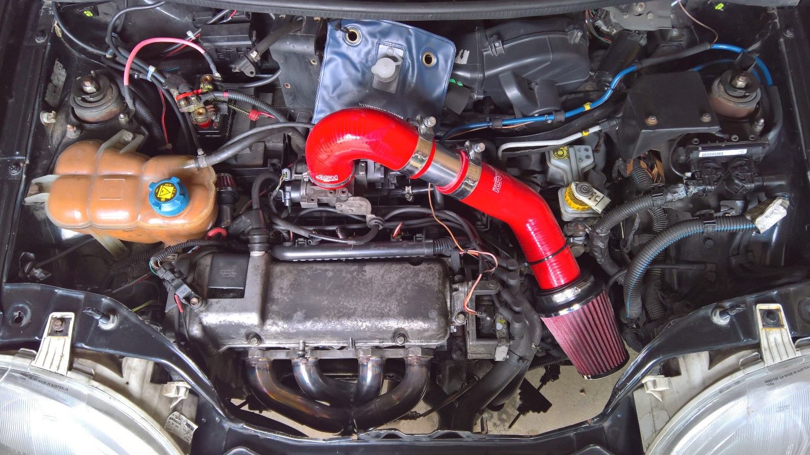

Hi looking for an engine guru / advise for my Sei 1.2 8v track car.... would like to see if I can get anymore out of it... Its running a de cat exhaust, induction kit, hot cam.. standard TB .. it's nippy enough more mid range than top end.... it seems to struggle past 4500 rpm .. like it's lean.. thought please.. my old 1.1 sporting used to like been reved... this semms to tail off ?? .... Thanks Ade, Im based in Lancashire thanks

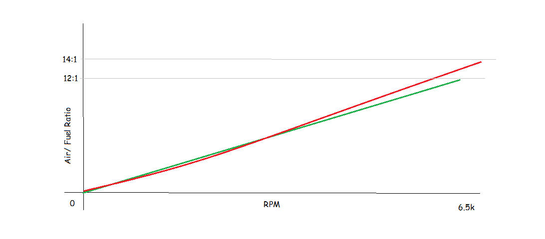

This is what i think is happening: (only that you are not actually getting the extra fuel required at those high RPM's)
The same that same graph could be used for the AFR as well:
It is probably lean for high rpm/load/ WOT but might still be to low to actually trigger a lean condition error...or the ECU might just ignore it since it's in open loop anyway.

The main issue you have is the Ecu. You will not find any place to remap the MF59. These have tight tolerances for emissions so I am surprised your injection light does not flash on some times with that 270 cam.
Changing anything on the fuelling side will throw things out even more so look at a piggy back Ecu before anything else.
