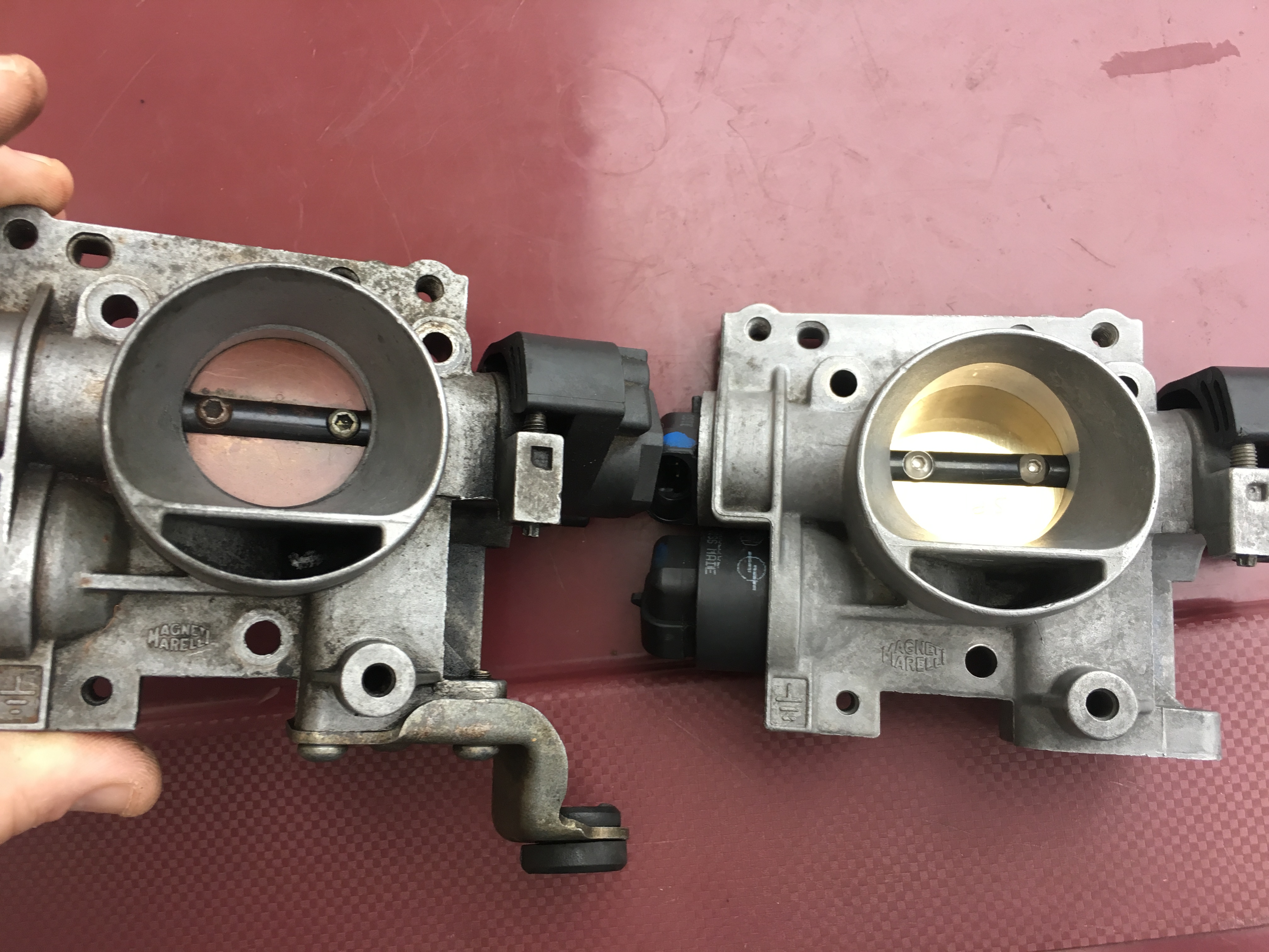

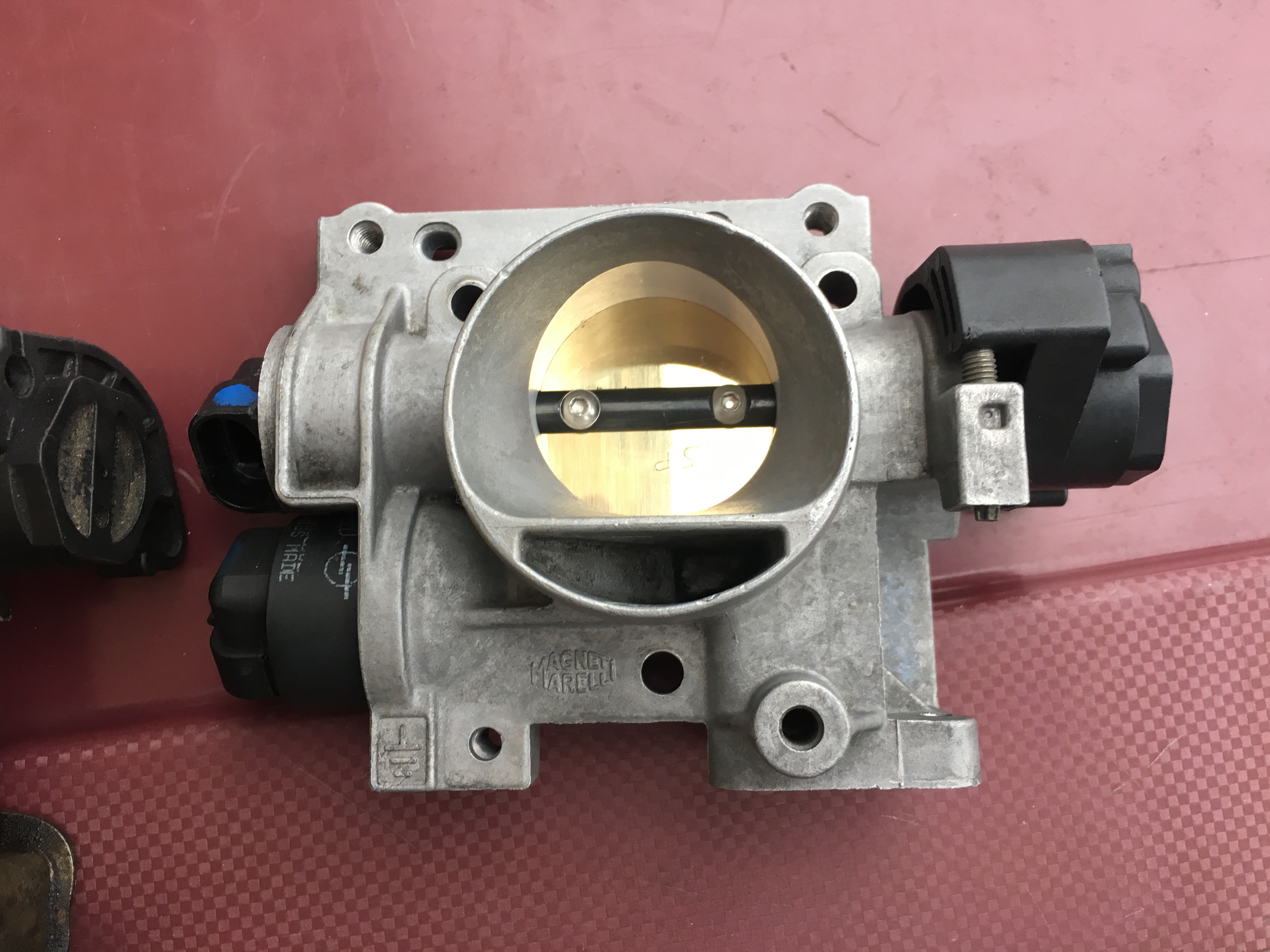

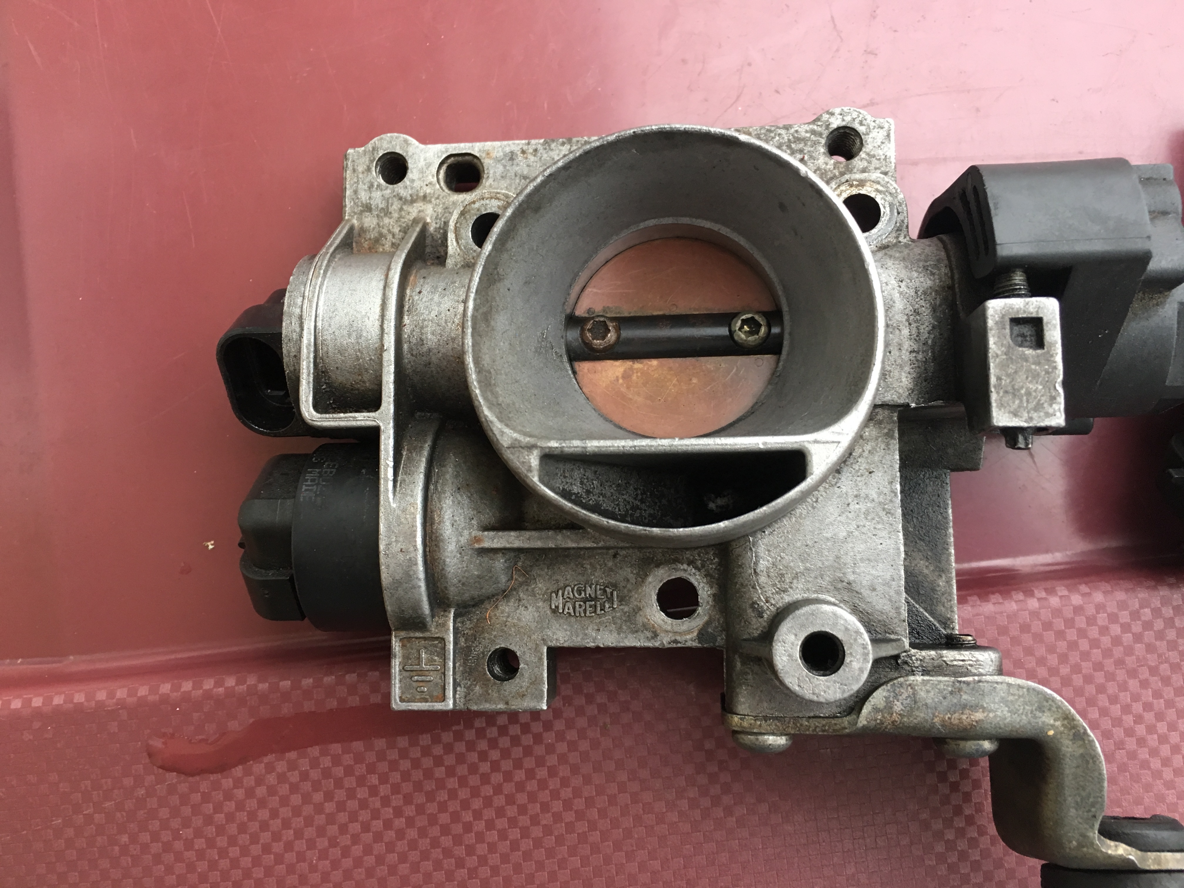

Well got the TB from Sparky... wow what a nice bit of work indeed thanks Sparky..... fitted it yesterday as been away fo a few weeks, It's more in every way, it's like adding another 200cc to the engine... it's really helped that top end power and it pulls now right upto the red line... First Track day at Three Sisters on Feb 3rd... so will report back

but... how will you be adding extra fuel for the extra air?
Just rely on the ecu self adaptive functions?

Saw Engine Masters, yes was a good but V8 6000cc engines move a lot of air... and filters do make a difference.... also yes the self adaptive ECU is doing the right maths so its puulling harder and better... it would be great to have a alloy inlet and say a 50mm throttle or as some have already stated run it on 600cc bike throttle bodies.... but I have to say my car is ok as it is for now, any more tuning work will be expensive and as it is it's cheap to fix.. engines are £100 etc.. so just put another in and fit all the go faster bits if i blow it up ....the other extreme is to fit a T-Jet enigine .... but will have some fun in it as it is and will look at either selling the car later this year or spending on a T-jet ...
