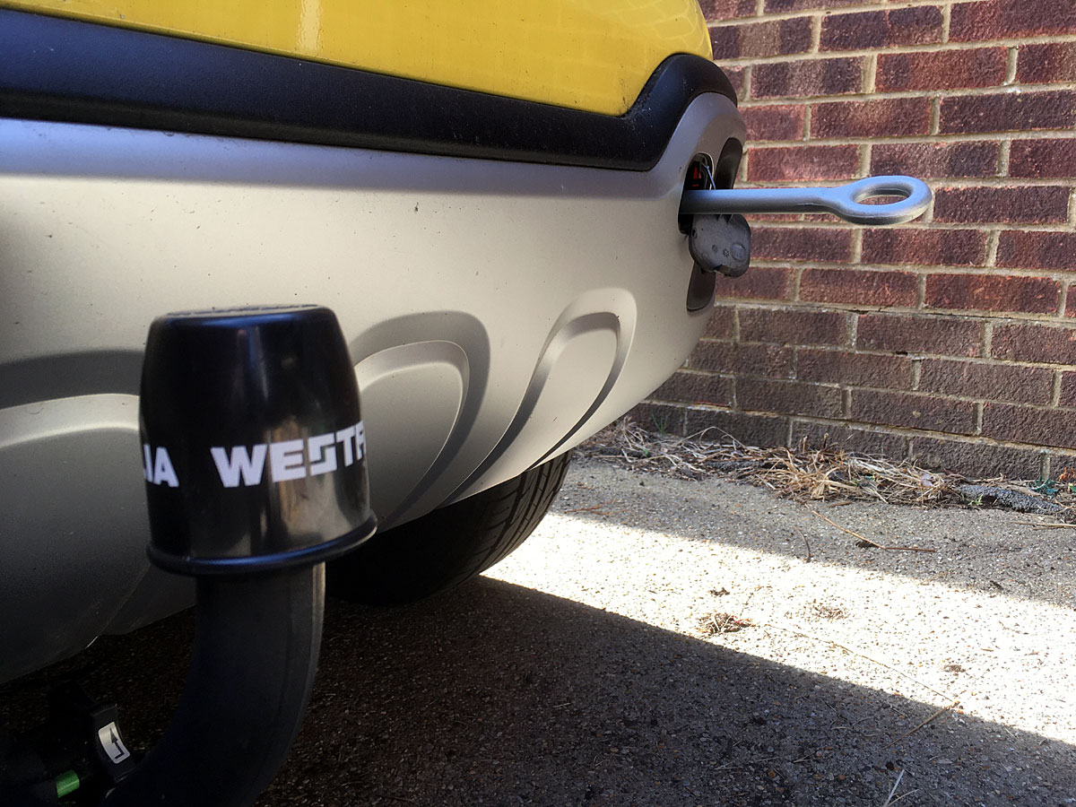

Hi folks - especially anyone who has fitted a Panda towbar.
Those who've been here a while will have seen me comment that I will (one day!) add a towbar to my 4x4 Panda. But, looking back to a post by @SaltyBill from back in April has prompted me to ask this question...
In the photo in Salty's post, here https://www.fiatforum.com/threads/wesfalia-tow-bar-hook-installed-help-with-bypass-bosch-pdc.493554/ (from which a small part repeated below) you can see a short section of tube that's welded to the right hand towbar support bracket. Clearly, that is a threaded tube which the emergency towing eye screws into (nice touch).
You could say 'you don't need the emergency towing eye if you have a towbar fitted'...
True, except if you don't have the detachable towball with you and need pulling out from somewhere (or need to pull someone else out from somewhere), you will need to use the screw-in eye. Cut to the chase: do other makes of towbar also include this threaded tube that Westfalia clearly do?

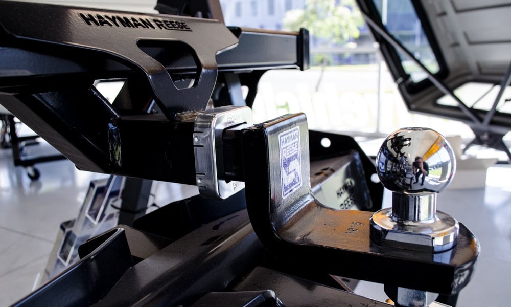

In Australia we will never pull someone out attached to the towball. it is not strong enough, and it could break and fly into the drivers window. And kill the occupants, we have numerous stories of people being killed by a flying towball. Always use the tow Hook.
And our tow balls/ bars in australia are built much stronger than in europe.

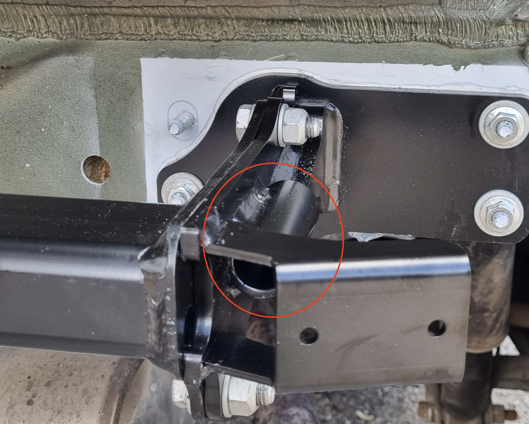

Interesting thoughts.

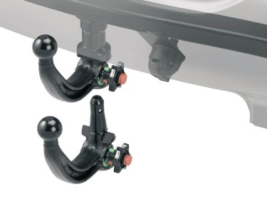

More interesting though is, looking at towbars from various makes available to me in the UK, only Westfalia include the threaded tube for the emergency towing eye to still be used. Without a towbar fitted, that emergency towing eye screws into a threaded hole in the crash beam behind the bumper -- but that gets removed and replaced by the towbar beam and so (except for a Westfalia towbar) the ability to use that emergency eye is lost when other makes of 'bar are fitted.
if your serious about offroading, and possibly see yourself being pulled out one day , looks like you only have one option. The safest!

Maybe i didnt make myself clear, I am only talking about recovering a stuck vehicle. Not towing a caravan or trailer. I thought that was obvious.
A stuck vehicle in Australia , lets say in mud, a river or deep soft sand, Should never be recovered by another vehicle with the strap attached to the towball... EVER! ( we make dedicated hooks with heavy duty pins, which connect to the shaft the towball connect to, we also use the OEM recovery points./
this is the case i would assume around the world ( as a stuck vehicle, even a panda needs considerably more KN of force to be pulled free.
Just because your tow ball hasn't snapped off and taken out a driver doesn't mean it wont. So many deaths in Australia from people being struck by towballs being ripped off. Last i can remember was this year, a mother was hit in the throat , died from the towball flying through the window.
They do not manufacture Tow balls to withstand that kind of force. i am certain westfalia would have it written somewhere that recovery from the tow ball is prohibited.
If you need to recover a vehicle you must use the TOW HOOK. Tow balls are for towing trailers. not pulling vehicles out of the mud ,etc.
Just because it hasn't broken yet wont mean it never will. Stop doing it.
PS; if you have ever seen an Aussie towbar and ball. You will realise that what you have in the EU, are toothpicks in comparison. Toothpicks.
EU vs Aussie tow bar, no comparison. !
Well, no comparison, yes and no :) .
I agree with you completely, that a tow bar is designed to tow a trailer and therefore even a braked trailer has an all-up weight limit that still only gets equates to smaller cars but we do tow car trailers with cars on...
The Aus Reese tow bar you show are the same as those I encountered in Houston Tx. and are the standard in N America I believe. They come in two sizes and are removable via the 2" or smaller option 1 1/2" (or thereabouts) box section to which the ball is attached (in the US there are two different tow ball sizes too I believe). This box section is attached to the vehicle via a steel pin which I'm guessing is really the weakest link and would fail in shear. A snatched load from a chain or strop will almost certainly exceed the tow bar rating whichever continent you are on when recovering a vehicle and then present the risk of injury described.

Woo! This isn't something I had considered when I selected a Westfalia towbar, which someone else fitted for me. I then had someone 'point out' that I'd lost the use of the towing eye because the crash bar was removed. Now I just went and checked and, sure enough, I have both :cool:

Yup - I think Westfalia are the only brand that include the threaded tube - and so that is what I shall be fitting to mine. Also seems to be the only one that has 'wings' on the end to add support nearer to the bumper's corners. Like most things - you get what you pay for, I guess.
