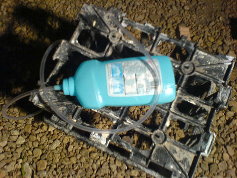

Check and fill gearbox oil...
12mm Key, EP80 gearbox oil and one of these:
N.B this was the Beta version the next version worked much better with larger diameter hose :D
