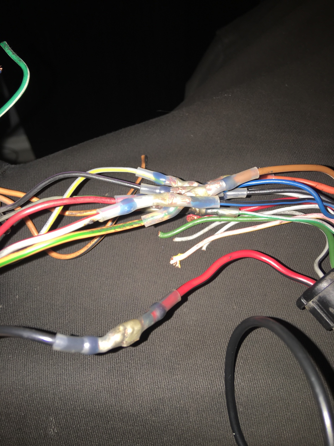

I have made the connections and just want to check that both of the blue white cables on the Cinq side are not needed along with orange blue and orange black also black white.
On the Punto side I’m left with green. Pink orange and black grey also red.
Are these also not needed. ?
Then red black will extend to the connection under the battery tray.
Is this right? Thanks

Sounds about right don’t know how well you can see the left over wiring on mine the only thing I’m yet to sort out is the wiring for the reverse light switch as it runs through the engine loom on the Cinq and doesn’t on the punto loom
Thanks again for your help. What colour is the reverse light switch on the Cinq loom? And where does it need to go to?
And as for the red black to the battery tray connector just cut the plug and extend red black from there to d4 and solder it.
