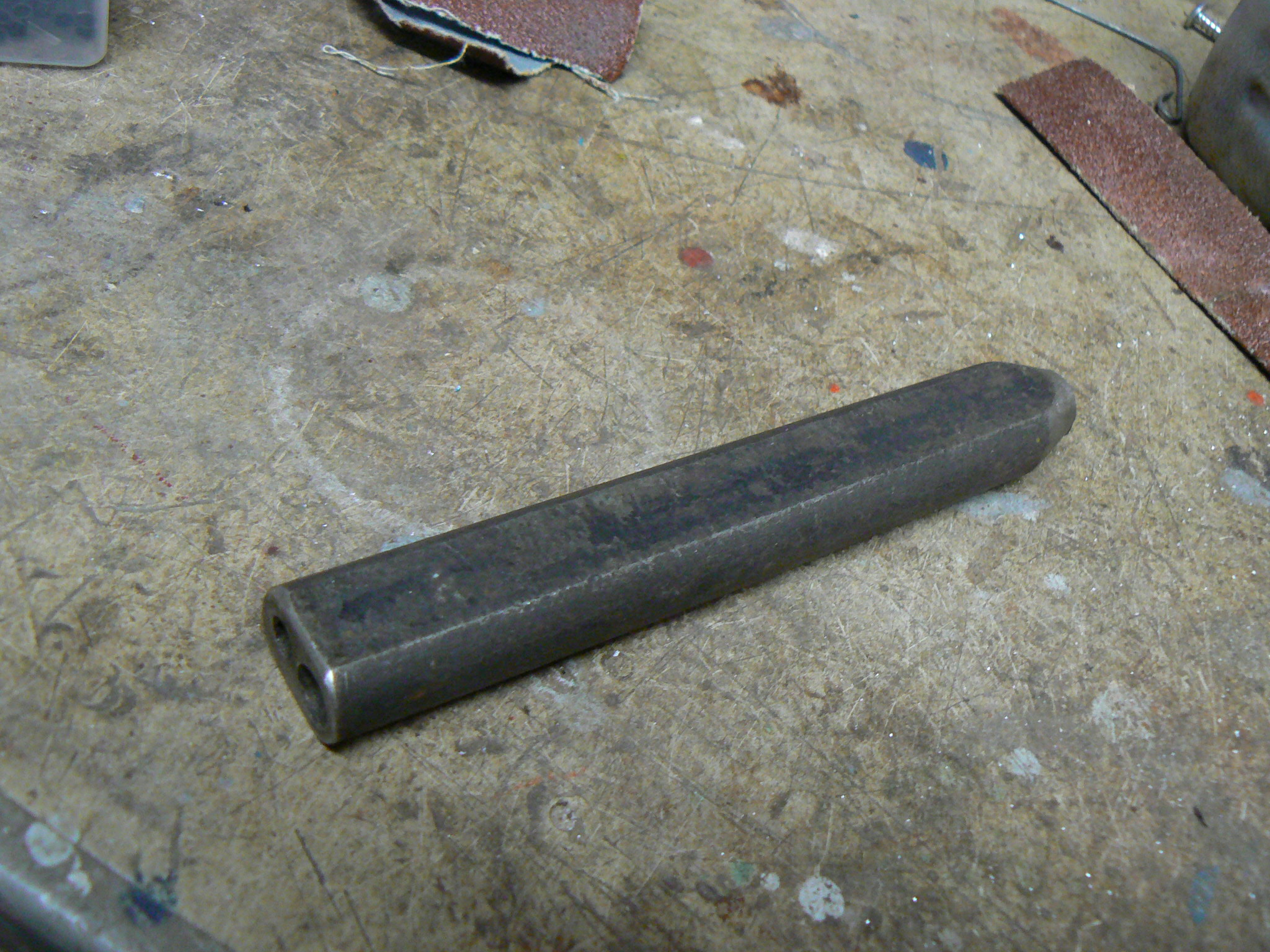

Yup, knew it was there somewhere. Not in the brake tools drawer though it was in with the punches - logical I suppose? Anyway here it is in all it's glory:

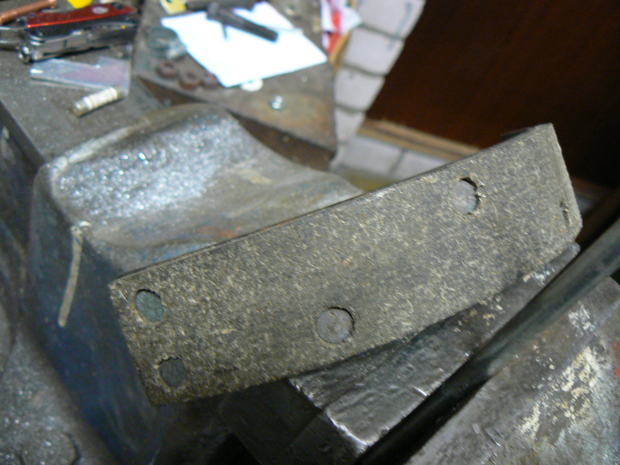

And now, for the younger members among us, before modern adhesives were developed the linings on brake shoes were all riveted on. Here's a spare I bought at an autojumble many years ago for my Daf. For those in the "know" yes it's the same as a mini!
You can clearly see the rivet heads.

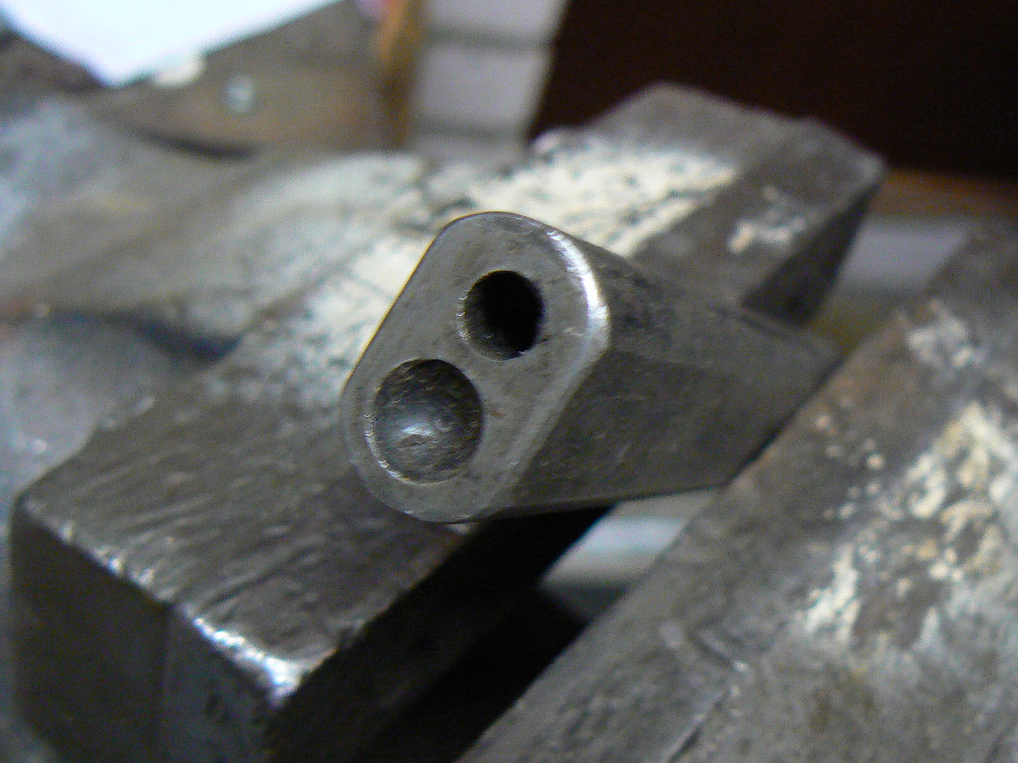

If we now look at the business end you will see there is a "hole" and a dome shaped punch:
The rivet would be inserted from the lining side and the "hole" positioned over the shank which was now projecting out of the rear of the shoe. The entire shoe/lining/rivet assembly was then positioned over a plain punch held in a vice so that the head of the rivet was supported on the punch held in the vice. the "hole" in the punch was then placed over the shaft of the rivet sticking out through the shoe and a couple of light taps with a hammer would seat the lining and it's rivet nicely against the shoe. Holding everything steady the punch would then be repositioned with the domed end over the rivet and a few sharp taps with a hammer would form the rivet (often made of copper) into a domed head thus securing the lining in place. Then it would be on to the next one (10 on a Mini shoe but, as you can see here, the lining manufacturers would often miss out every second of the middle rivets so you ended up actually doing 7).

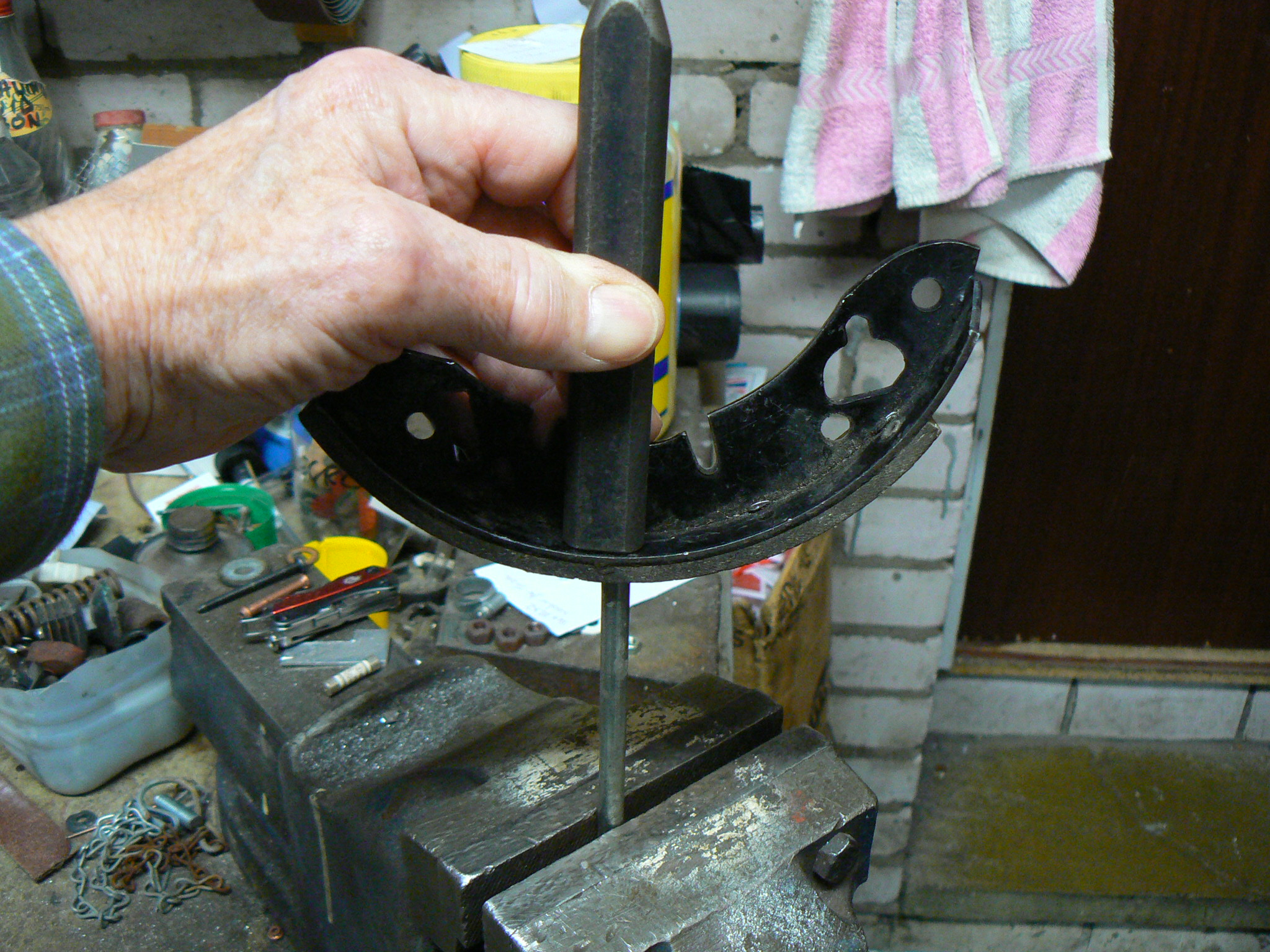

Here's a pic of how it would look in operation:
I used to have another design which was for use with hollow rivets. Instead of a domed punch it had a "peaked" design which spread the end rather than rounding it. It's obviously found a much better place to hide!

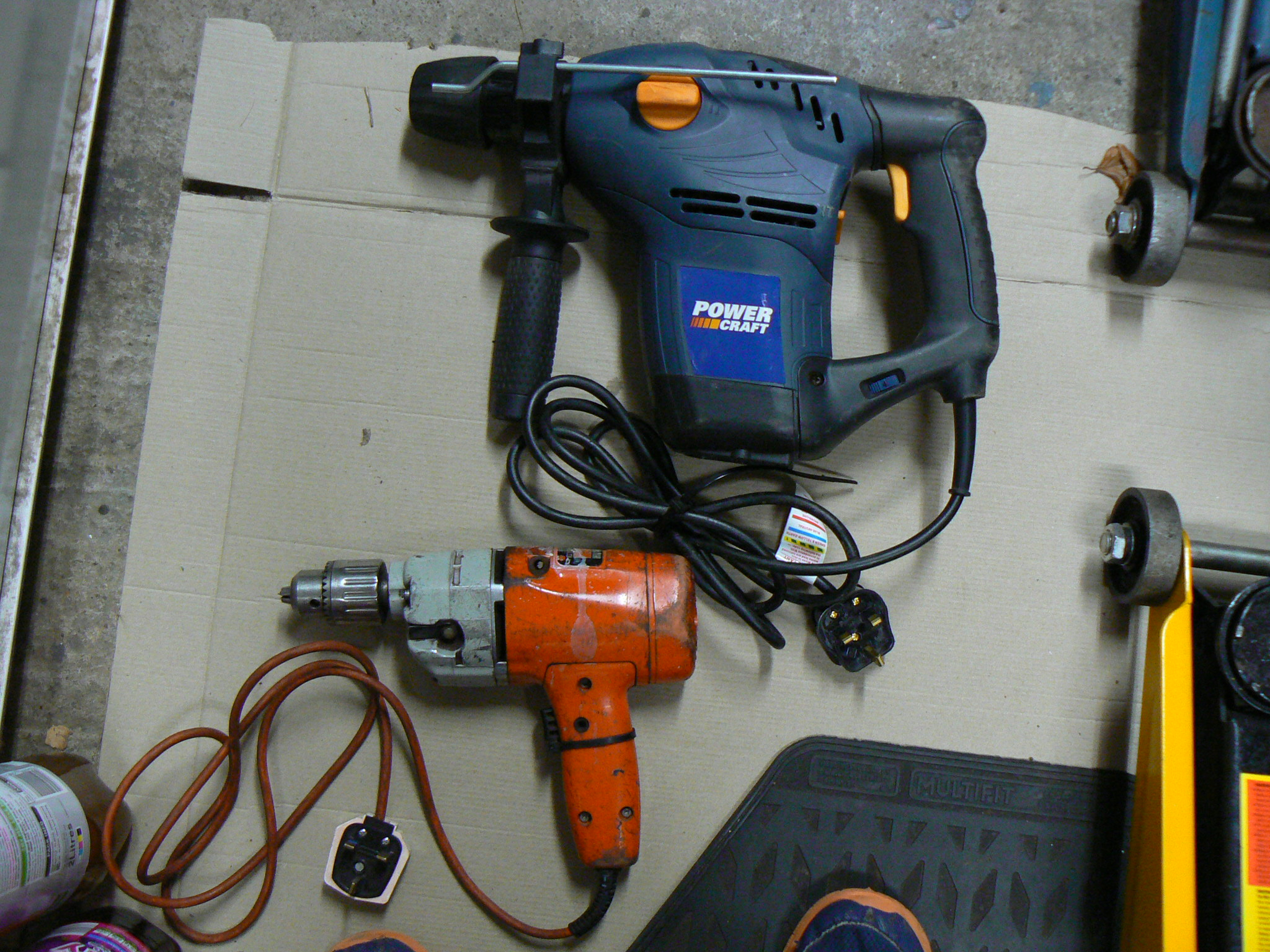

Mrs Jock is watching a dire program about some woman who collects stuff from council tips and, after altering,reconditioning,painting and generally titivating them sells them on to people with too much money for "silly" prices. It's annoying me so much I decided to go and try using the SDS as suggested above.
I bought this drill to do building projects. It was used extensively when we took my boy's first flat back to bare walls. Then there was the garage project with driveway gates at my daughter's in Salisbury, and others. It was a Lidl (or was it Aldi, maybe?) cheapie and I thought it might do less than half of what it has. Still going well but it's a heavy old beast! Here it is compared to my trusty old Black and Decker (which is also, surprisingly, still going strong - just a set of brushes a chuck and a strip and regrease in all the years I've had it:
I haven't used it (the SDS) in about 18 months and as soon as I took it out of it's case to photograph it I realized it just wasn't going to be suitable for the sort of thing (loosening bleed nipples etc) we're considering here. Made a good job of cleaning it after the last time I used it though didn't I? A rag dampened with WD40 puts a lovely finish on things like this if you know you're not going to be using it again for a wee while.

Your SDS does look a bit of an animal. Clearly OTT for jobs like this as is mine TBH.
Yes it can be. You have to be very wary when drilling deep holes and clear the drilling debris frequently by running the drill in and out of the hole. If it locks up in the hole the only safe thing to do is let go of it or it'll likely break bones!

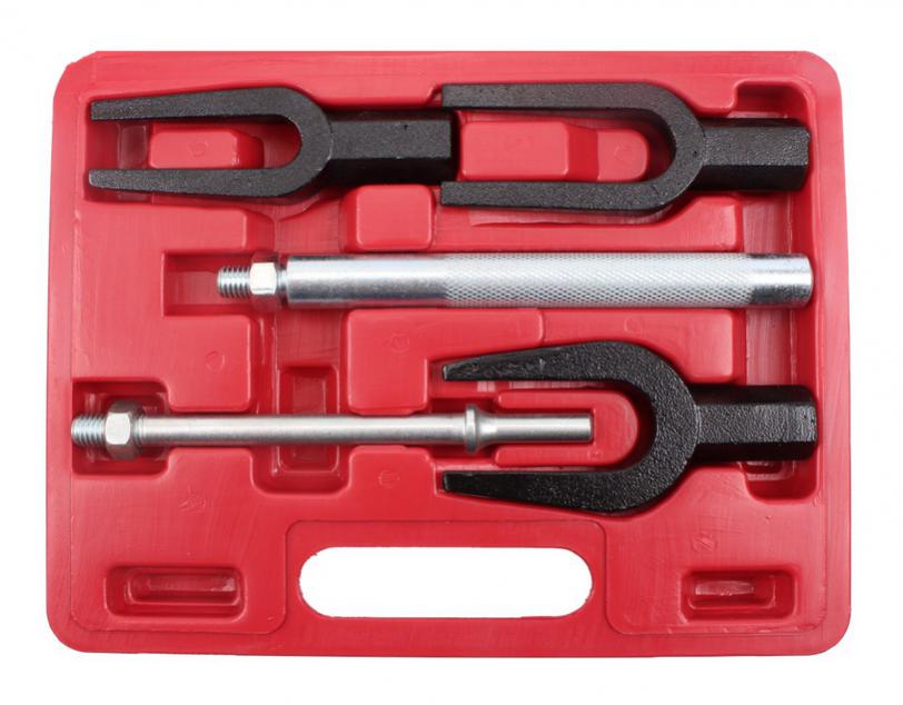

I ordered this one for ball joint remover kit.
I wonder if it would work OK for the Panda cars.
