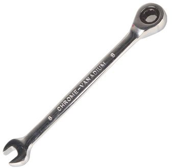

One thing I have found useful is a ratchet spanner for those times when there's a nut on a long thread and limited space:

I know what you mean about cheap spanners but saying that I have a 10mm Halfords which looks the dog's bits but it's too thin and the edge feels quite "sharp" even at the forces needed for an M6 screw.
My favourites still are those old Kamasa spanners which have not bee made ever since the original company packed up in the early 1980s.
I also have a some Aldi ratchet ring/open spanners (10, 11, 13, 15, 17) given as a gift. They must be rubbish - right? Actually, they are nicer to use than that posh jobbie. Ive added a 12 and 14 to the range from Halfords.
Why does that supplier get so much use from me? They sell individual spanners. I have more than enough sets.

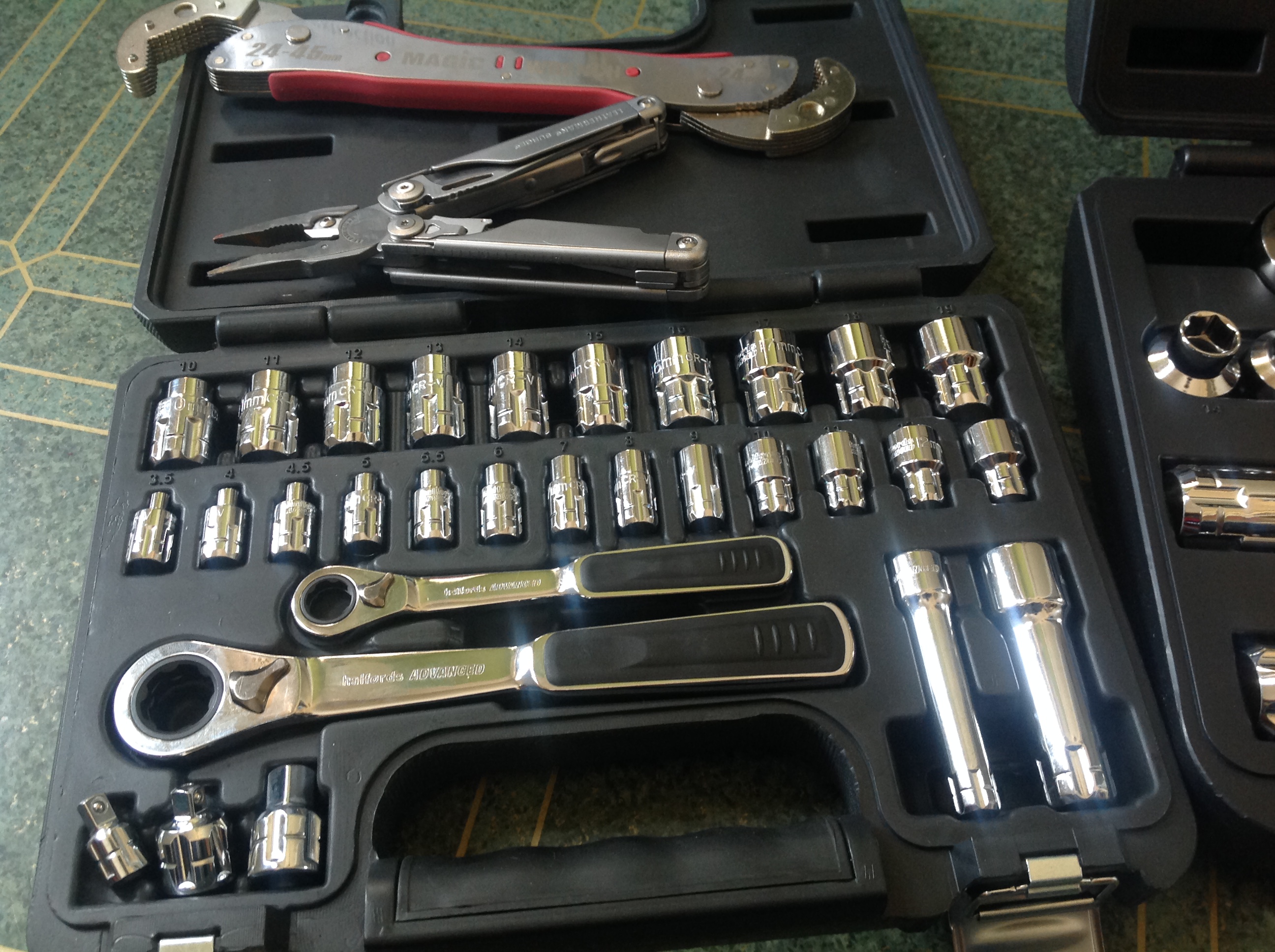

Picked up the Halfords Go-Thru Socket sets. They are really fantastic tools. Well made, and look very useful.
The sockets are all 6 points stuff, and there are extension bits, and really cover all sizes. Hardcase is nice too.
Works just like normal sockets too, but with added versatility of pass thru capability.

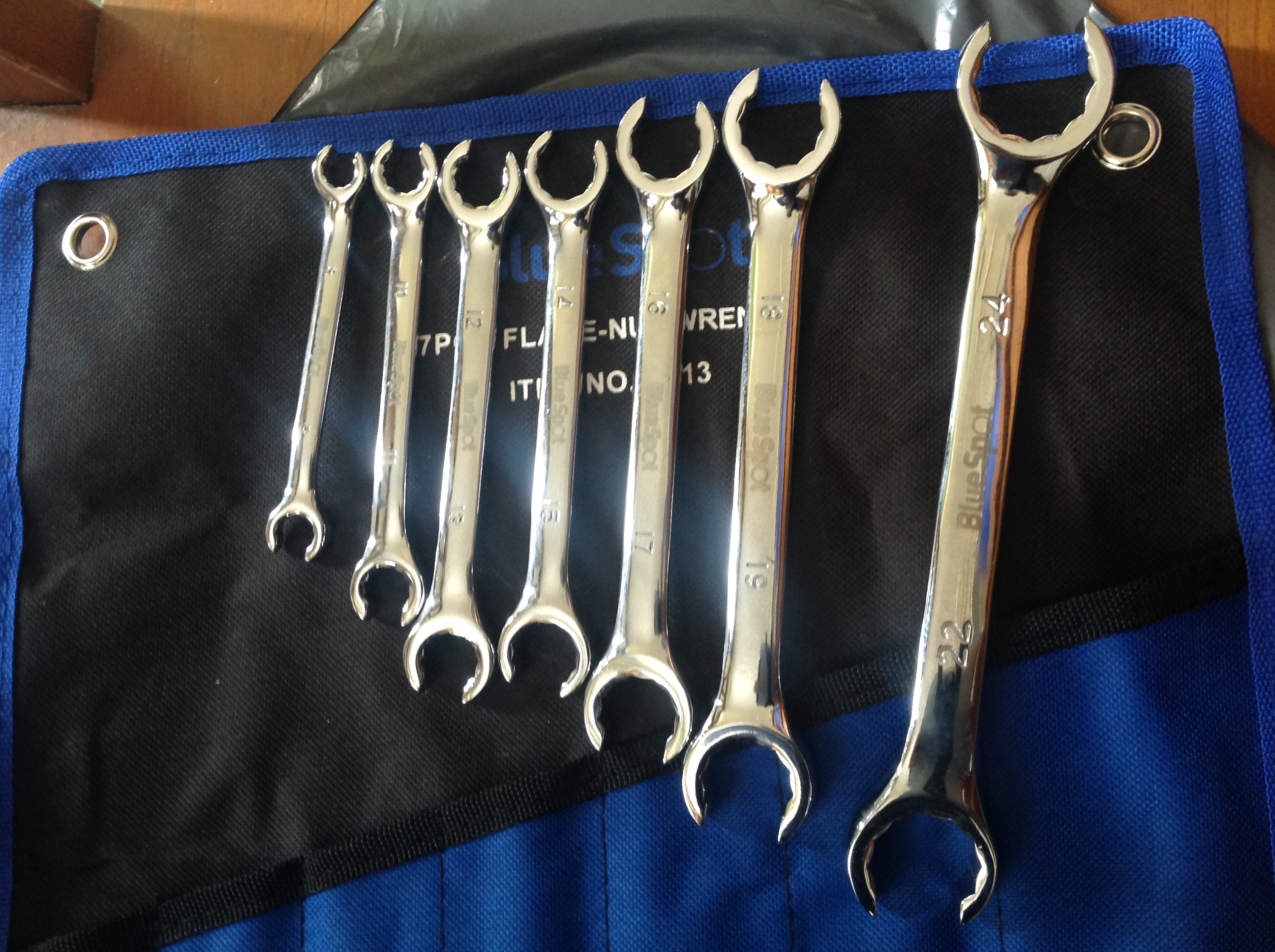

Got this Flare Nut spanner set for 11£. So these are the proper tools for working on brakes then? I m just keep collecting tools to work on my Panda. :)

I have the imperial equivalent of 11mm. I'd have to dig around in garage to tell exactly what size it is but it works fine on older cars and fits snugly on Fiat 11mm AF flare nuts. I've never needed any other sizes though I suspect a Citroen DS/BX/CX owner would need a full set.
The most important feature is a thick base around the spanner sides so they can't spread apart in use. A ring spanner with a piece chopped out would not do the job.

The extended tips are to keep the nut tucked tight into the spanner to minimise leverage that spreads the jaws. But they will spread if really abused so need to be well buttressed.
Personally I would just get a really good quality 10/11mm and perhaps a 3/8" x 7/16" if you ever get that classic Mini or MG Midget.
At that price they're worth having in your tool kit. As Dave says, at that price if one breaks then you aren't going to be too upset! Personally I would have gone for single hex (6 point). The big problem with tube nuts is that they are often seized/corroded and take a lot of effort to undo. Bi hex (12 point), especially on smaller sizes, tend to round off the nuts really easily. The other big problem is that, being of an open ended design, the jaws tend to spread which just increases the chances of rounding off the nuts! The trouble with "cheap" spanners is often that the metal is of poor quality, the forming process poorly controlled and the design inadequate. The examples you link to look not too bad but, whilst I would want to see the jaws well buttressed, the smaller sizes look just a bit too bulky and I can imagine might give problems of access in some situations.

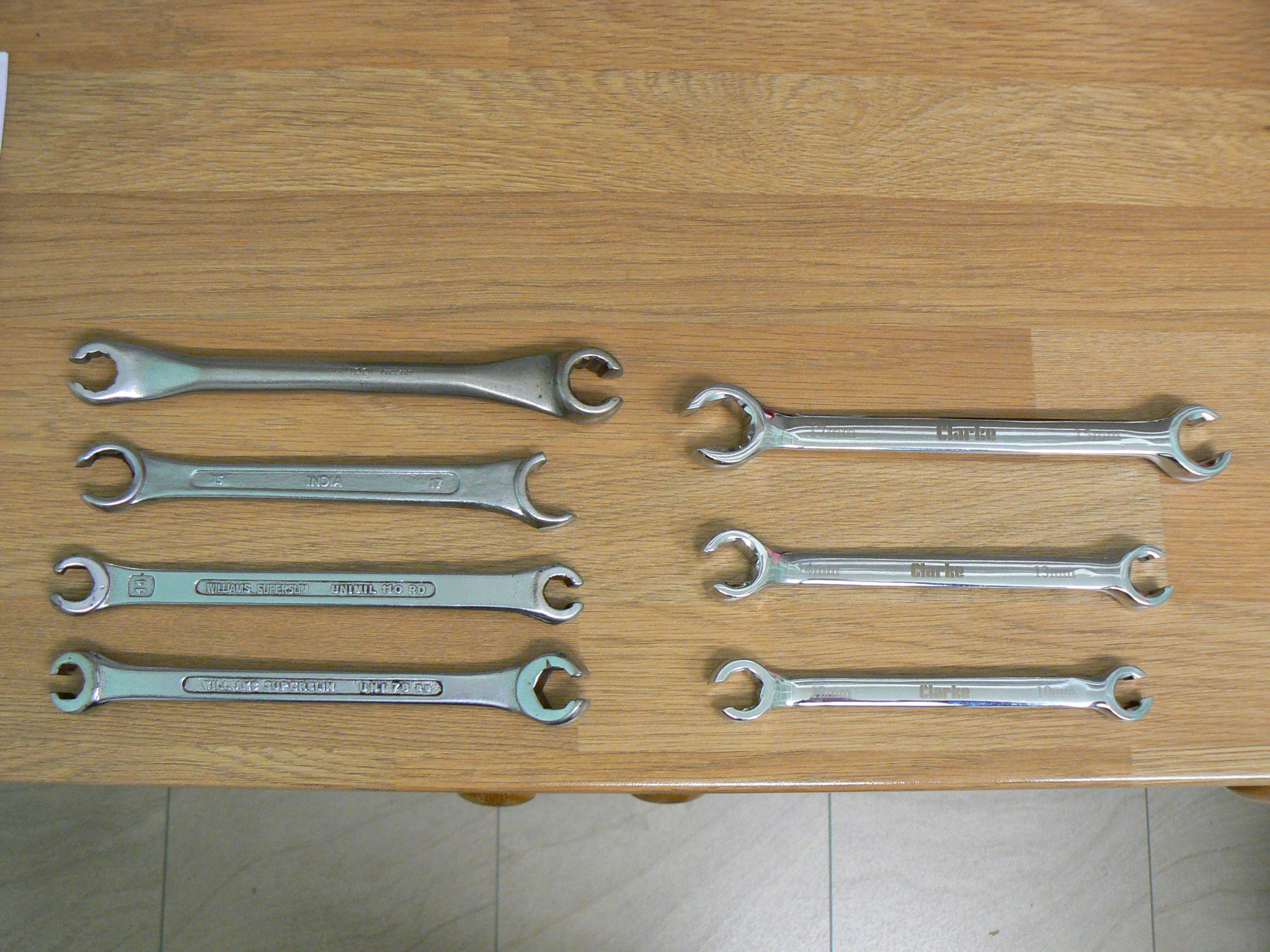

Here's my wee collection:
The ones on the left are my "old pals":

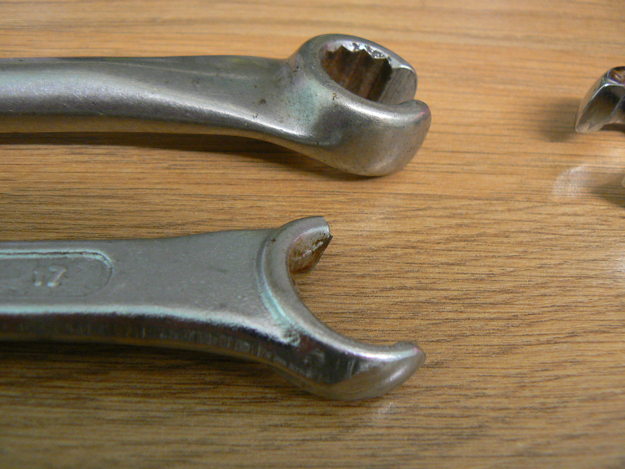

At the top is an imperial size bihex (12 point) Britool. I had a set of 3 of these back in the day when cars like the Morris Minor were our bread and butter. Then the Marina, Allegro, Princess etc came on the scene and, Yikes, metric fittings started appearing! The Allegro was often good fun with imperial fittings on the front calipers and metric on the rear (or was it t'other way round? - see, I'm still confused!) I bought a set of Williams Superslim to get over this. The bottom two are the ones which have survived - and I still use. The spanner second from top is a "cheapie" I bought (I think to do Hydrolastic pipes if I remember?) As you can see It's broken

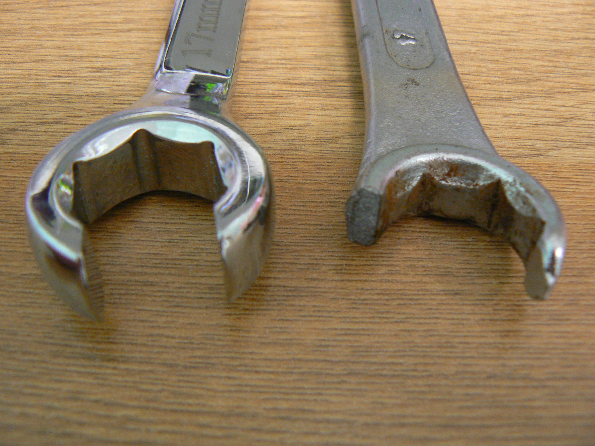

Didn't survive it's first encounter, due to being just really poor quality. Look at The difference compared to the Britool in the picture above and how poorly the driving faces are formed and how little actual metal there is compared to the Clarke in the next picture:
Going back to the first picture the three on the right are a Clarke set I bought from Machine Mart because I lost my Williams 13mm (Sob, sob).
Generally modern male tube nuts need an 11mm tool and females take a 13mm. I was surprised to find the Clarke set didn't have an 11mm? But as both of the Williams have 11mm ends, I needed the 13mm and there were other sizes I didn't have which might be useful on diesel injectors, I decided to buy anyway.
Thinking about quality and design. Quality of material is difficult to asses but very cheap tools are probably cheap for a reason? design is something you can see with your eyes. Look for a tool with a bit of "meat" on it but not so bulky that it's going to make access awkward:
The Britool (top left) Clarke (top right) and Williams (bottom right) Whilst being different in some respects, are all well made. The cheap unbranded tool (bottom left) proved to be brittle - it snapped almost as soon as I started to "lean" on it. It was "thin" and, if you look closely, the driving faces are very poorly formed. I wasted my money!
Having said all this though, there are going to be times when a spanner like this is just not going to get the job done! It's very likely that in this sort of situation, cutting the pipe off at the nut and using a hex (6 point) socket will be a better bet. Of course you'll then be into making a new pipe - but sometimes that's just the way it goes?
Yes, the BritTool one seem really well built, and it seems proved with its performance and length of life it is lasting, when other tools break during use.
I got my cheap flare nut set due its low price, but also number of people who bought them. It was well over 1000 sets were sold, while other sets were sold in meager amount.
I thought well, if it sells over 1000s, and no many bad reviews, then it must be OK. When it arrived it seems OK, in that it covers wide range of size, and feel solid.
But as you say, it was £11.98 for the set, so if it breaks, I wouldn't feel bad about it. Just will buy another set.

Just found out, that my flare nut spanner set comes with LIFE time warranty, and over 1880 of them have been sold, not just 1000. I think everyday 10s of them seem being sold :hm:
So if any of it breaks, then maybe they will replace with a new set? :cool::idea::)
