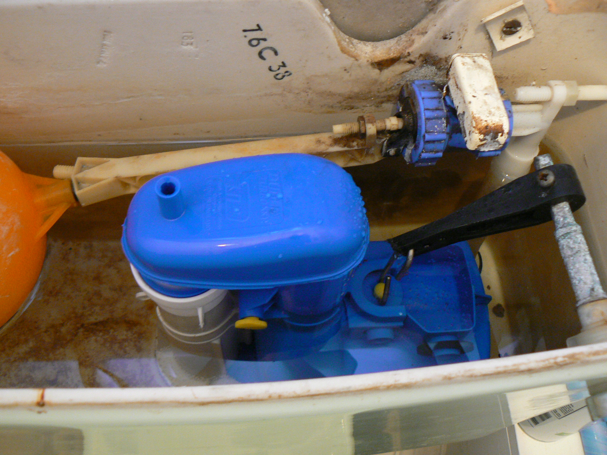

What I didn't know was that he was going to fit a Dudley 88 Duo Flush to rectify the problem. At first sight it looks just like any other syphon unit: https://www.screwfix.com/p/thomas-dudley-ltd-turbo-88-duo-flush-9-siphon-205mm/8461f and indeed to fit it the old unit:
has to be removed and the Dudley unit fitted in it's place. The difference comes if you ever need to renew a diaphragm valve in the future because the new Dudley unit's syphon - the blue bit - can be split away from the delivery pipe - the white bit -and removed from the cistern simply by removing the yellow securing plug:

Here's the finished installation and you can just see the wee yellow plug that has to be levered out to allow the unit to be split.
