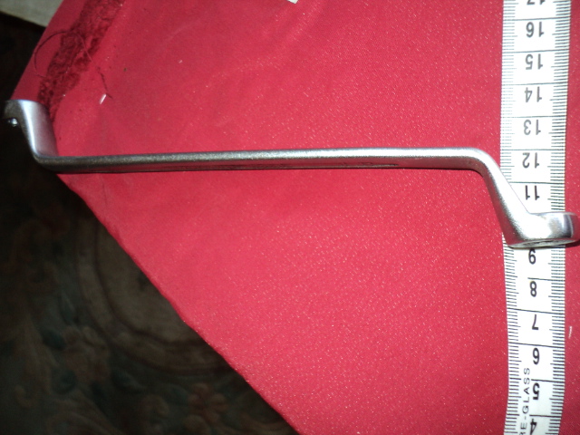

I found access to the bottom bolt easier by buying this (13mm) spanner.
