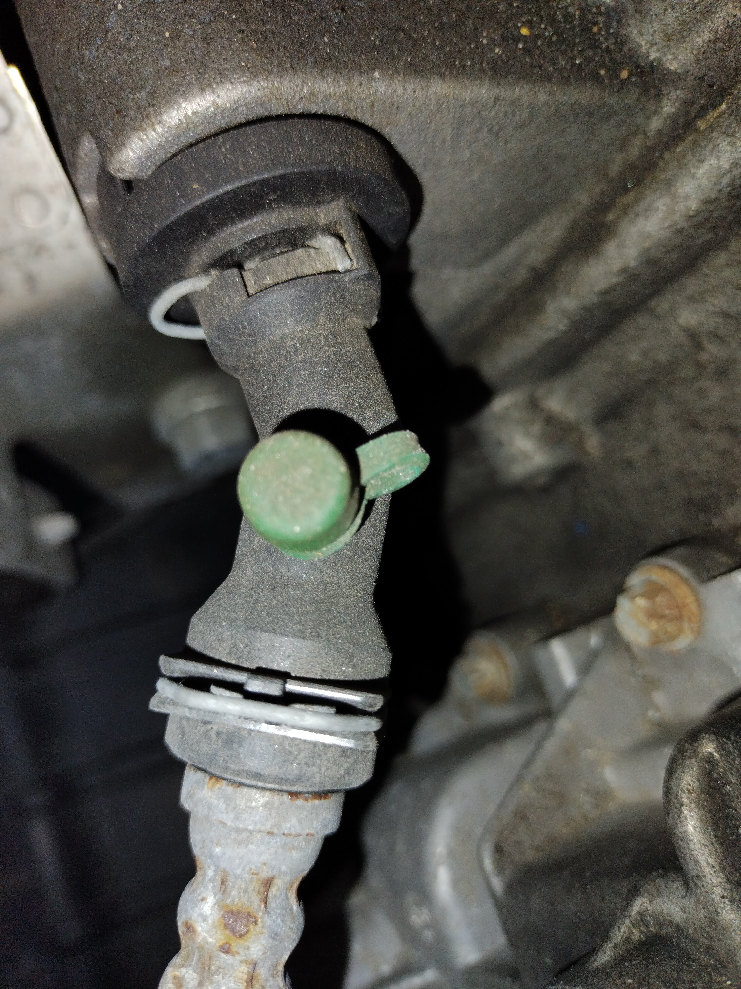

Is this the clutch slave cylinder nipple? (pictured)
Thank you.View attachment 443174

Thank you for your reply, could you please describe how to bleed the clutch slave cylinder, the bleeding nipple isn't a screw so how to get it opened?..actually is it necessary to flush/bleed the clutch slave cylinder if everything works ok?
There's normally a quarter turn nut under the bleed niple on the slave cylinder
All-through that dosnt look like there is anything? Remove the rubber cap and have a closer look
